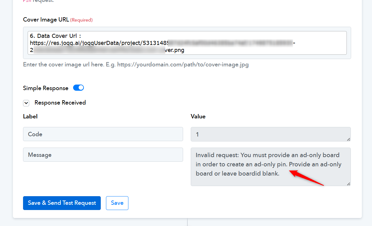

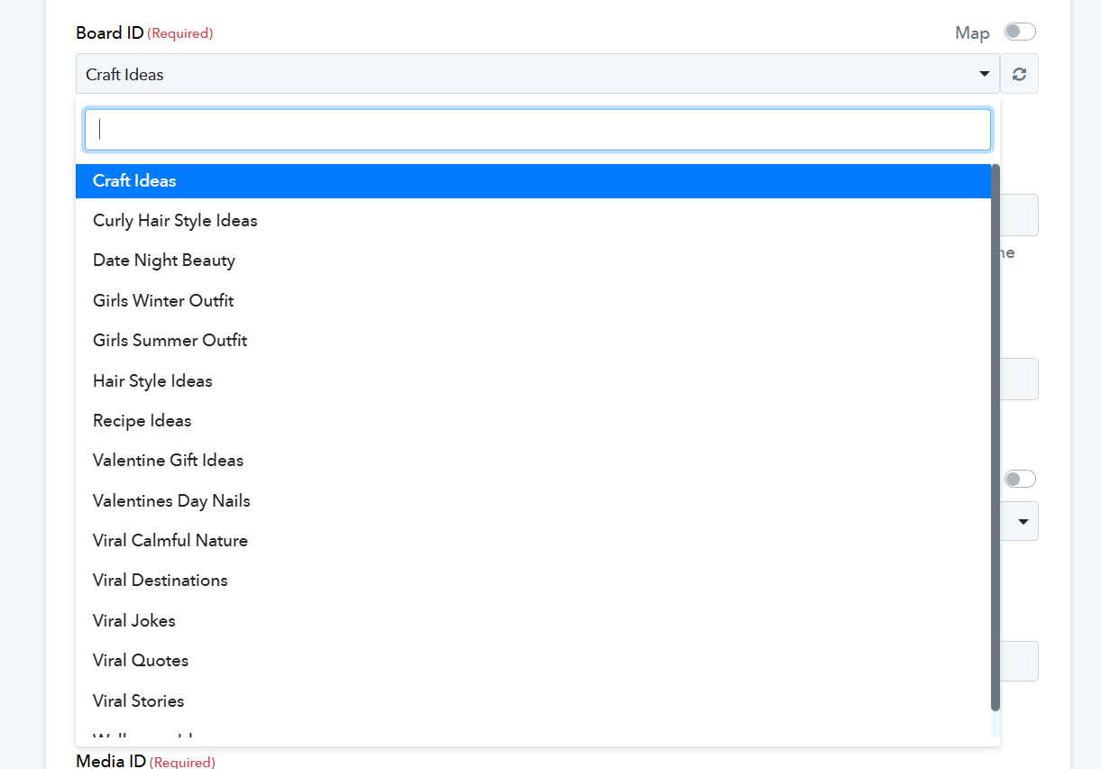

Could you please specify the board on which you want to create the video pin?
first one. curly hair style ideas.
Could you please specify what type of board it is?
hi please check this worflow url. i was able to create video pin only board.
https://connect.pabbly.com/workflow/mapping/IjU3NjYwNTZiMDYzMjA0Mzc1MjY0NTUzNDUxMzQi_pc
