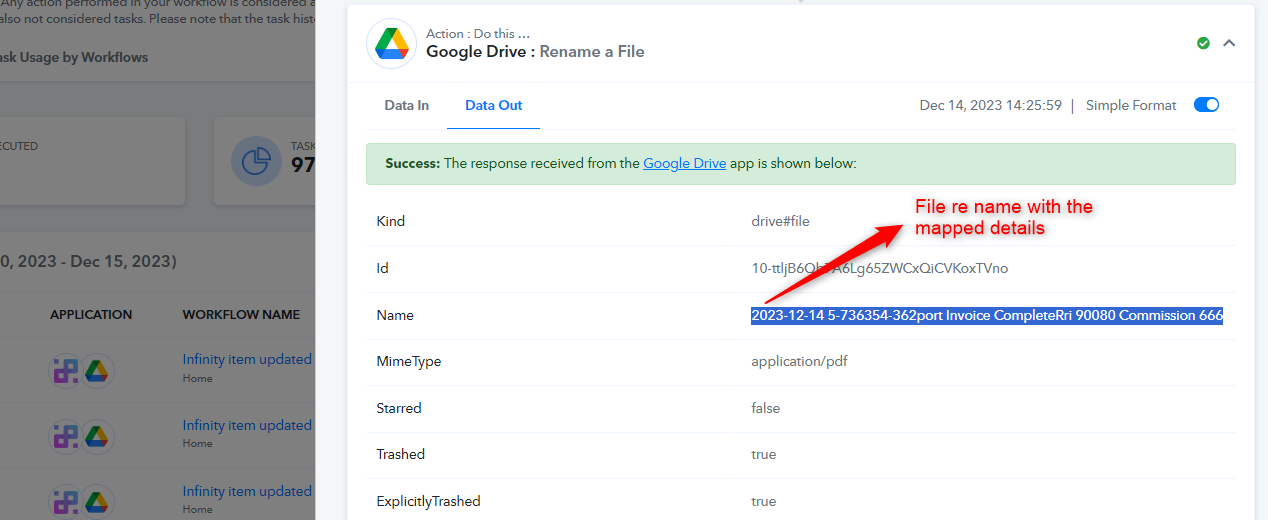

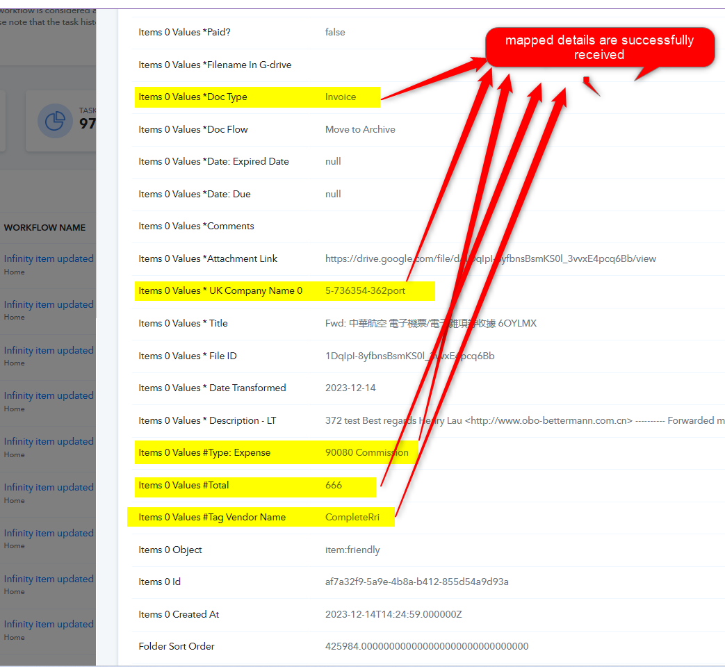

I have reviewed your workflow and observed that the response from Infinity has been successfully captured, and subsequent changes in attributes and file renaming have been executed.
In the "Google Drive: Rename a File" action step, you have mapped certain details, which are reflected below, and upon checking the task history, I confirm that the details you have mapped are successfully received, resulting in the successful change of the file name.

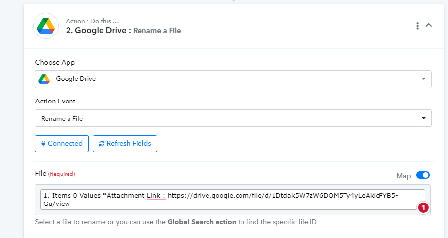

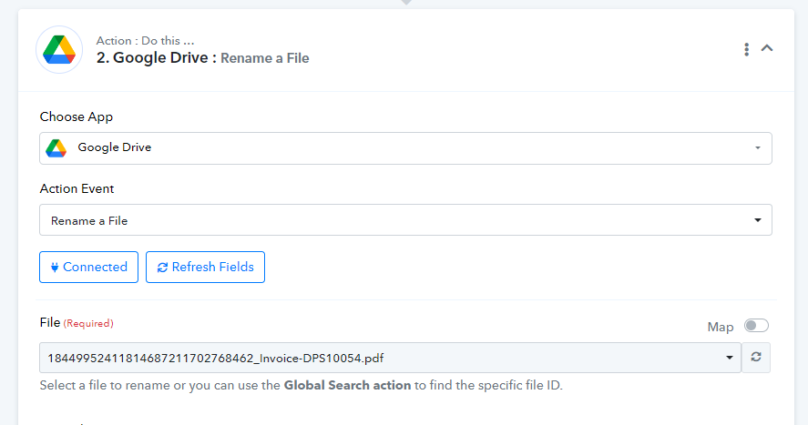

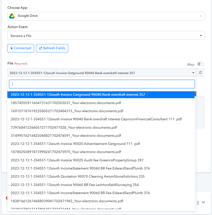

I have reviewed your video, and it appears that the reason the file name is not changing is that you've set the file field as static in the "Google Drive: Rename a File" action step.
To enable automatic file name changes, you should map the file dynamically in the file field. This way, when you receive a file from the Infinity trigger step, it will automatically proceed to the subsequent action step and change the file name accordingly. I have mapped the file dynamically; please check, perform a test response, and confirm if the file name is now changing.

I get your meaning. The file should be chosen a dyamic name from infinity but not static file name.
However, I cannot choose dyamic name from infinity. There is no choice there. Please check if your program work well?

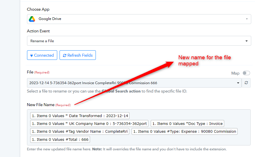

I notice that you have change to dyamic name.
I have prepare 3 files to be changed the name.However, none of these file success to be renamed.

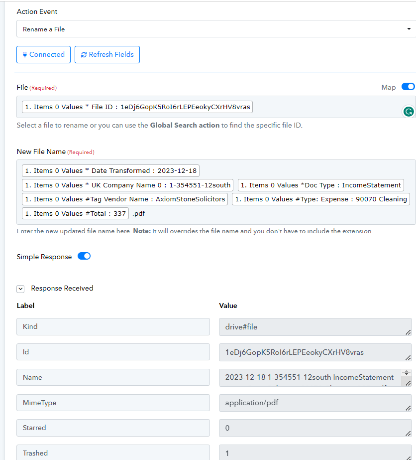

I have again made some changes to your workflow, and it is not working. please try again from your end and let me know if you're still facing the issue.
henrylau — Reply ·
Thank you for your effort.
The problem has been solved. I change the progress. I combine different label names in infinity, and import the combined name to google to renew name, rather than combine different lables name inside the google drive rename step.
