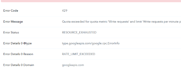

@Neeraj Currently pabbly connect's google sheet integration is not working properly and giving 429 error too many times even when we are not even close to the 1-minute quota limits.
We know that pabbly team thinks it is an issue from Google side and not from pabbly side.
But this makes using pabbly connect almost impossible for us. None of the other platforms like zapier or make are having these issues.
We don't know how you can solve it, but it needs to be solved immediately for making pabbly a reliable automation platform.
Hey @rob_moser
As we can see from your shown error, you have exhausted your rate limit to pass the request to write data per minute by "Google Sheets : Lookup Spreadsheet Rows".

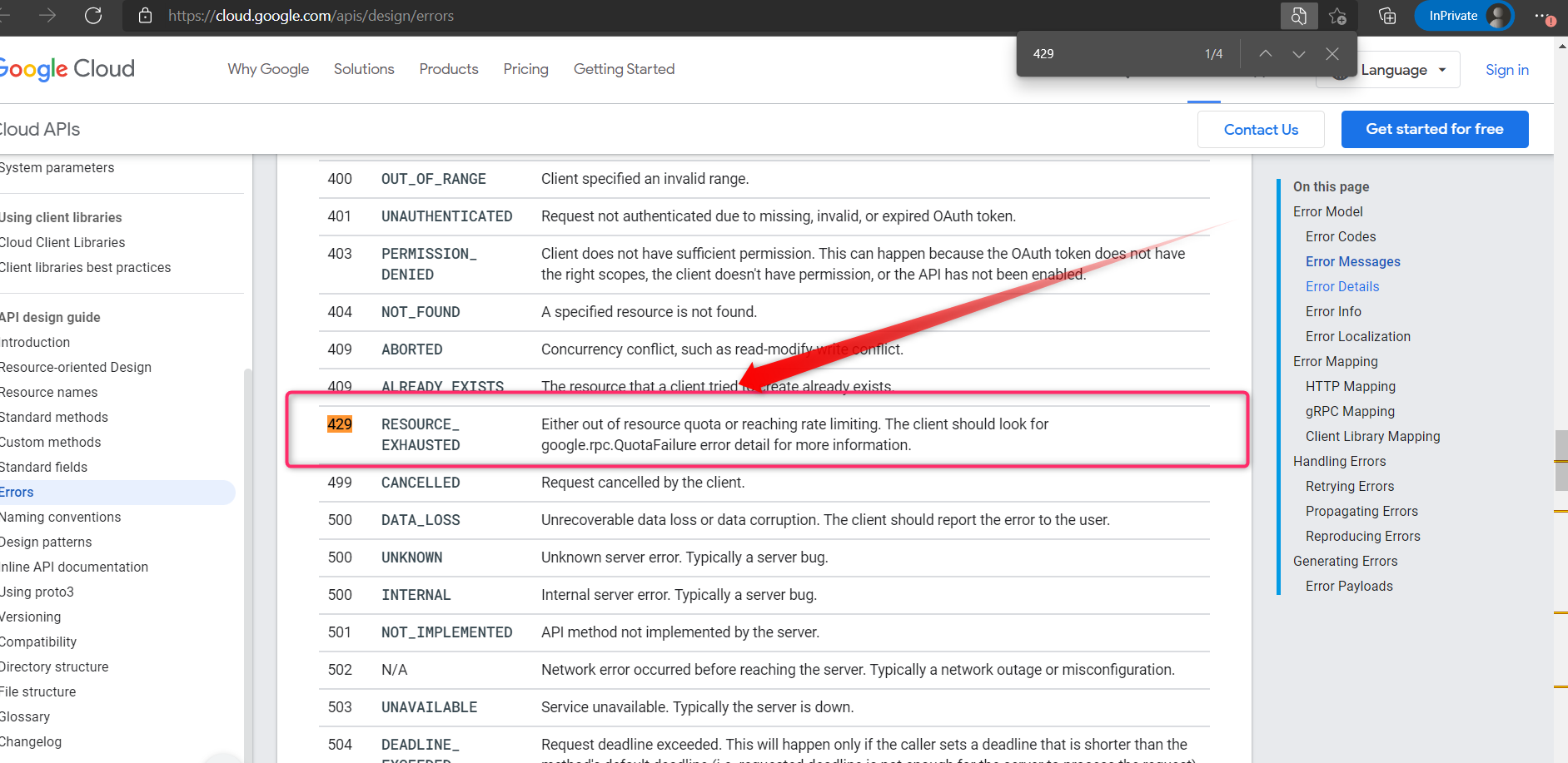

Google API documentation for the error which you have got.
cloud.google.com
Errors | Cloud APIs | Google Cloud
cloud.google.com cloud.google.com
Moreover, you are also running the tasks in bulk and because of that, the error has occurred by the Google API. So, we should suggest to use a delay action step to delay the task to run after 1 min after every update of value, in that way, you wouldn't be exhausting your rate limit.

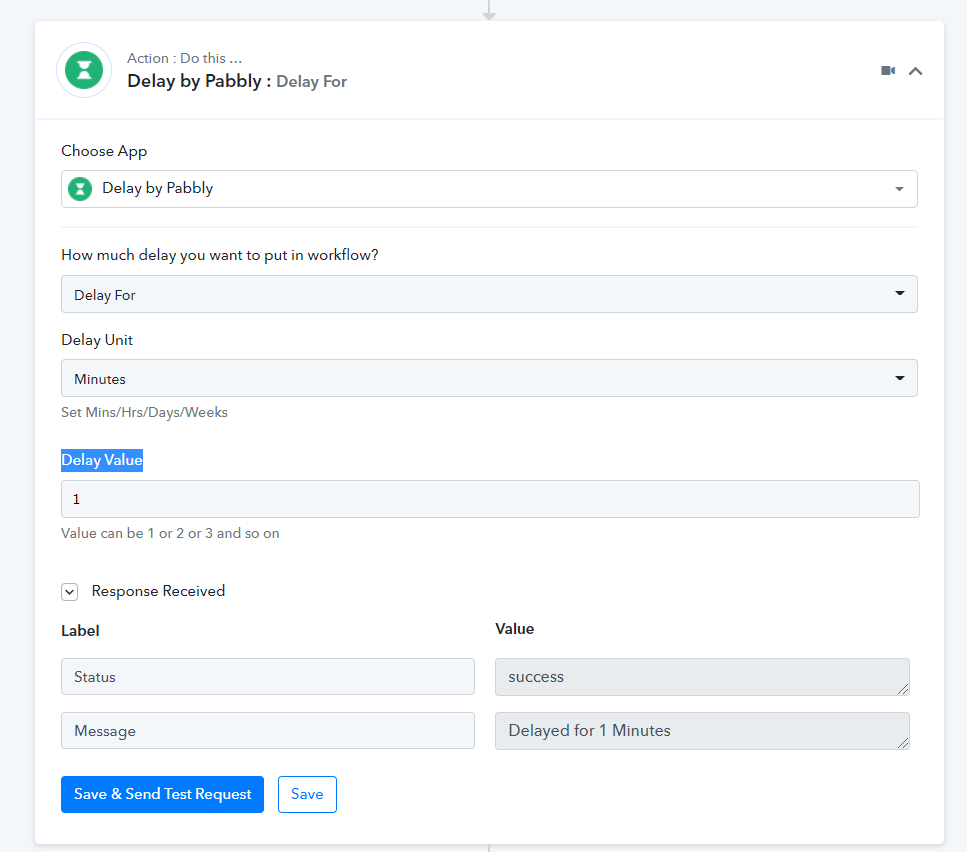

Please incorporate a Delay action step prior to the Google Sheets action step in order to extend the processing interval.
