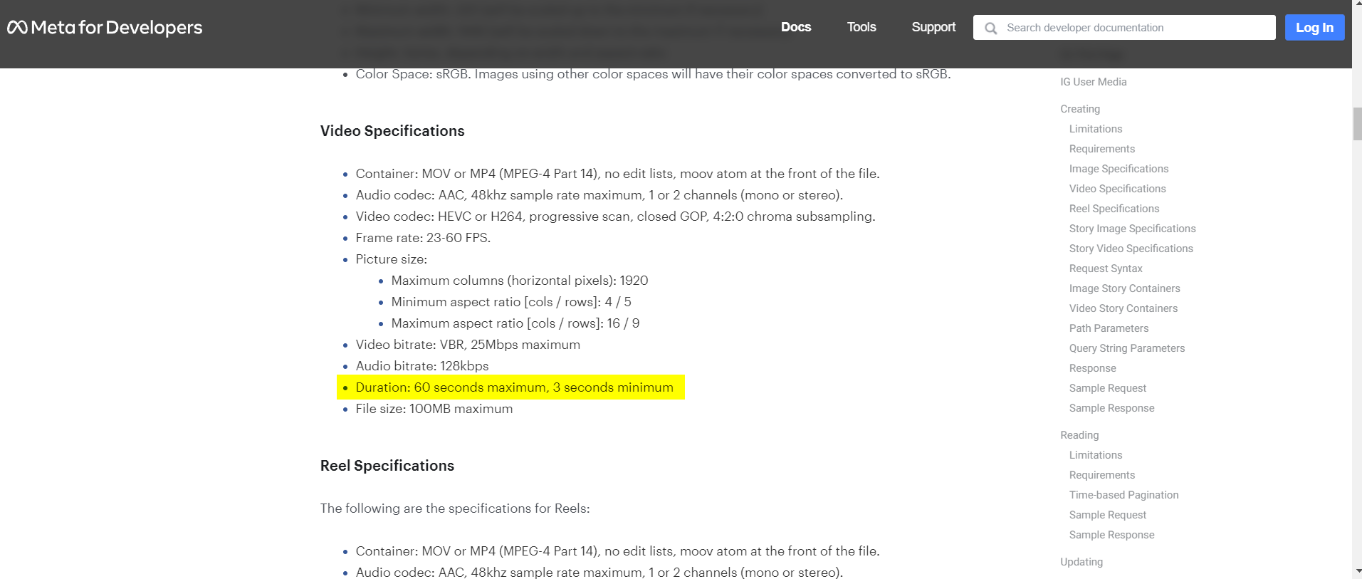

Please try to upload a video of less than 60 seconds and ensure that the video fulfills all the specified conditions given in the Instagram API documentation. The error is from Instagram's end, and we don't have any control over it.

Muzikala, the thing is that this error occurs for different reasons each time. For example, in your case, the problem appears to be connected to the video duration. The best we could do is share the Instagram API documentation so that users could get an idea of the issue with their specific video.
