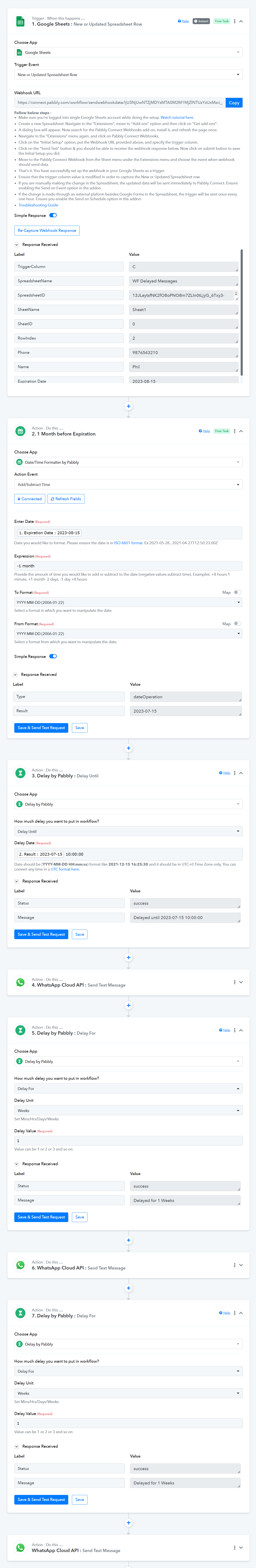

Hi @Mango,
For this use case, you will need to set up Google Sheets as your trigger application. Then, utilize the Date/Time Formatter's 'Add/Subtract Time' feature to retrieve dates, such as one month before the expiration date. After that, employ the 'Delay Until' feature in conjunction with the WhatsApp Cloud API action application to send the message at the specified time. Finally, use multiple 'Delay For' steps, along with the WhatsApp Cloud API, to send messages on a weekly basis.
Note: You can replace the WhatsApp Cloud API with any application of your choice if you want to use any other application to send the messages.
To setup Google Sheets as your trigger application. Only the first half is relevant for your use case.
youtube.com/watch?v=lq2L1OxVvIk
To understand Date/Time Formatter
youtube.com/watch?v=XpRkxwytOOg
To understand Delay module
youtube.com/watch?v=HJ967vgDLVw
To setup WhatsApp Cloud API as your action application. Only the second half is relevant for your use case.
youtube.com/watch?v=KhFh0MkWLVw:607
