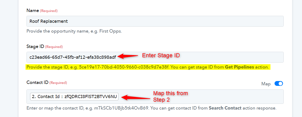

Hi - thank you. I went ahead and reinstalled everything and started over. It looks to be working now. However in my 3rd step I am getting the attached error from LeadConnector 'Can not create duplicate opportunity for the contact'. In step 2 I am creating/updating a contact. So I am confused about why it says duplicate opportunity when an opportunity is not being created in step 2? Thank you!
ArshilAhmad
Moderator
In the 'Create Opportunity' action step, enable the Contact ID mapping button and then proceed to map the Contact ID from step 2. Additionally, make sure to enter the Stage ID instead of the Stage Name. Make a test submission and let me know if this fixes the issue for you.
