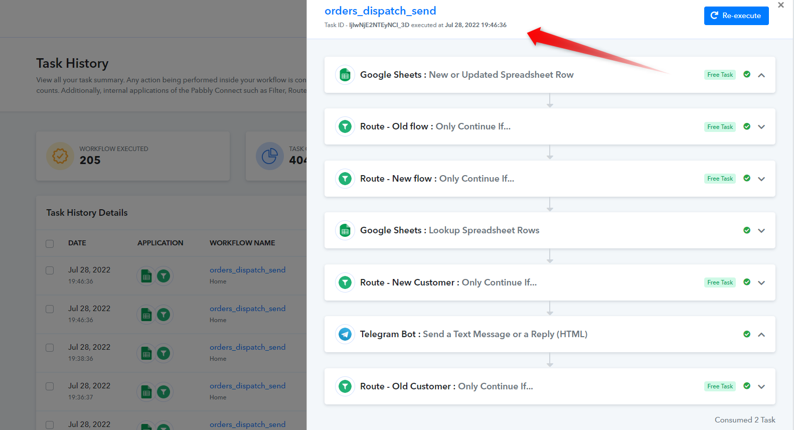

Hey @olegshevlyagin
As we can see from your workflow, your workflow has correctly executed the whole process successfully.
Kindly cross-check again and let us know if you are having any further issues.
Moreover, the "Auto Send on Schedule " ad on option will allow sending data being added from an external source to Google Sheet with a time interval of 1 hr. Open the sheet from where you want to send data, and then enable this option.
