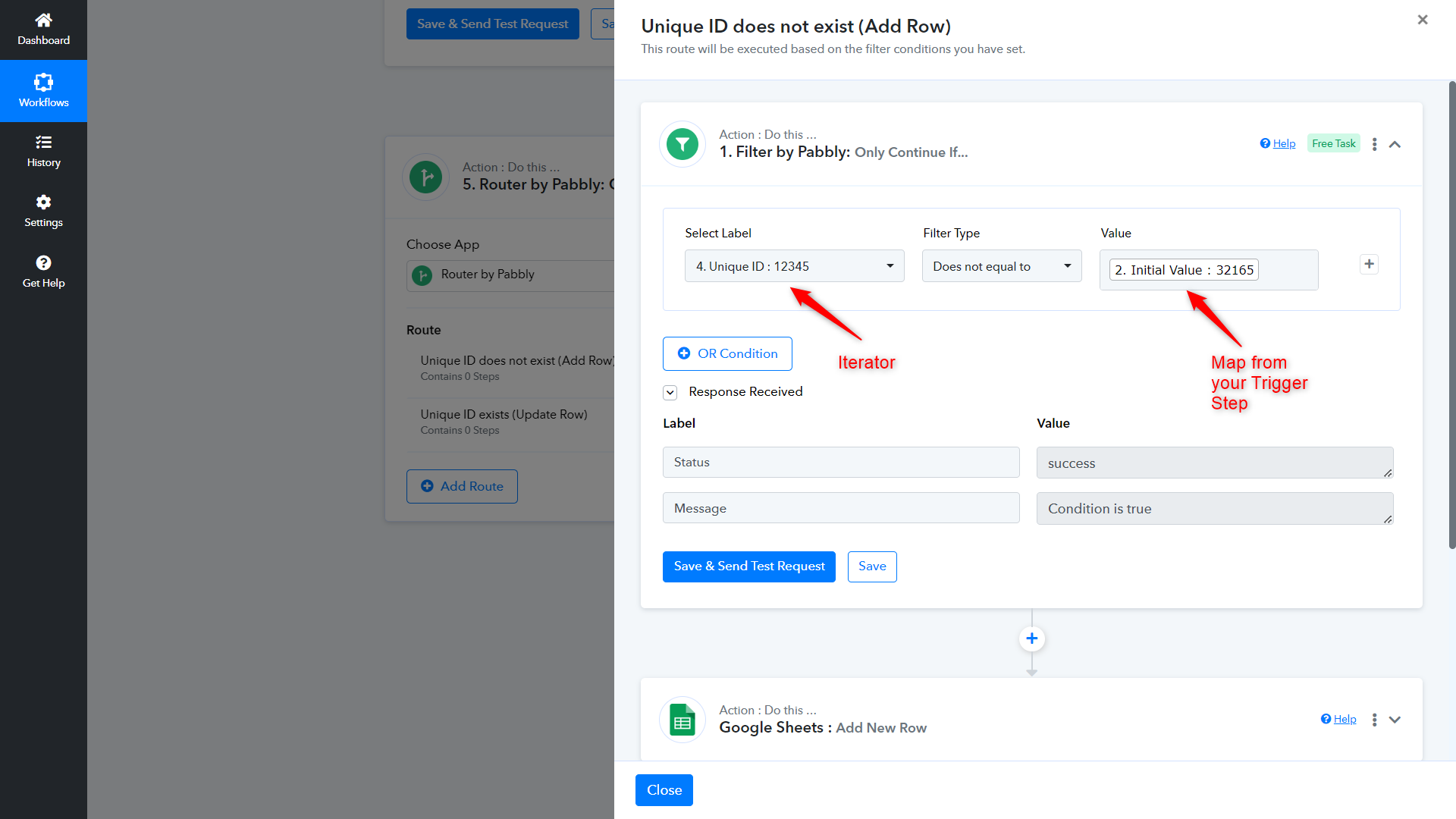

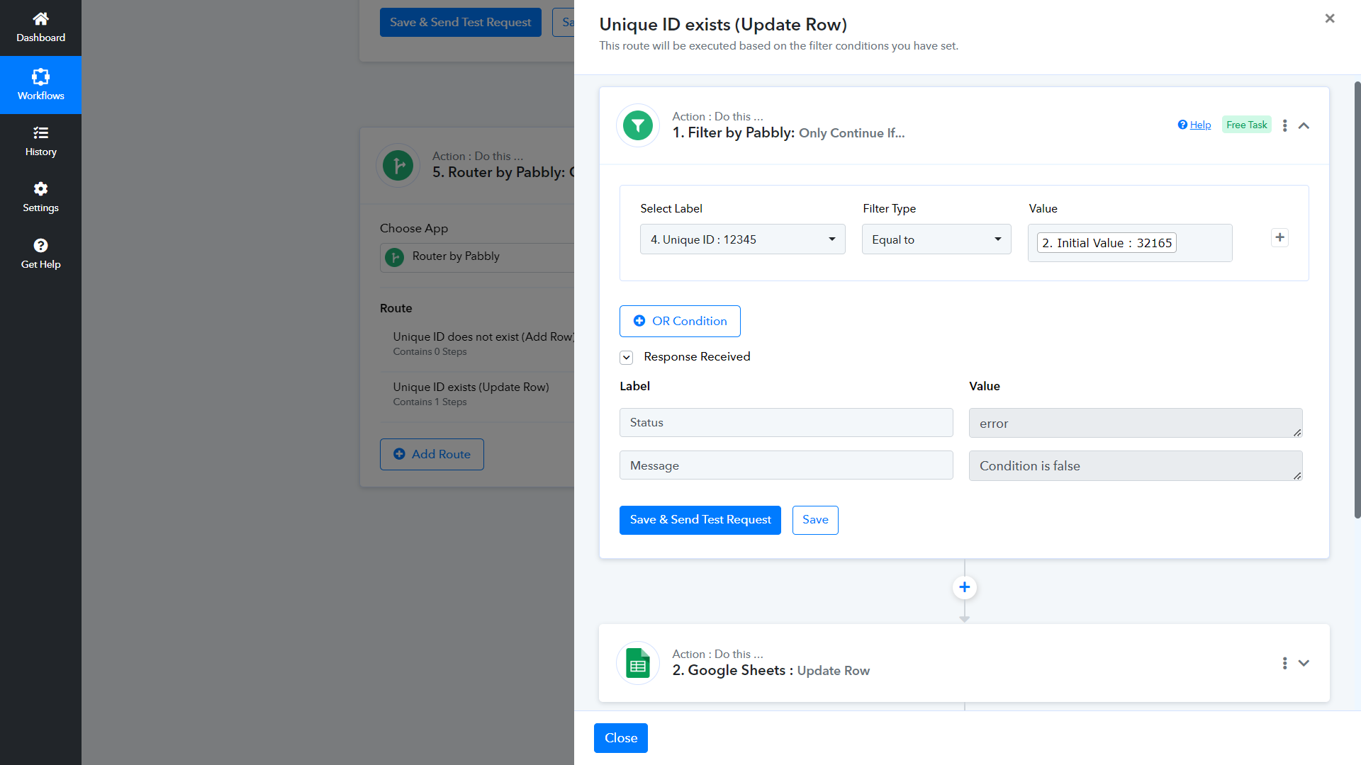

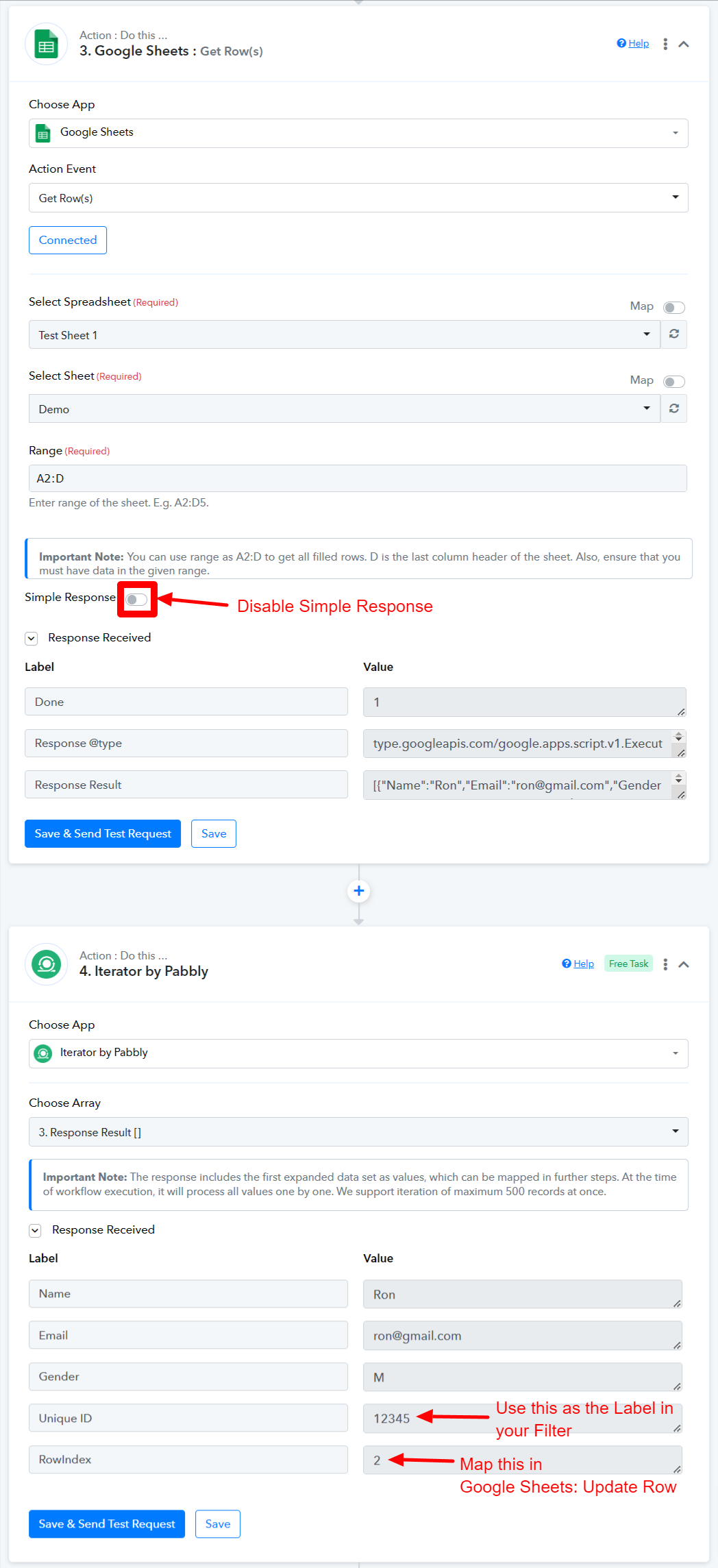

Hey @rodrigo,
The use case you are describing will require you to add Google Sheets: Get Row(s) action event, Iterator, and Router with 2 routes to your workflow.
Google Sheets: Get Row(s) will fetch the entire data from your spreadsheet. Iterator will process the data one row at a time, and Router will help you decide what further action is needed based on the Unique ID you get from your trigger application.
If the data captured from Google Sheets does not contain the Unique ID, a new row will be added to your spreadsheet.
If the data captured from Google Sheets does contain the Unique ID, then the row that contains the Unique ID will be updated with new data.

Is there a limit to how many rows for the "get rows" or "Iterator" ?
The Iterator can iterate a maximum of 500 rows. There is no row limit for the "Get Row(s)" action event, but there is a maximum data limit of 6 MB.

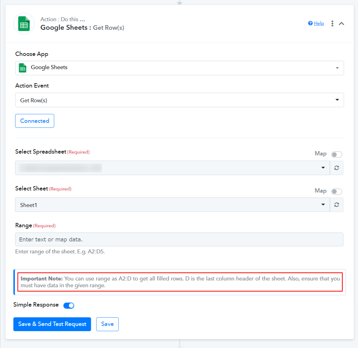

Also, can we get "Get Rows" as a Defined Range of 1000 rows instead of only the DATA Containing Rows... Because, We expect data to be filled in those rows eventually... and it will be a headache to manually change this
This is not possible. The Google Sheets: Get Row(s) action event only fetches the data stored in your spreadsheet. Please refer to the help text in the screenshot attached below.
