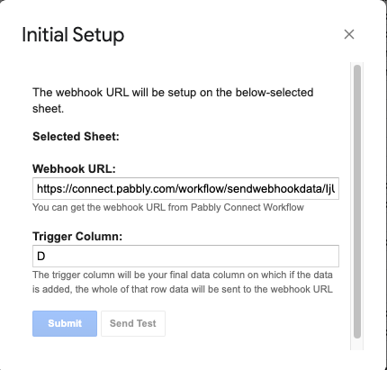

I am trying to setup a process to kick off when a google sheet is updated. I followed the tutorial to add pabbly to the sheet and opened inital setup. I paste in the webhook and select the column to use, then press test. Nothing happens the frame just locks up. I tried clicking ok, and nothing happens then either. Pabbly still says "waiting for webhook response".
What gives?

Thanks! This is my first automation on this tool. What a frustrating first experience. Why does incognito mode make it work vs otherwise? Bug in the software?
Fagun Shah — Reply ·
It is a google extension limitation, the issue happens bcoz of Multiple gmail account login in the single browser profile. Incognito mode solves that.
I faced the same issue when I started using their software, but believe me other integration are much more easier to setup.
