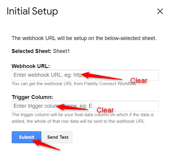

Apologies, please ignore the previous response.
To remove the webhook URL, simply clear it from the Initial Setup of Sheet 1, remove the Trigger Column, and click on "Submit".

If I clear and click on Submit, the "pop up" says "Please fill the fields". If I leave them blank, close the pop-up, then re-click "Initial setup", I see again the previous values.
Hi @Vincenzo Tortora,
Instead of leaving the field blank, please add a space in the field and then submit.
Vincenzo Tortora — Reply ·
Oooh, ok, now it works! :)
