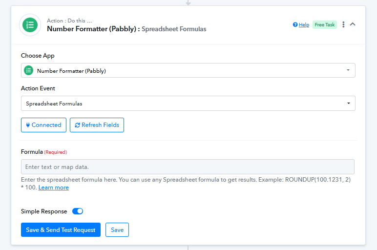

Currently, Pabbly Connect does not support triggers on Google Sheets columns that contain formulas. The trigger only works on direct user input.
As a workaround, you can capture the raw input from the client and perform the calculation within the workflow itself using the Number Formatter or Spreadsheet Formula steps. This ensures the webhook triggers correctly while still calculating the total investment automatically.

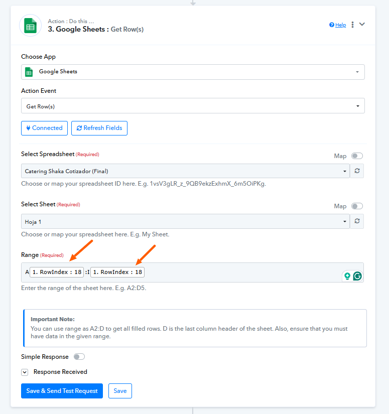

I am trying to find another way to handle this, and I am sending all the info from the column before the formula in the sheet, and then with a get row I pull the info and use an iterator. The only issue is that when I send the quote, Pabbly send me all the quotes from the other rows too. Is it possible to only send the quote from the last row added?
Jorge — Reply ·
I am creating a quote generator. The issue is that since the last column is a formula, I cannot use it as a trigger, so I use the column before the formula as the trigger. Then, I want to pull the entire row with the cost of the service generated by the formula. I tried using Get Row and then an iterator, but it pulls all the information from all the rows, and instead of sending me just the quote from the last row, it sends me all the quotes from all the rows in the sheet. Is there a way to pull only the last row?
Hello @Jorge,
Kindly try capturing the row using the Get Rows action by mapping the required Row Index. Please refer to the attached image for more details.
While there isn’t a direct action to fetch the last row at the moment, this method should help you achieve your use case. Give it a try and let us know how it goes.
