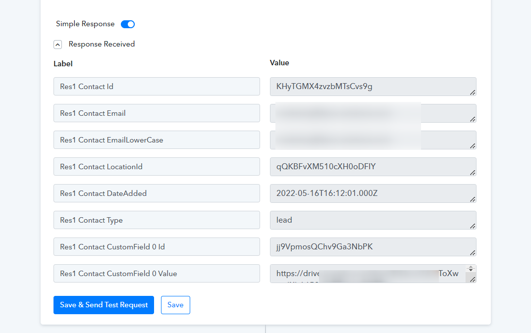

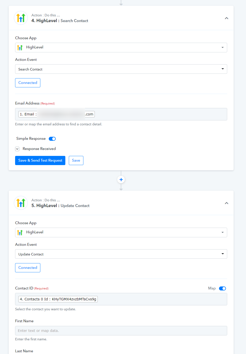

The contact Id in the "Update Contact" action step which you are passing was belong to some other account and you are updating the contact with the different account credentials.
So, you should use "high level: Search Contact" with the account credentials in which you are passing the contact.

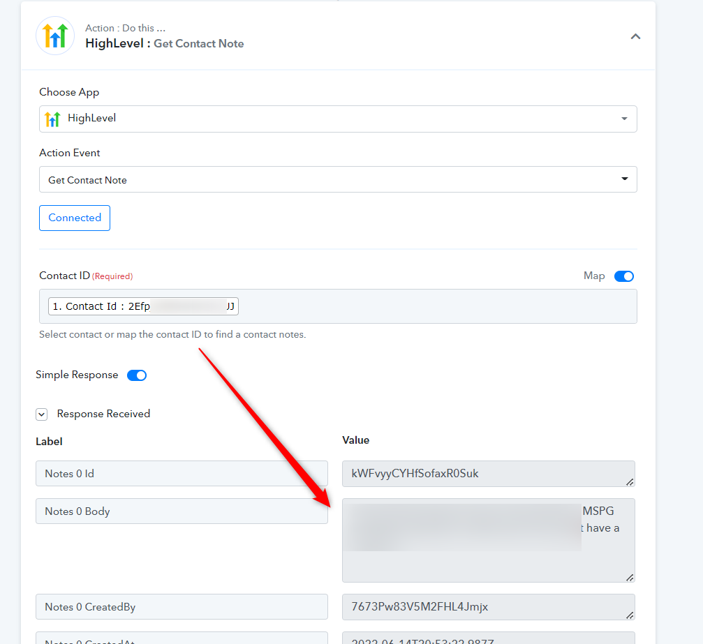

2- I did the test again, with 2 different contacts and that info still no capturing
Kindly try the "Get Contact Note" action step to retrieve the notes.

We have tried the action step again in your workflow and it is working accordingly. Seems like you didn't refresh the Contact Id before passing it to the Update Contact action step.
Kindly try again and let us know if that helps you out.
