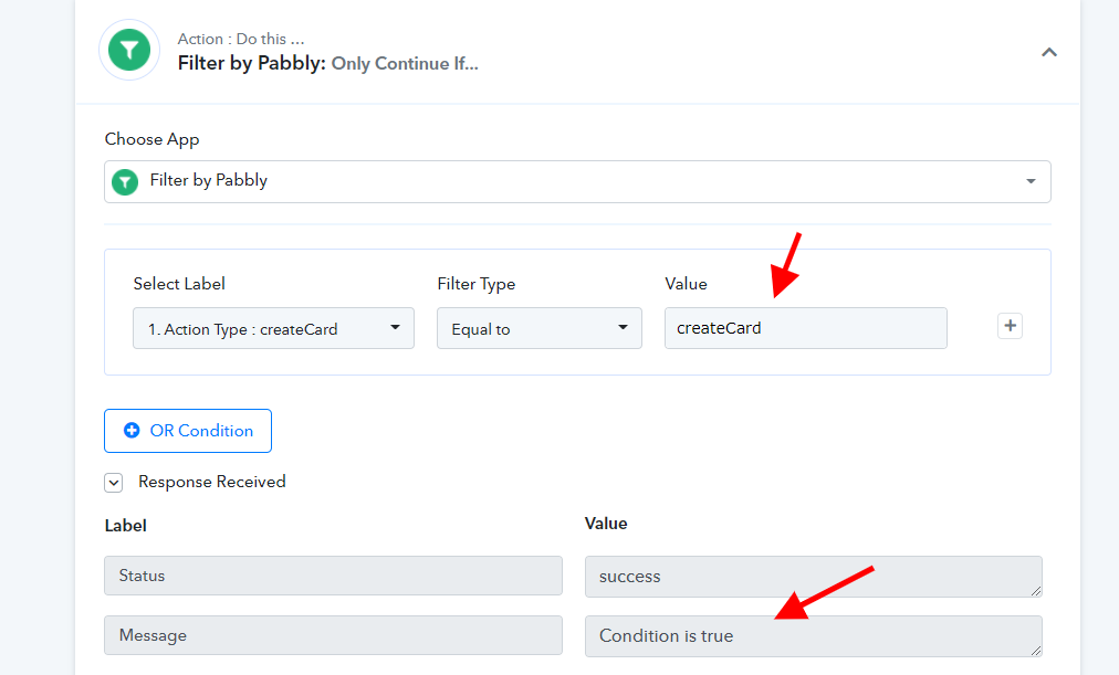

Thanks. Now it's working. But I have another issue.
If the card moved to another list, or even edited the card trello is sending to telegram. But in my workflow should be only new card added that will be send to telegram. Can you check it? thanks

Just add a filter to check the condition for new card only like shown below -
We have updated the worklfow by adding the filter, and now the workflow will work only for new card created.
Note that the filter step will not count in your task consumption.
