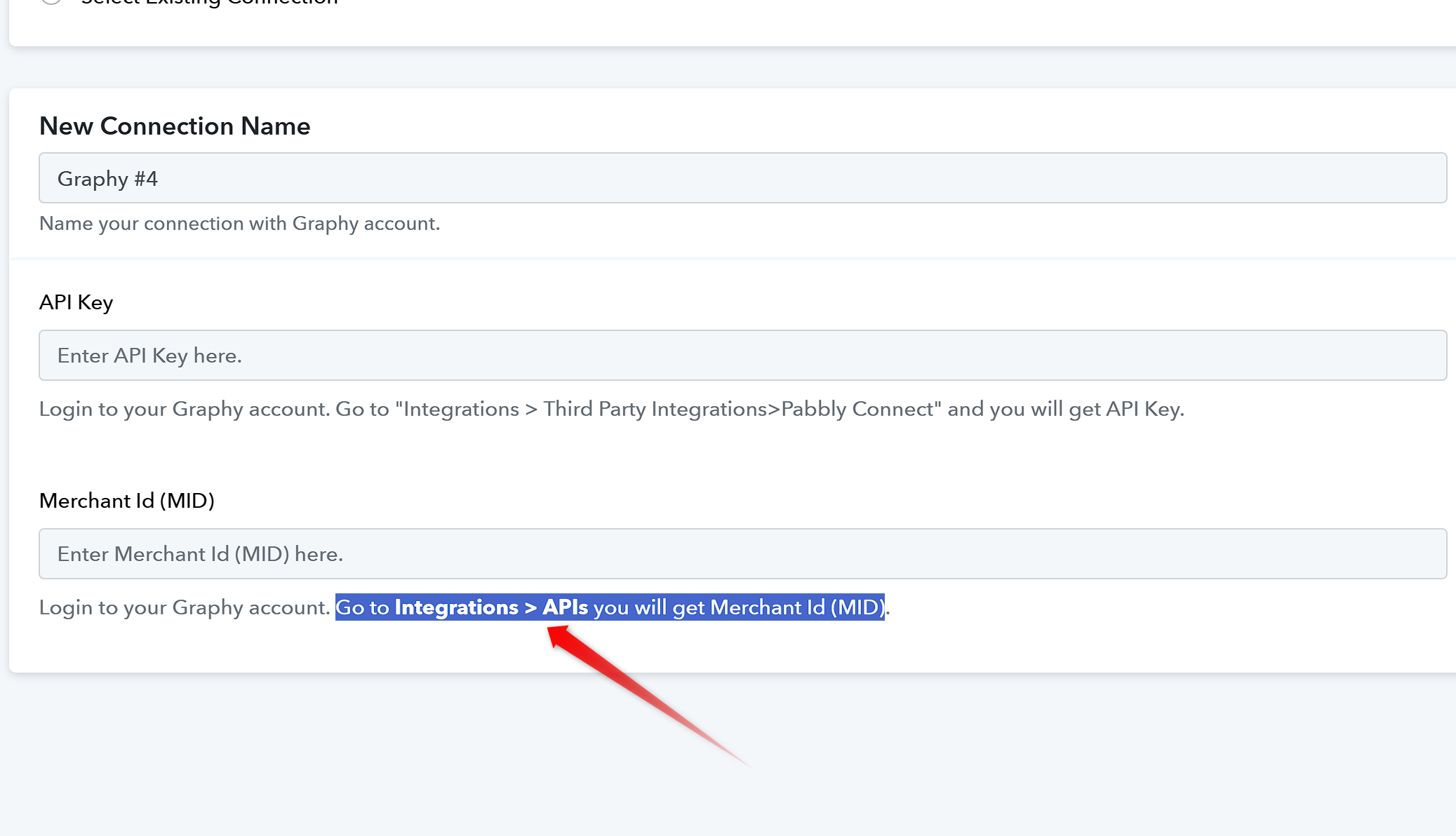

I've attached screenshots showing:
  • The Graphy API Token and Merchant ID.
  • The Pabbly connection configuration.
  • The failed task history.
  • The "Token not valid" response.

Pabbly Support β€” Reply Β·
Hello Ravi,
Thanks for contacting us.
Kindly reestablish the connection and using Merchant ID instead of the sub-domain, and record the whole process as a screen video so that if you continue to face the issue, we can understand the issue.
