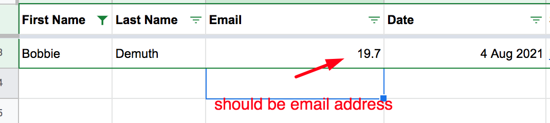

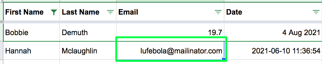

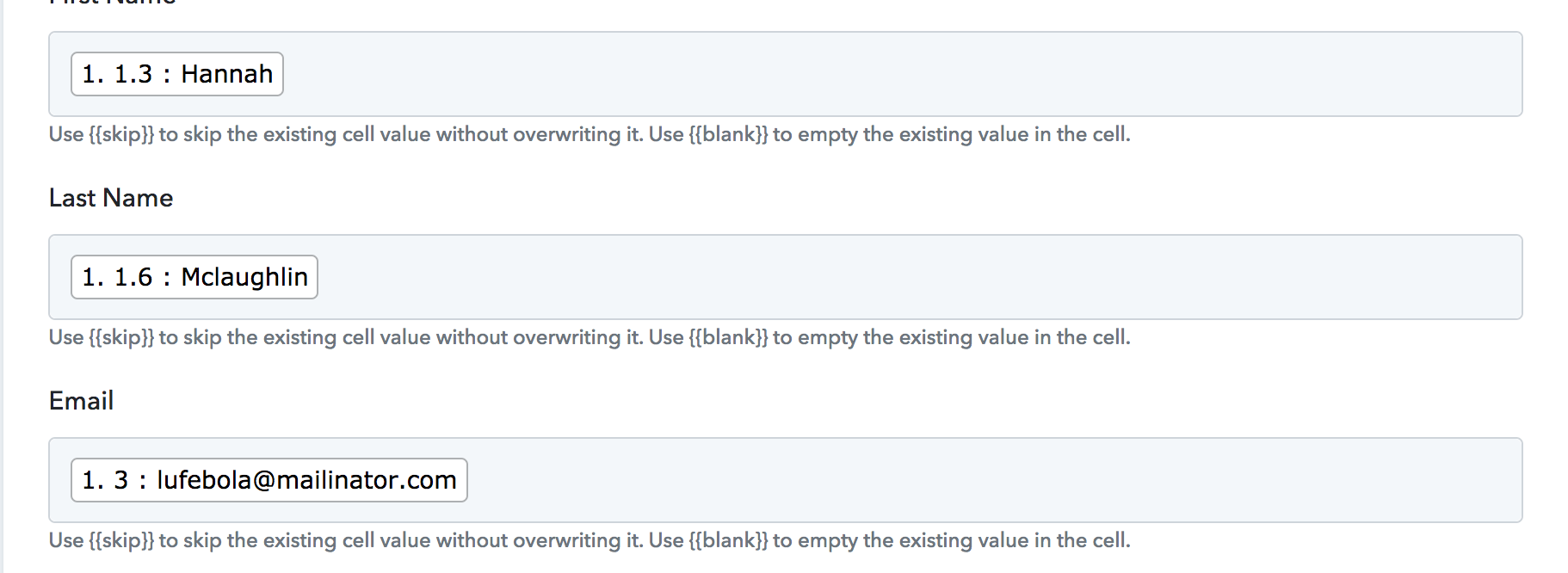

The issue I have is that the integration is no longer putting the correct value in the email cell on Google Sheets. It was working before, but it's suddenly grabbing another value from the Gravity Form. I have not made any changes to the form.
When I send a test entry, it does work correctly:

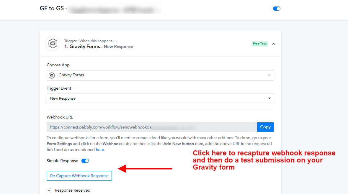

If you changed the fields on the form or even changed the order of the fields in the form, you may have to capture the webhook response again and would have to re-map the fields again.
I did not change or reorder any fields.
Sometimes it puts the correct value in the cell, other times it takes another value.

We request you to kindly recapture the webhook response once and then do re-map the further steps.

Hi @Supreme

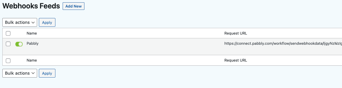

The data from the Gravity account is staying unchanged. All I had to do is add the webhook:

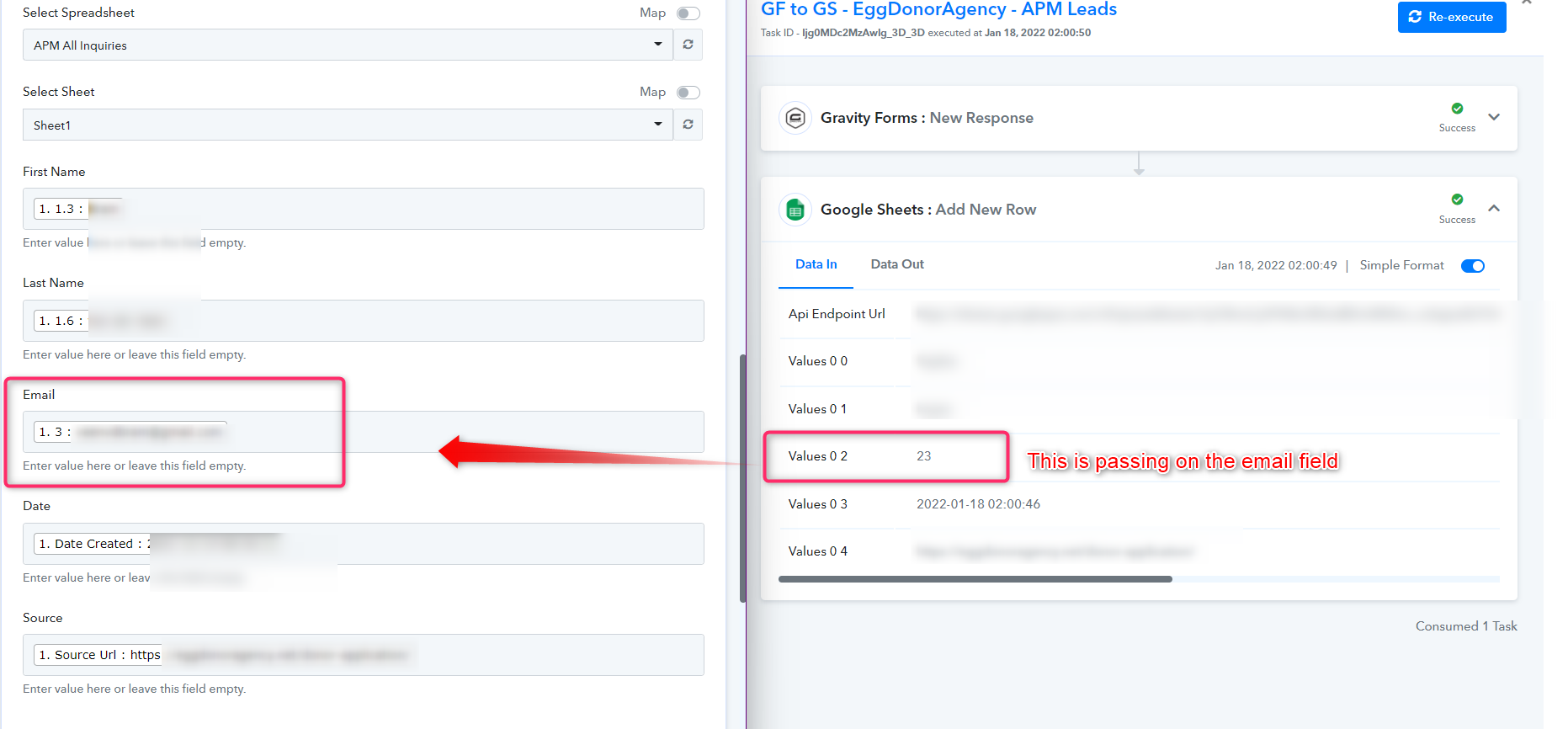

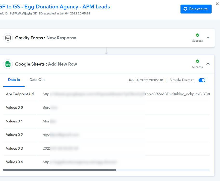

Even on same day submissions the field mapping is incorrect:

As we can check for your workflow's history section your automation is working fine. Except you might have changed the email label from your Gravity form which you have mapped previously.
So, now the data is coming in different fields according to your current mapping. Other than that the workflow seems fine to use.
Further, if you make the changes in your Gravity form, then kindly recapture the webhook response and then re-map the corresponding fields accordingly.
