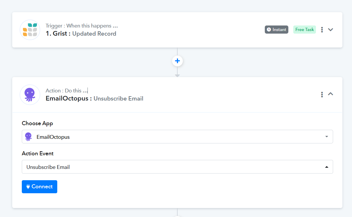

Hi @androlto,
ou can use 'Grist: Update Record' as your trigger step to capture user who unsubscribed, and then use 'EmailOctopus: Unsubscribe Email' to remove that user from EmailOctopus.

You can add a Router with two routes to your workflow that is used to add subscribers to EmailOctopus. Set Route 1 to execute for the addition of subscribers and Route 2 for the removal of subscribers.
