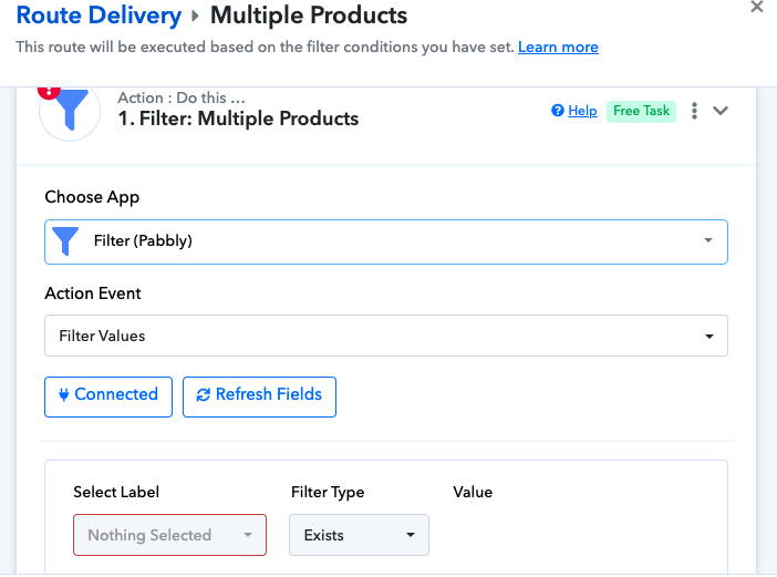

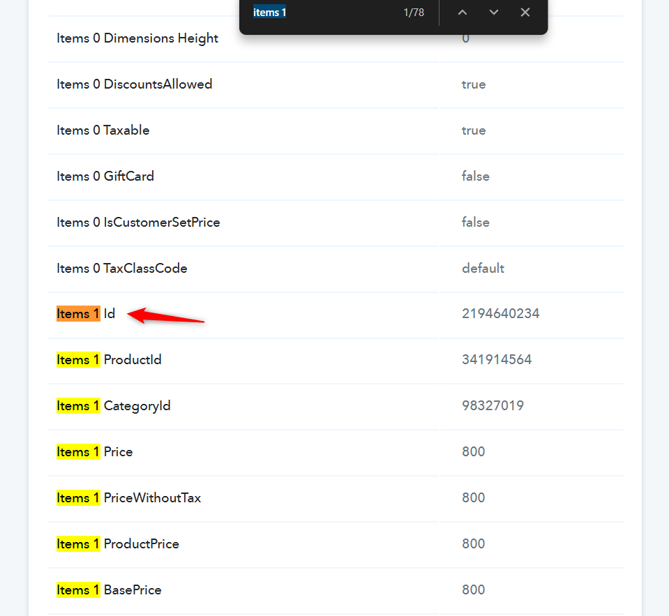

But if Items 1 Id does not exist for an order, in path 1 the 'select label' field resets to blank. Next order if Items 1 id is there, the filter doesn't work because the 'select label' field was rest to blank in the previous order.
My requirement is:
if the customer orders for more than 1 product i need to tag it as 'multiple'
the way to identify if the customer has placed order for more than 1 product is if the field 'Items 1 Id' gets created
if the field 'Items 1 Id' is not created that means its a single product order
How do I accomplish this?

Hi @virsingh77,
You can handle this by using the Filter with the “Exists” condition, as shown in the screenshot.
Map Items 1 Id in the Select Label field and set the Filter Type → Exists. If this key exists in the response, it means the order contains multiple products. If it does not exist, it means it is a single product order.
You do not need to worry about the label appearing blank in the builder. The filter will still check whether the key exists in the incoming response.
So:
  • Items 1 Id exists → Multiple product order
  • Items 1 Id does not exist → Single product order
You can test this once, and it should work as expected.

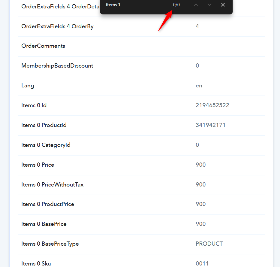

virsingh77 — Reply ·
The problem is once i receive a single product order, the key for the multi product order disappears and the filter does not work properly work for a multi product order. and going ahead for any multi product order the filter gives the wrong output till the time i do not go an manually update the key again. also pls ignore the errors caused by the time conversion steps, I'm not referring to them. they do not affect how the filter performs.
So to recap the issue:
1. I update the key for a multi product order using 'Items Id 1' field, it works fine
2. The moment there is a single product order, the key goes blank as now the field 'Items Id 1' doesn't exist
3. And going ahead if i receive a multi product order again, the filter will not identify it since the key has disappeared.
Similary, once the key goes blank the filter for single product order also stops working. So the problem is that the key disappears

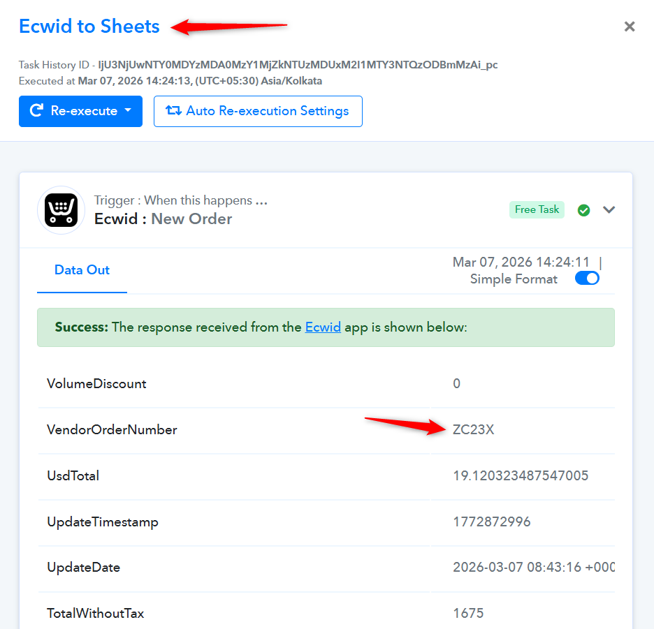

There is also another issue. I have made another workflow as a fallback to capture orders that are not captured by the workflow 'Ecwid to Sheets', this worflow is called 'Clone- Ecwid to sheets' (url: https://connect.pabbly.com/workflow/mapping/IjU3NjcwNTZmMDYzNzA0MzE1MjZjNTUzMTUxMzIi_pc).
In the cloned workflow I have removed the router to filter single and multi product orders.
In that workflow an order with id ZC23X has been captured (Task History ID - IjU3NjUwNTY0MDYzMDA0MzY1MjZkNTUzMzUxMzA1MTYzNTQzNDBmMzAi_pc)
Wheras, in the original worflow, the same order has been missed. Why is that?

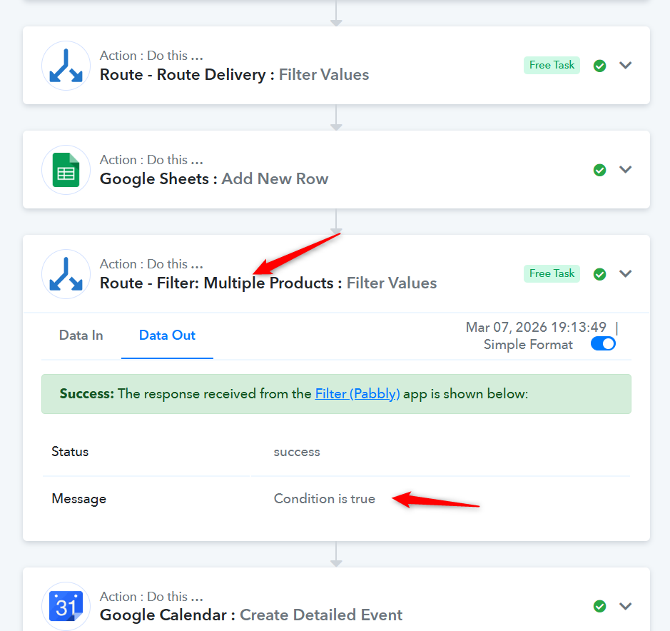

As mentioned previously, it does not matter if the keys appear blank in the setup. During workflow execution, the filter conditions are recognized correctly.
For example, in this task, when a multi-product item was captured in your Ecwid trigger step, the Multiple Productsroute executed correctly, even though the keys currently appear blank in your workflow setup.

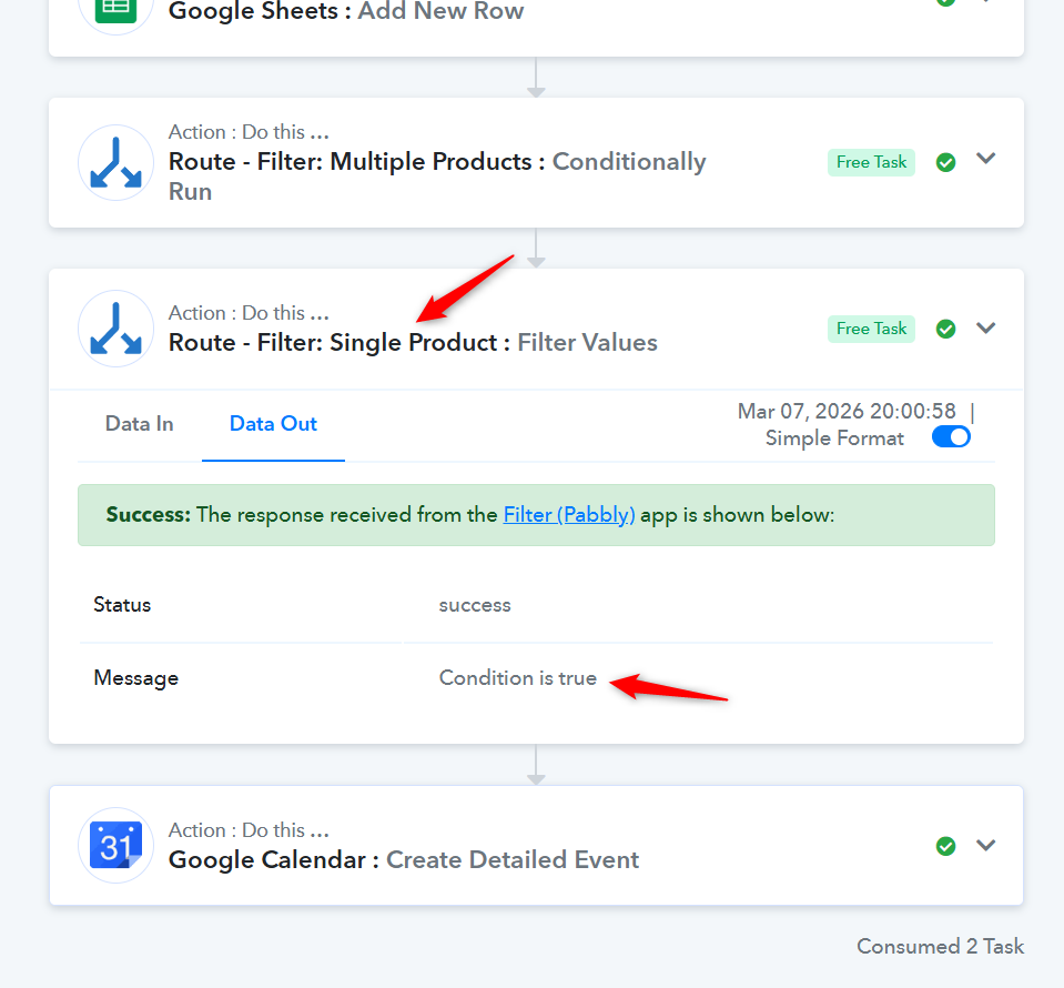

In this task, a single-item order was captured in your trigger step, so the Single Product route was executed.
Task History ID - IjU3NjUwNTY0MDYzMDA0MzY1MjY4NTUzYzUxMzI1MTY0NTQzNDBmMzUi_pc
This order has triggered the original workflow as well.
Task History ID - IjU3NjUwNTY0MDYzMDA0MzY1MjZkNTUzMDUxM2I1MTY3NTQzODBmMzAi_pc
