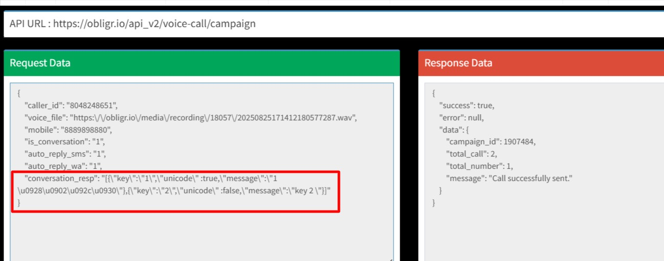

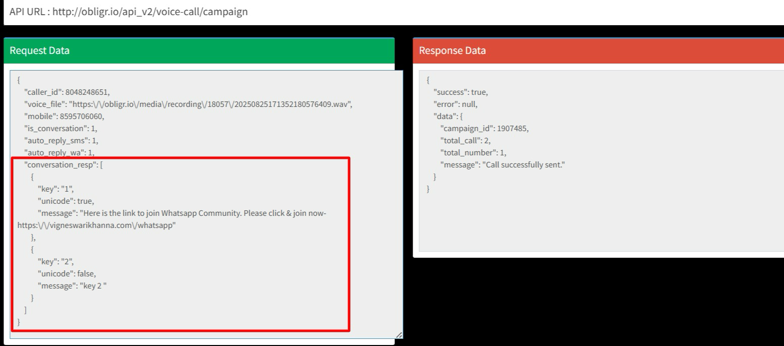

  • We want this -this is from postman --
  • But pabbly is sending this -

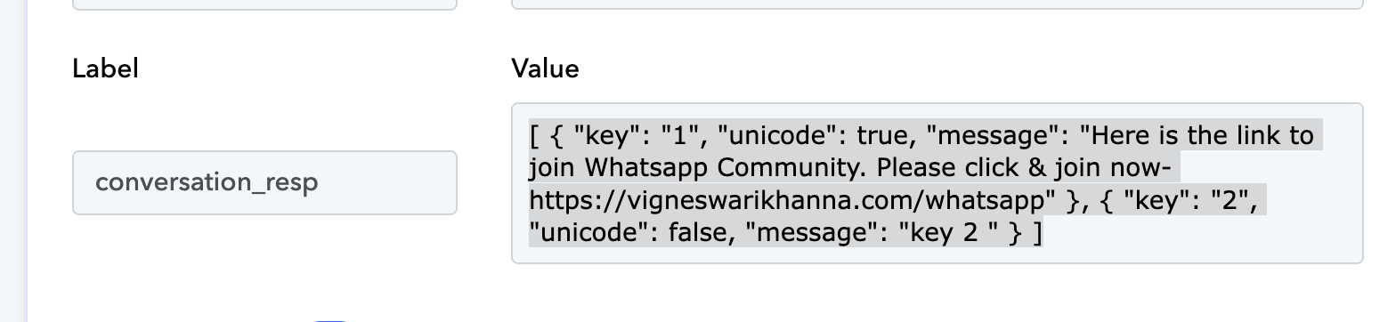

  • i have added this same on pabbly can u check properly -

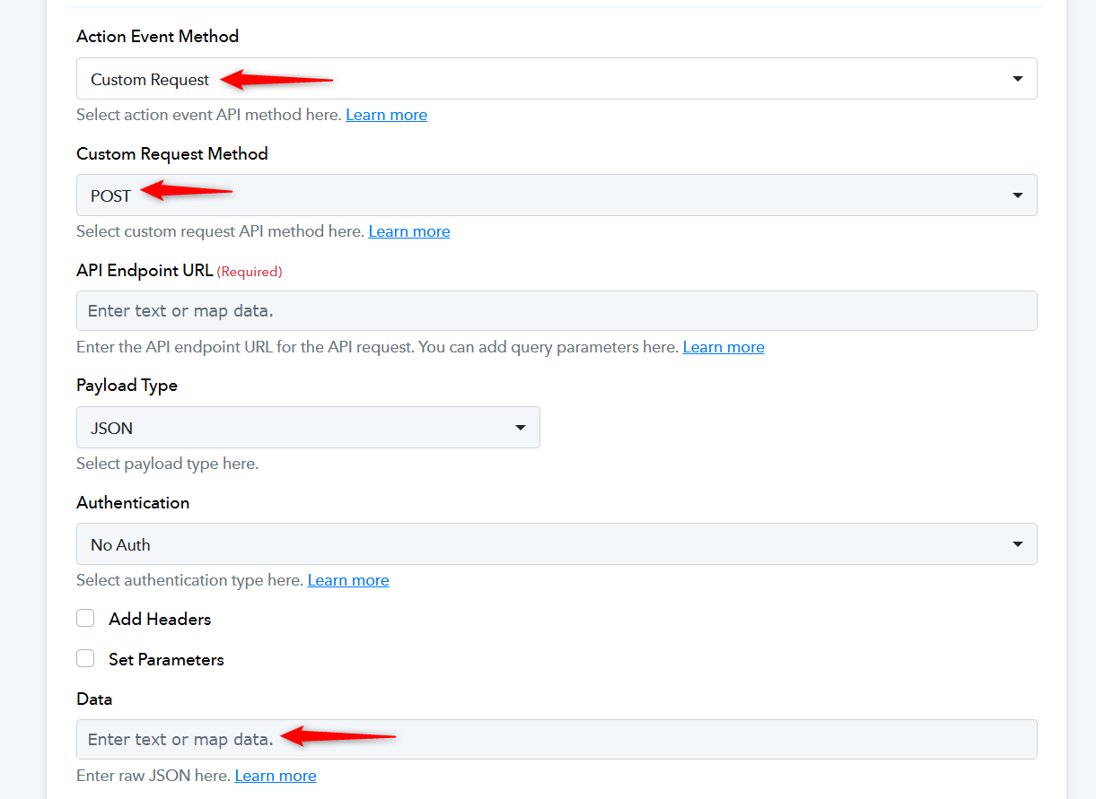

Hi @harsh40413,
Could you please share the cURL and endpoint you are attempting to execute in Postman? We suggest trying a Custom POST Request, which will allow you to pass the JSON in the data field rather than as parameters.
