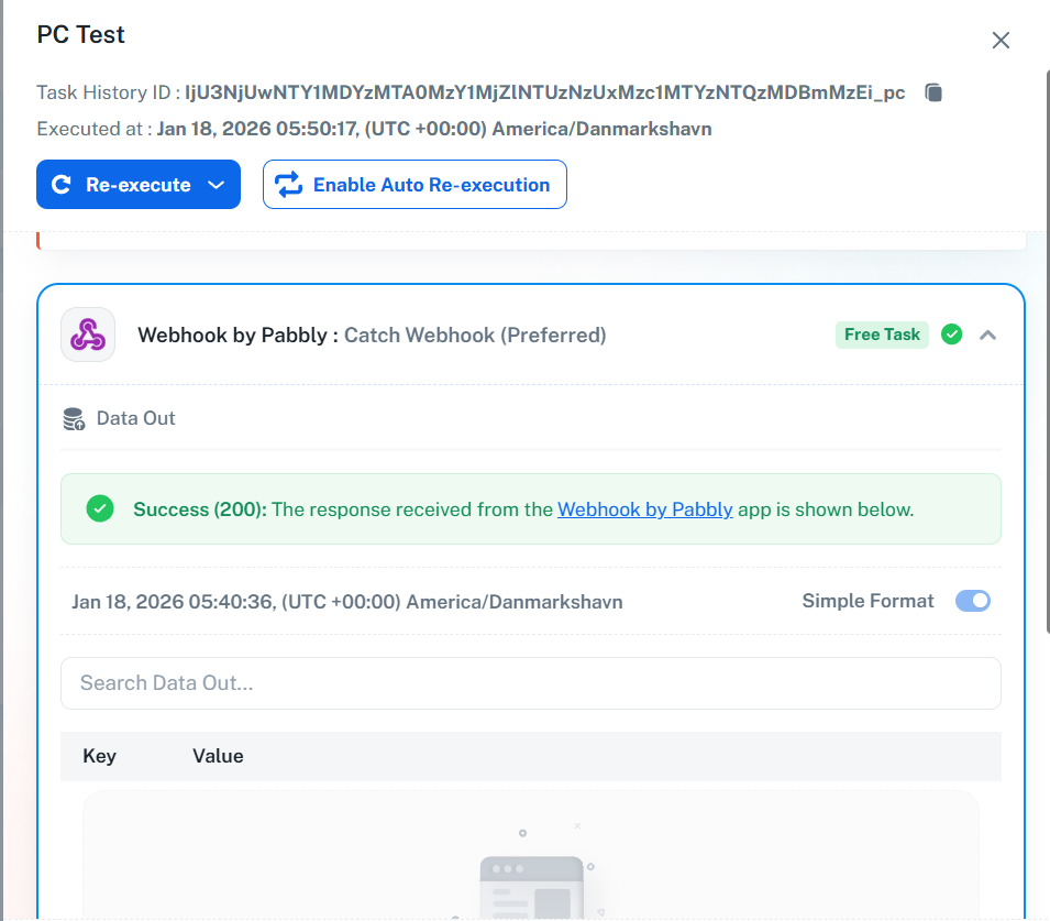

I have received an error message as follows
Task History ID: IjU3NjUwNTY1MDYzMTA0MzY1MjZlNTUzNzUxMzc1MTYzNTQzMDBmMzEi_pc
Step Name: Builderall Mailingboss > Add Lead in List With Custom Fields
Connection Name: Builderall Mailingboss #1
Task Error Detail:
"status": "error",
"message": "Required field Email Address missing
I tried a submission and it is registering in the email list.

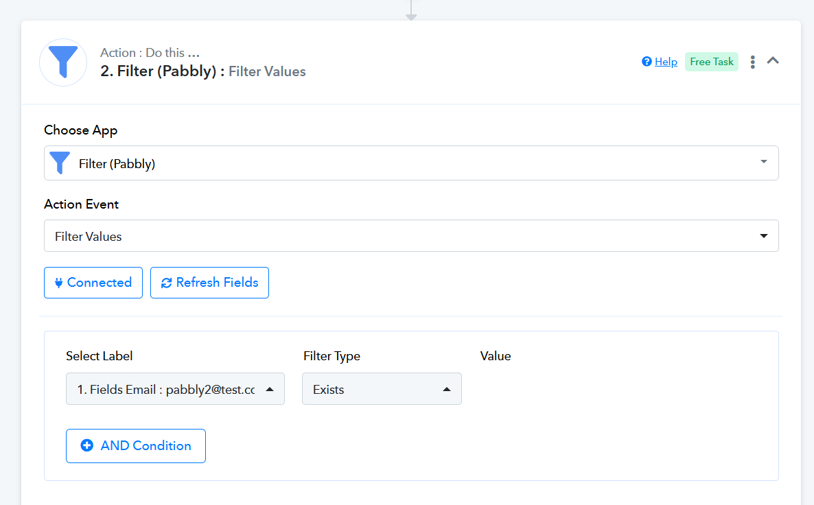

Based on your Task History, we can see that the webhook was triggered without any data. This usually happens when someone opens the webhook URL directly in a browser, causing the webhook to be hit with empty data.
We have added a Filter as step 2 of your workflow. This ensures that the next step executes only when an email is present in the data received from the webhook. This will prevent the error you encountered due to a blank webhook response.
