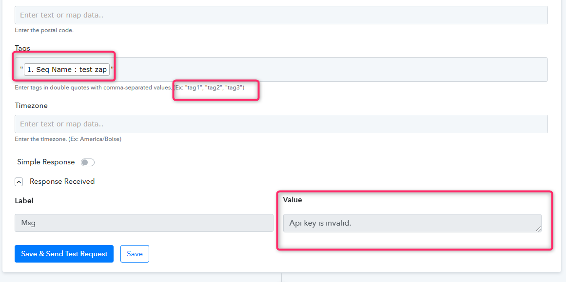

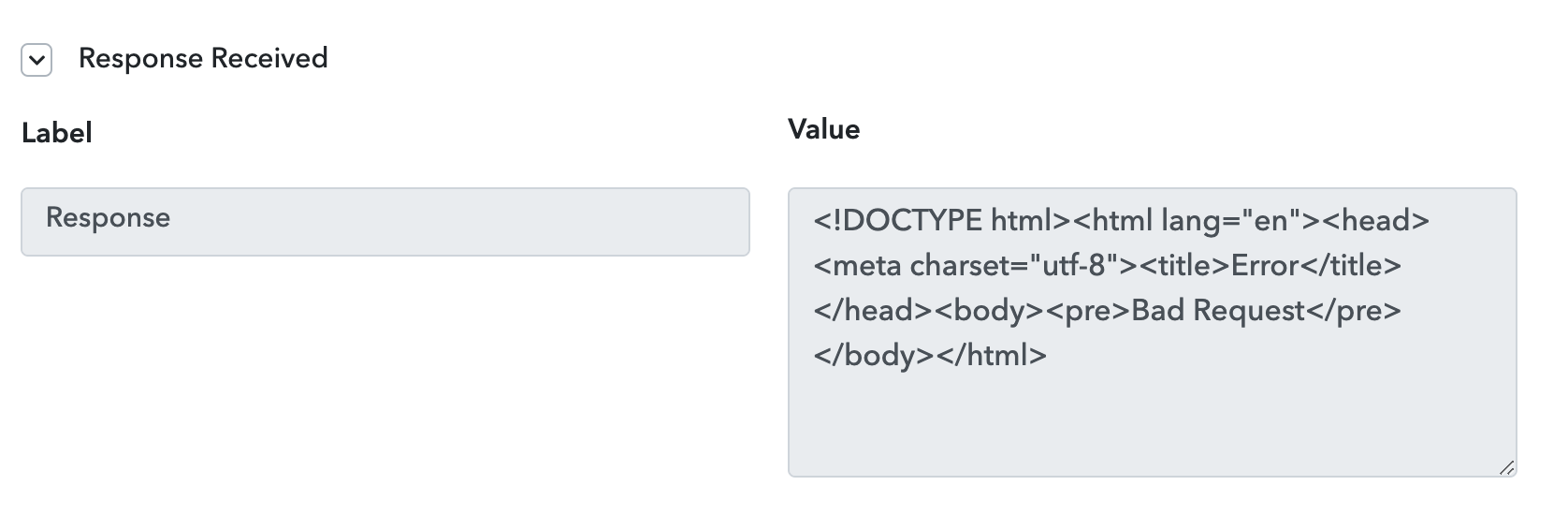

I've connected my account using "Bearer location api key" but when trying to create a new contact after a router step my test response is always "Error
Bad Request
No clue how to debug this.
Hey @KCallwood
We have checked the Router Module of your workflow and found in your Highlevel Action, you have missed the double quotes("Tag") in the Tag field and the API key which you have filled is invalid.
Further, please fill the correct bearer token in the credentials block without using the "bearer" prefix before putting the API key.
Please do the changes, then try it again and let us know if you face any issue.

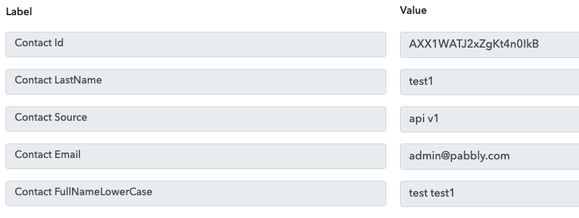

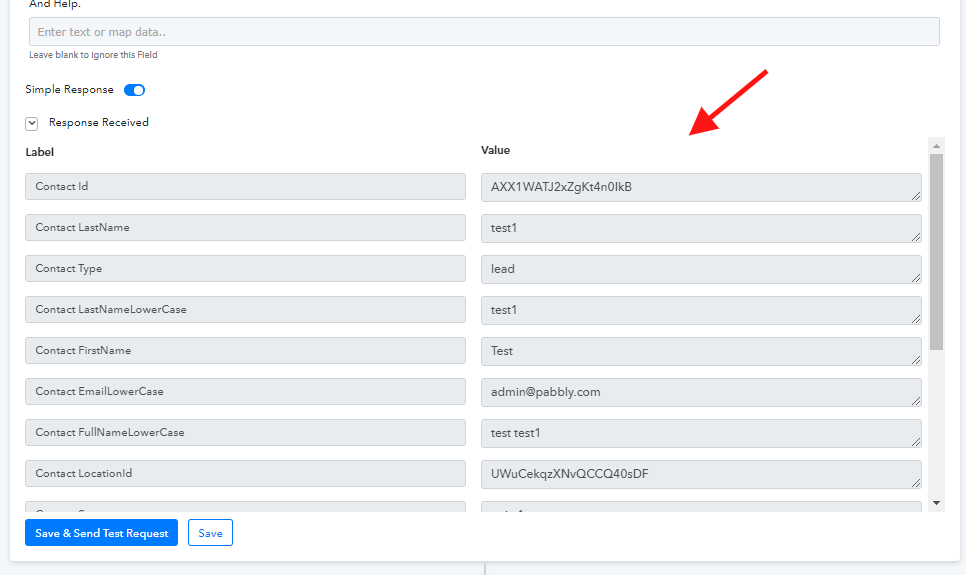

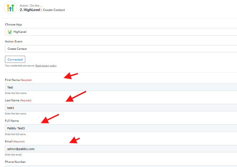

Hello. I've tried both the legacy (with Bearer) and non-legacy (without Bearer). Both connect, but now I'm facing a problem where it isn't passing all of the data (ie. first name and last name) -> https://www.loom.com/share/767352b146a545f19e91003e5824a671
Thanks for the video. We checked and looks like the GoHighLevel team has updated their APIs.
We have now updated the GoHighLevel integration and would request you to kindly reauthorize the Create Contact event once.
Please test at your end now and let us know how it goes.

Any chance of you also including a way for us to map the "Contact Source" as well?
I'd like to be able to make it say something other than "api v1" since I do have that data:

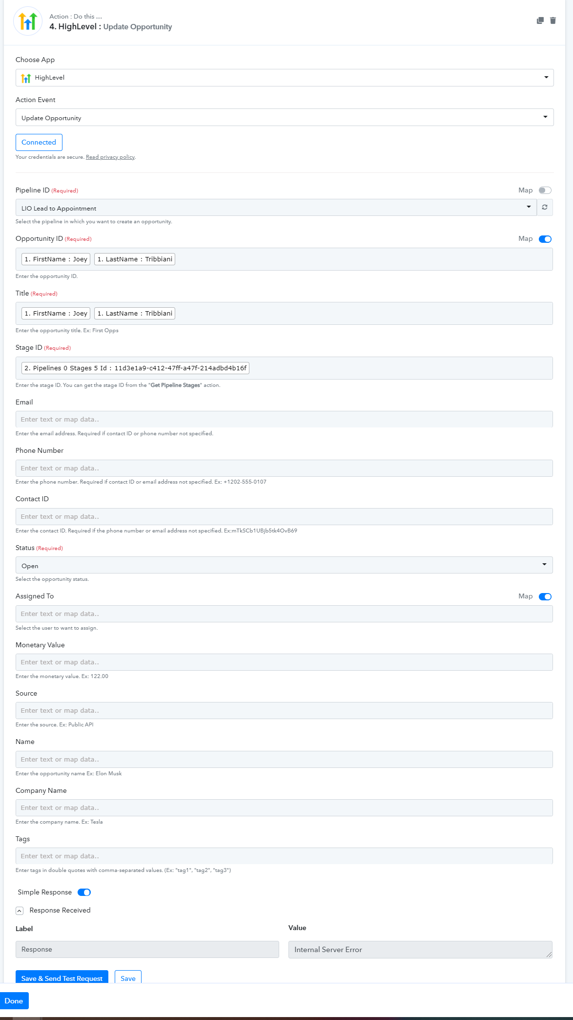

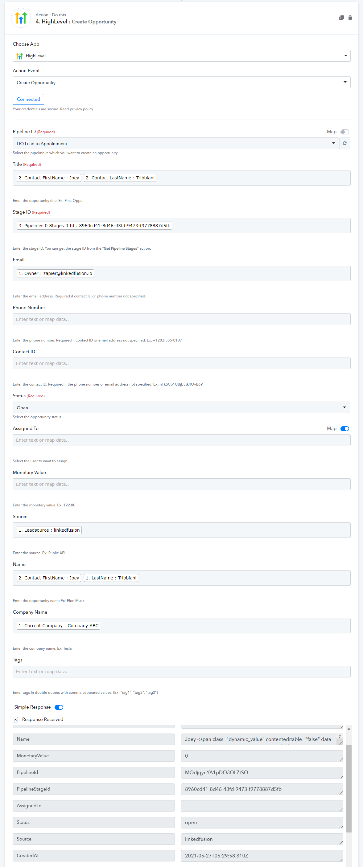

Now I'm getting the "Bad Request" response on the "Create Opportunity" step. Maybe they changed the opportunity API too (I'll need both "Create" and "Update").

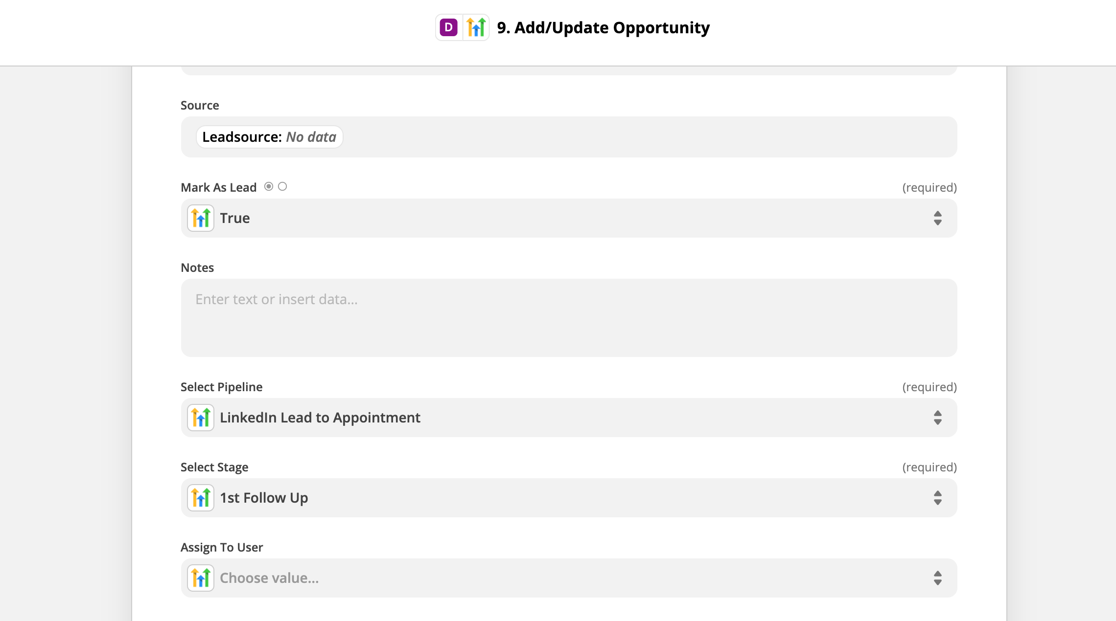

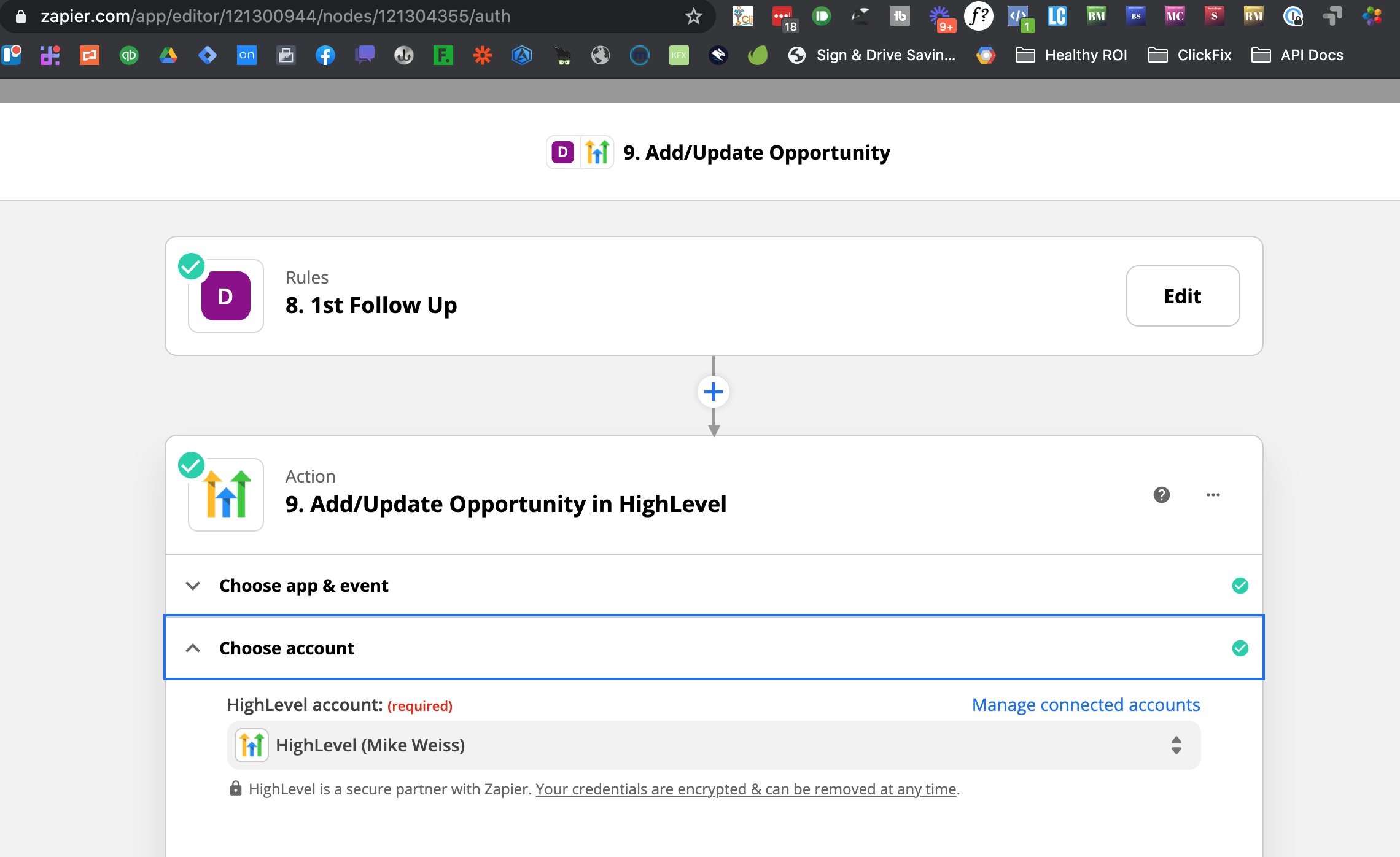

How is it that Zapier has Add/Update both contacts and opportunities?

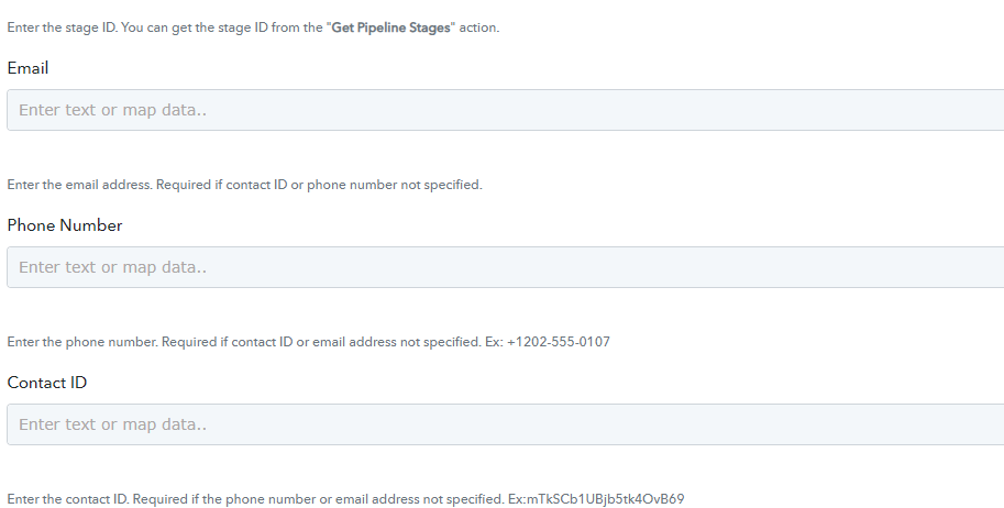

They seem to have also managed to make it so we only need the email in order to update opportunities vs the "Opportunity ID" we need in Pabbly (which I'm having trouble getting) AND also automatically grab the "Stage ID" (see screenshot below) instead of needing the extra "Get Pipeline Stages" step we have to do here. Is this something you can improve since it streamlines the entire process (a lot)?

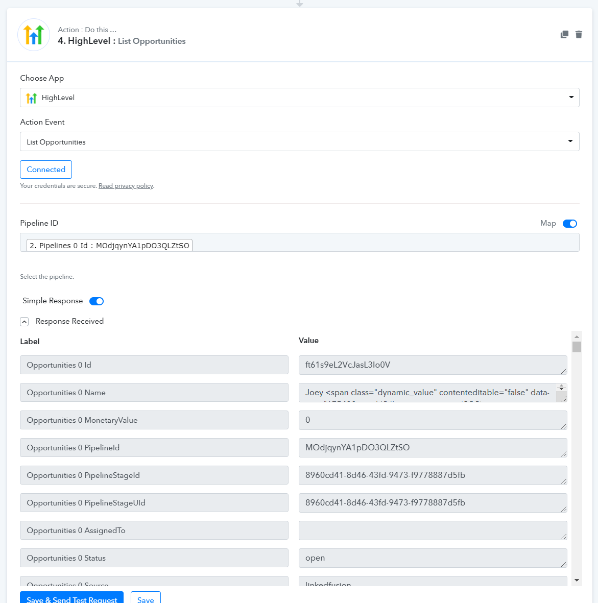

We have updated the " Create opportunity " Action event, as per Highlevel's API documentation. And it is working absolutely fine.
And as per Highlevel's API terms, we can't make both create and update opportunity in one endpoint. So, we have created an additional endpoint of Update Opportunity, which is also working fine.
Moreover, in order to update the opportunity, you have to take at least a phone number or Email id or Custom ID, so while updating please make sure of that.
And for opportunity_id, we have to create an endpoint of " List Opportunity", which you can map on further Action.
Further, now you no more required to use "API by Pabbly" Action to get the Pipeline ID or more also we have made some changes in your Highlevel action please check that out then give it a try and let us know if you face any problem.

This one shows that the add/update single action step is possible (Zapier was able to do it): Minute 2:24 -> https://www.loom.com/share/eec5f007d09841d0b74860b1ac2b3cca
