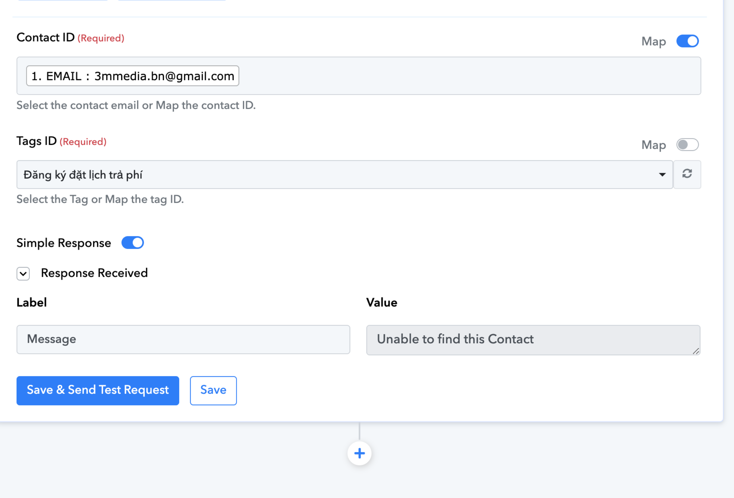

Hi there,
How can i add tag to contact which is created / update to keap from google sheet.
I have tried setting like the image bellow
and when i hit "save and send test request", this is what i got
I think it did not work, so can you help me how to set up the right way!

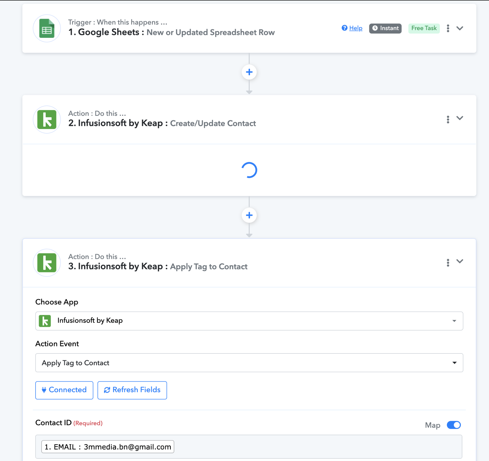

I use a landingpape in my own to collect data, then, it will be send to google sheet. And now, what i want is when new row is added, contacts will be added or updated in keap, and allso be added tag. But when i add a test contact collume by colume in google sheet, it work, contact was created or updated in keap immediately, but if i fill form in ladingpage, then new contact is added in google sheet, but nothing happen in keap, i can not see new contact is added here!
Hello @vukhcsoncoin,
And i see that, if i fill colume by colume in google sheet, then it work, but if data in google sheet is from form in landingpage, or if i paste a row to google sheet, that mean, all infomation are fill at one time, it does not work, what should i do
When entering the data into your Google Sheets, make sure to add the data to your trigger column as well in order to trigger the workflow.
To make automation work, you need to enable 'Send On Event' if you're manually entering data into your Google Sheets. If the data added to your Google Sheets comes from another API or third-party application, you also need to enable 'Auto Send on Schedule'.
Note: If your data is being added from an external source/API, your workflow will take up to 1 hour to get triggered.

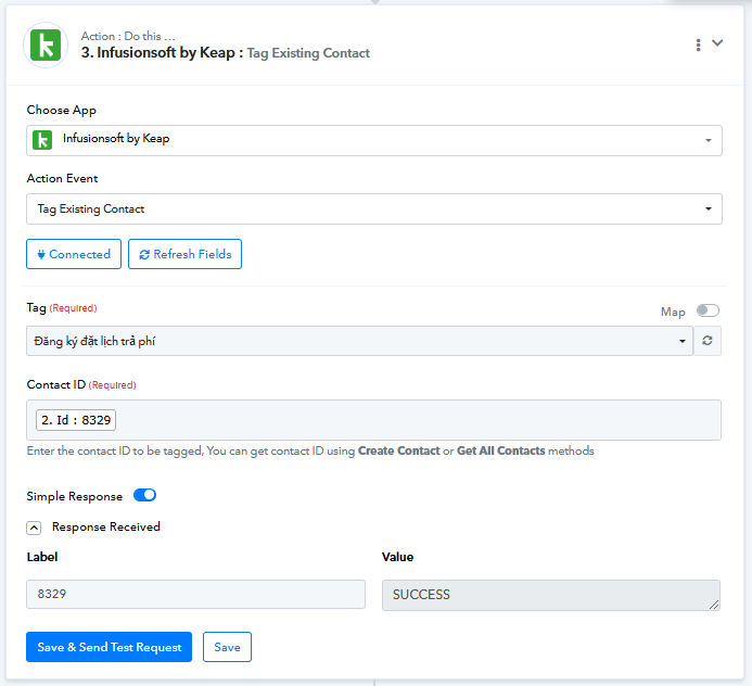

It looks like you have successfully added the tag to the contact—please refer to the attached image for confirmation.
However, if you want to add dynamic tags, you can use the Search Tag option to find the tag by its name. You can also map the tag name from the data received in the trigger, provided it is being fetched correctly.
