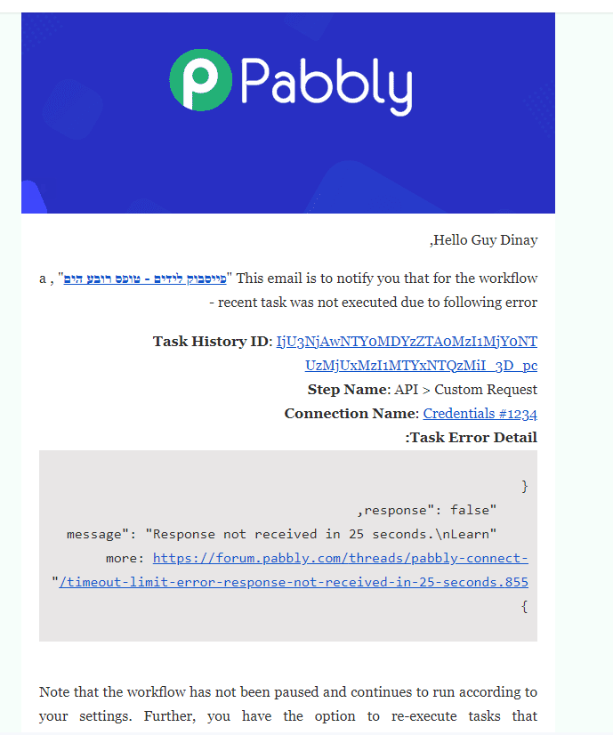

How can I fix this kind of problem?

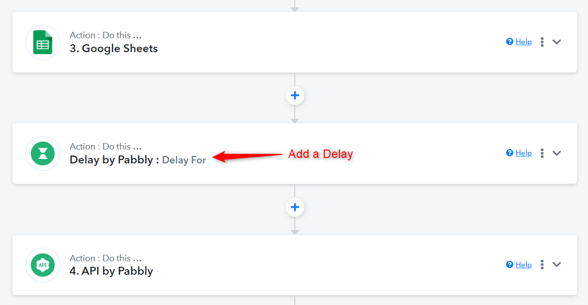

Pabbly Connect waits 25 seconds to get a response from the API. If the API does not respond within 25 seconds, this error occurs. To prevent this you can add a Delay between the Google Sheets action step and API module.

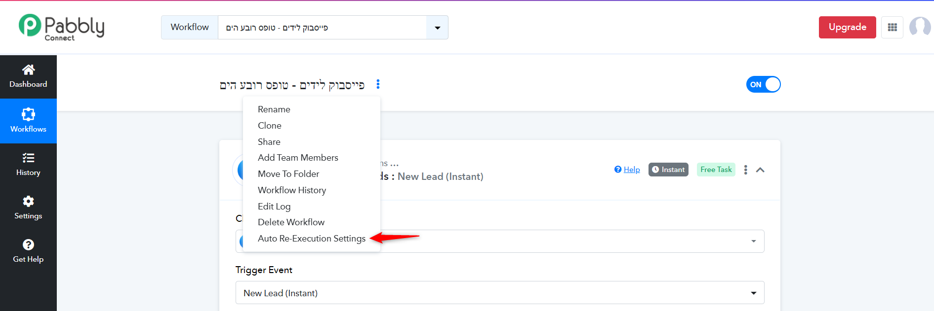

You can also enable the auto re-execution feature for this workflow, which will automatically re-execute failed steps of your workflow. For more information regarding this feature, please read the thread attached below:
https://forum.pabbly.com/threads/how-to-enable-auto-reexecution-for-workflows-coming-soon.15088/
