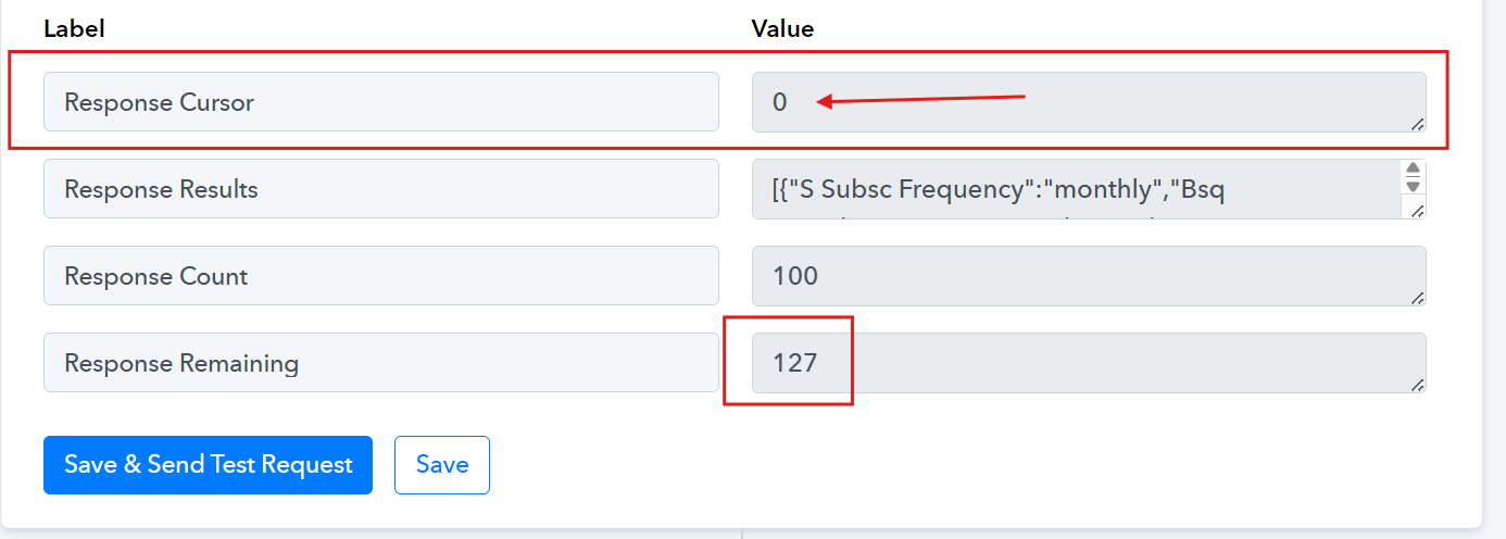

I need to manage the cursor position to run an API pagination. But I cannot do that without iteration. The pagination is of 100 and I have record of 1000

How to retrieve the "Remaining" response of 127. I will have to move the cursor to 100 to get the remaining response. How can I do that?

Thanks for sharing the details. Based on your use case, the only possible workaround we can suggest is as follows:
- After the API step (with the cursor), add a Google Sheets – Update Cell step to store the current cursor value (starting with 0 and ending at 100).
- The Iterator will then process the fetched records (e.g., 100).
- In the next scheduled run, use a Google Sheets – Lookup to fetch the last cursor value, use a Number Formatter to increment it, and map that updated value back into the API request to fetch the next set of records (e.g., 101–200), and so on.
This approach helps maintain cursor continuity across runs. While this is a workaround, it's currently the most feasible method for your setup with custom API requests.
