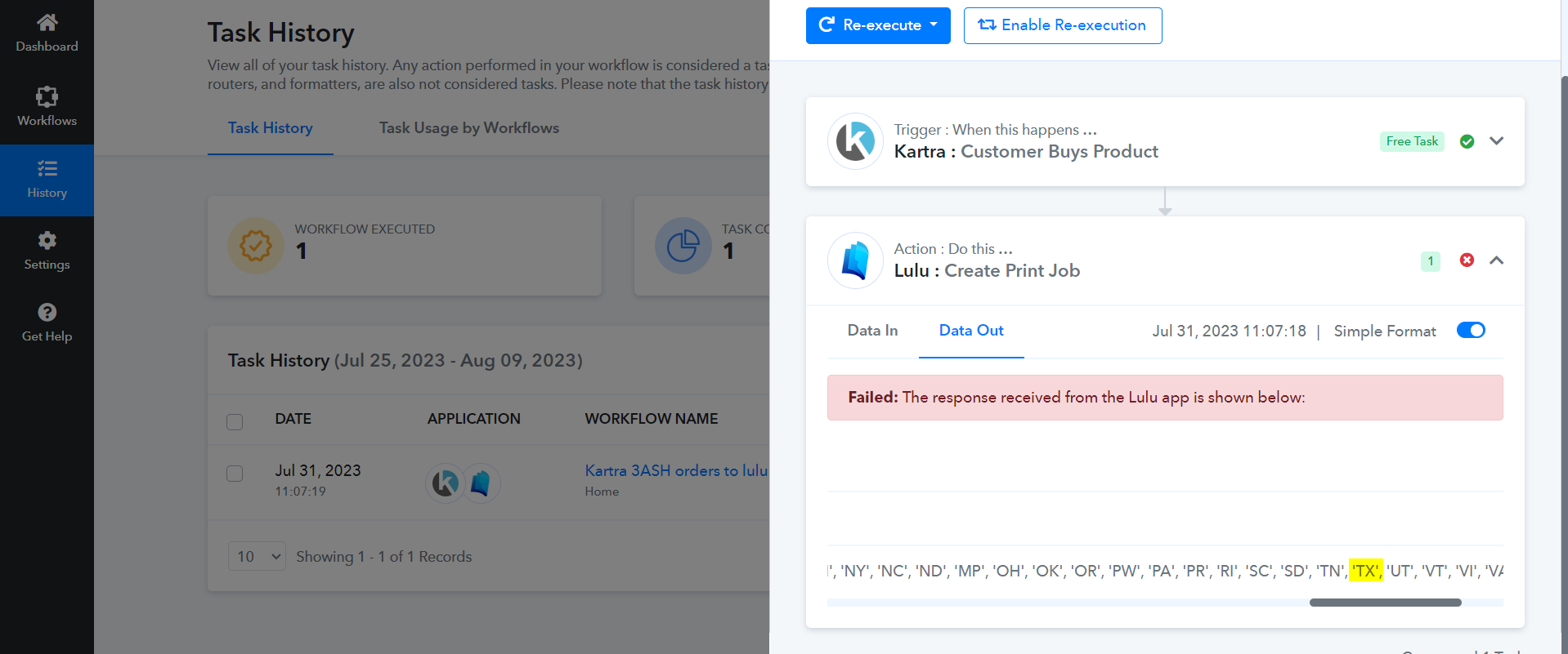

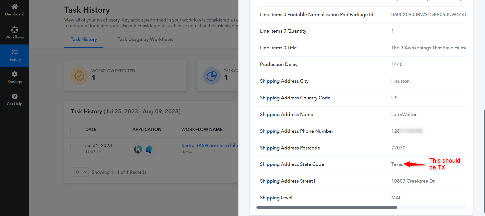

Hi @3Awakenings.
Based on your workflow history, the issue appears to be related to your Shipping Address State Code. Instead of the full name of the state, it should be a 2-3 letter code.

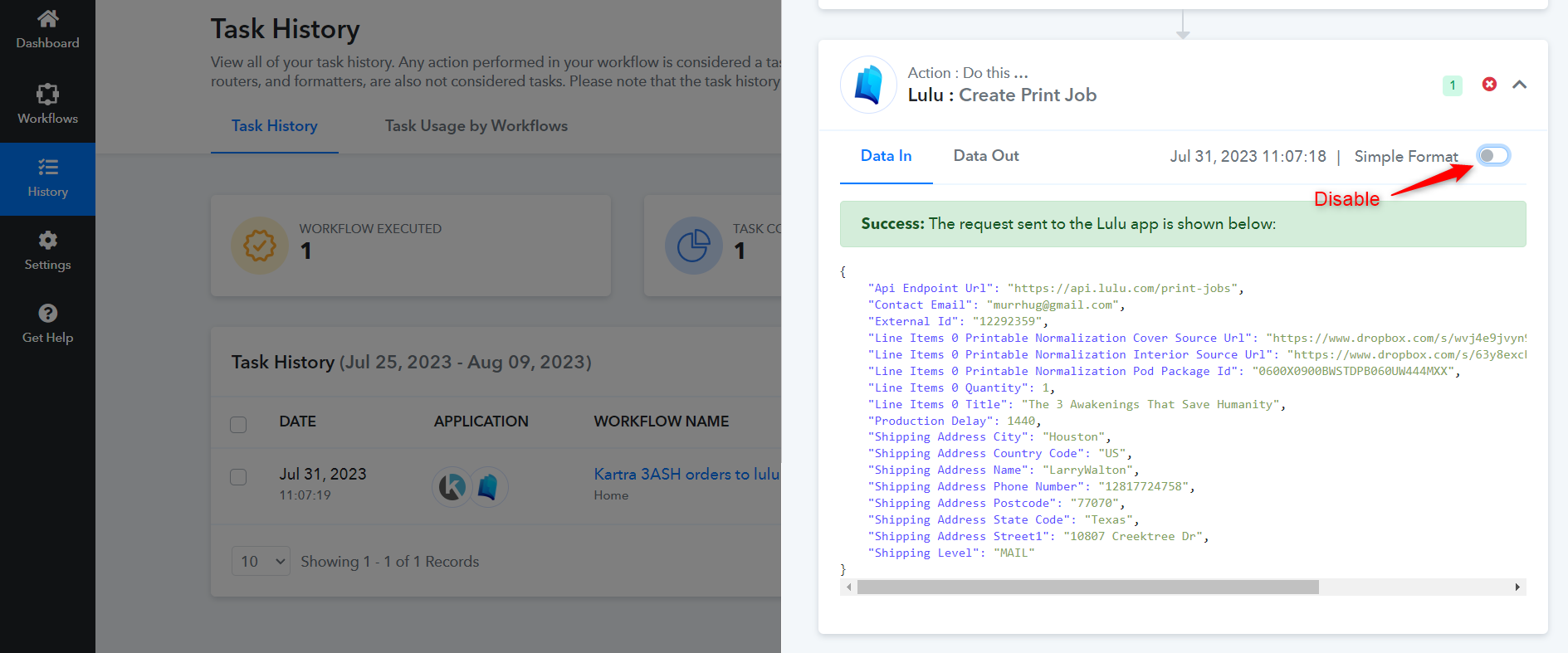

So my questions is, how do I find the JSON payload info, which Pabbly Connect is sending to the end app?
You can find the JSON payload in your task history, by disabling the Simple Format.
