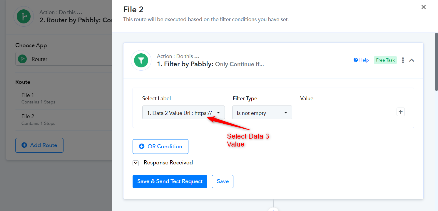

But I think that won't work either. I made a test with another workflow, a simple one with only 4 file upload questions on Paperform, but the result wasn't successful. I'll need to do more testing, but let me get this straight first...
Imagine I have 4 file upload questions: file 1, file 2, file 3 and file 4
I set up a router for each one and a filter inside each router. This way, if user uploads file 1, for example, it will be uploaded to GDrive. If not, it won't execute the upload and won't count that task.
My question is: Will every route execute simultaneously regardless of which files are uploaded? For example, if a user uploads files 1 and 3, or 2 and 4, or whatever, will all "routes" execute or stop (filter) successfully? Because I did a quick test with 4 questions and it wasn't happening. I might've done something wrong, but I didn't think it was possible.
Thanks a lot for responding to my questions.
The router does not execute all its routes simultaneously. The routes are executed from top to bottom. Route 1 will be executed first, and if the file set as a Filter Label exists in your trigger, the file will be uploaded. Then, Route 2 will be executed, and the process will repeat itself. Similarly, all other routes of your router will be executed. Although it could work, we don't usually suggest using the router in the manner you are using it. Make sure you test it a bit before implementing it in your original workflow.
Additionally, I noticed that you used the same label, 'Data 2 Value Url,' in both of your routes. I recommend selecting a label that corresponds to the URL you are attempting to upload.
