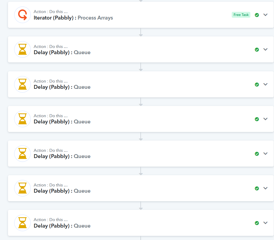

I used "Iterator(Pabbly)" action to loop the Google sheets Rows. However, I found that it started executing the next loop before completing the first workflow. Even I added "Pabbly delay" to the last step action, but it didn't process the delay.

But it will loop the Delay Queue......

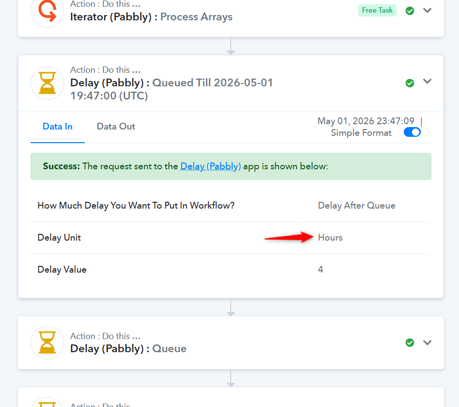

It seems you set the Delay Unit to 4 hours instead of 4 minutes, which is why the action steps after the delay have not been executed. As a result, we are unable to determine the exact issue. We suggest cloning this workflow and executing it with a 4-minute delay instead of a 4-hour delay. This will help us diagnose the issue.

Yes, i want the time interval is 4 hours to process the next loop workflow.
any suggestion?
Hey @gpro,
Thanks for the clarification.
If your goal is to maintain a 4-hour gap between each iteration, then your current setup is working as expected.
Since you’ve added a 4-hour Delay, each item is being queued and processed sequentially after its scheduled delay. Because of this, multiple iterations are now lined up in the queue, which means it can take several hours or even a few days for the entire task history to complete.
So behavior-wise, everything looks correct.
You can keep monitoring the execution to see the queued tasks getting processed over time.
