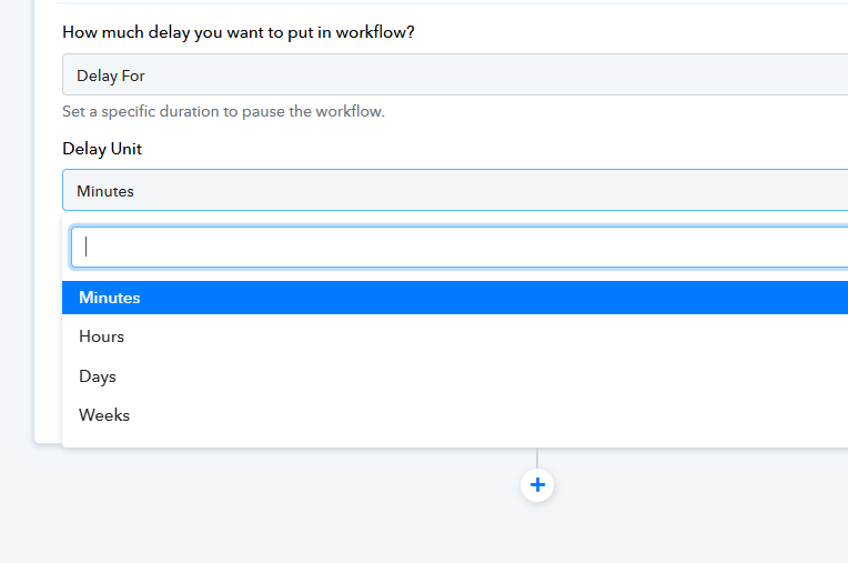

Since I want to send out message by delay 20 seconds per times, how can I setup it by seconds?

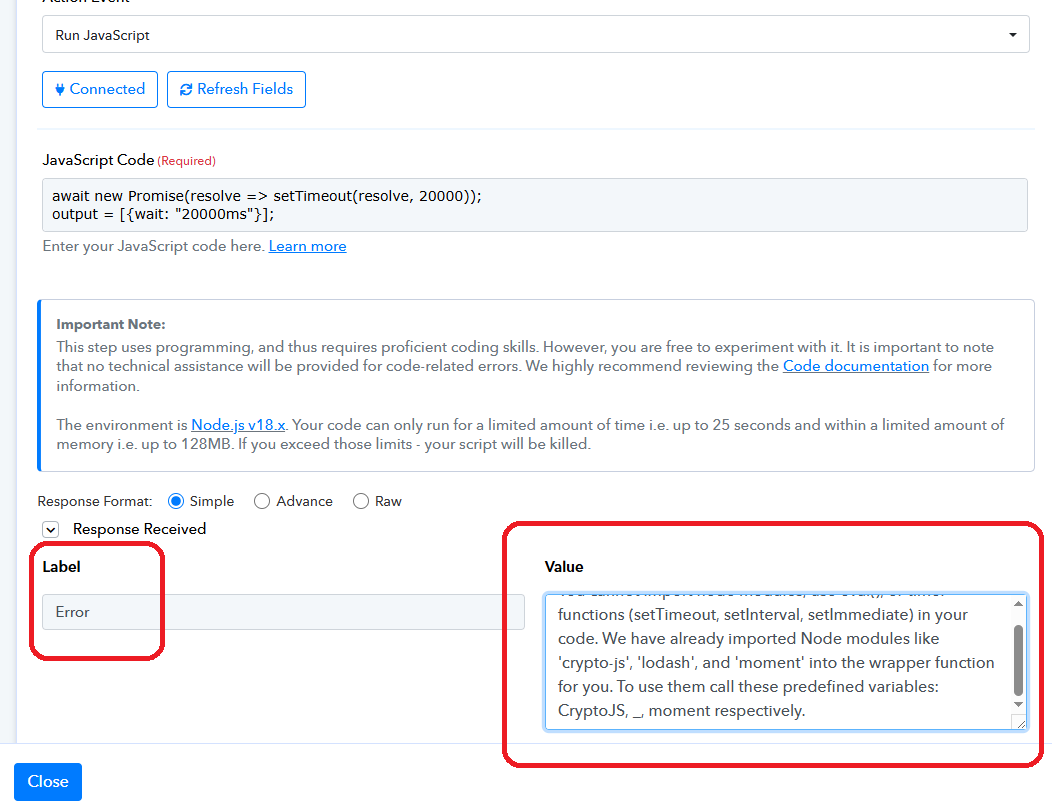

thanks but just can do up to 24 seconds?
Yes, that’s correct. In Pabbly, a request can only wait up to 25 seconds for a response, so any delay should be set below this limit to ensure proper execution.

Hey @gpro,
Unfortunately, adding a delay in seconds is not possible at the moment.

Hey @gpro,
You can use this JavaScript code instead:
const delaySeconds = 20;
const start = Date.now();
while (Date.now() - start < delaySeconds * 1000) {
// wait
output = [{ wait: delaySeconds + " seconds" }];
how can I add Java Script in workflow?

It is not possible to add a delay in seconds using the code anymore. Our team is working on adding the option to include delays in seconds in the Delay module. We will get back to you as soon as this feature becomes available.
At the moment, it is not possible to add a delay in seconds.

any update about delay in seconds feature?
Hey @gpro,
Thanks for following up.
However, currently, this particular feature has not been rolled out yet.
Please note that our team is planning to introduce this feature within the next few months. We truly appreciate your patience until then. Once this feature is introduced, all users will be notified accordingly.
