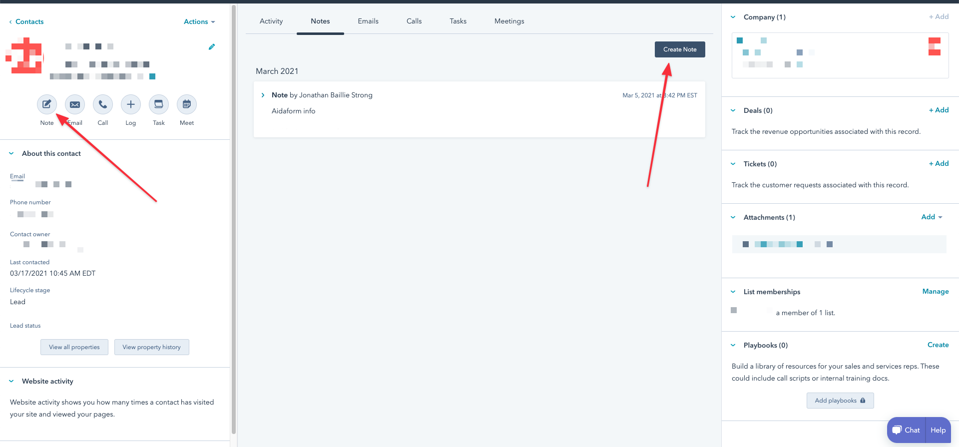

How do we add a note to a contact in Hubspot using Pabbly Connect?

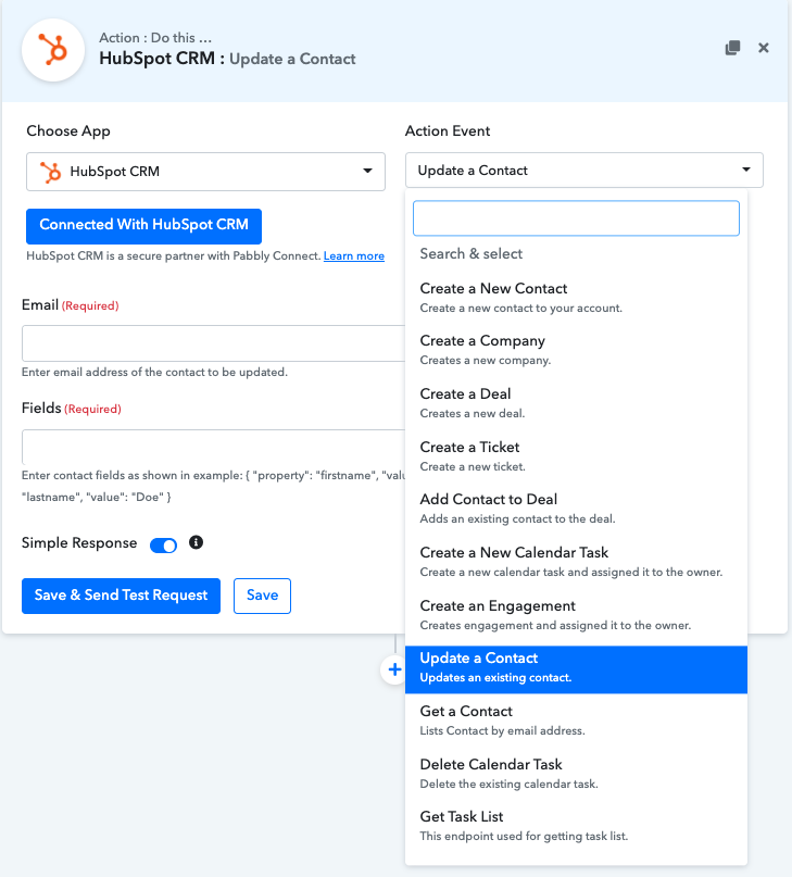

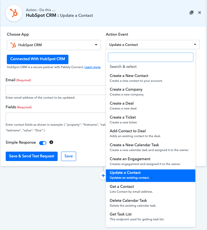

I'm not sure which of these options would achieve what I'm looking for... possibly the "update a contact"? If so, I'm still not sure what the "field" would be called.
Neeraj Agarwal — Reply ·
I checked out the Hubspot API but didn't found a way to add Note to a contact. There is a chance that I might be missing something.
Screenshot below shows all the fields that I found while adding a new contact.

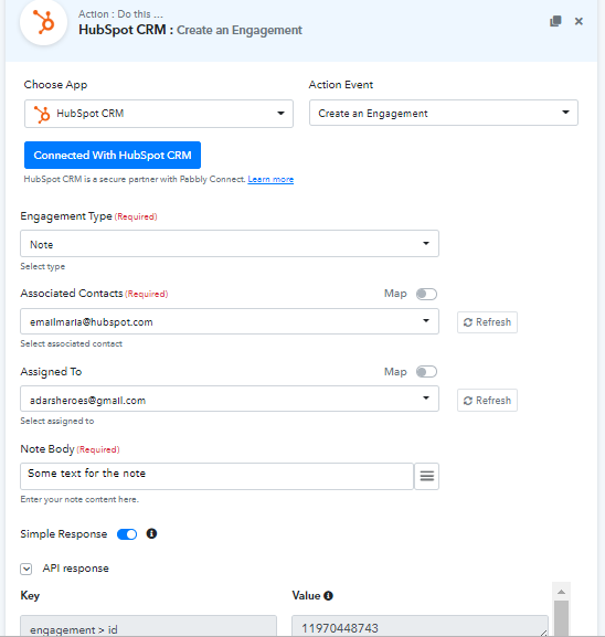

I've realized that actually it's an engagement note that we're meant to create according to Hubspot's API
Pabbly allows us to action an engagement note, however when I tried submitting the above, it returned an API error:

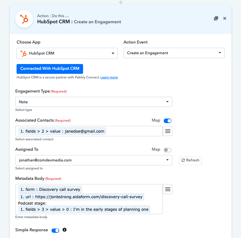

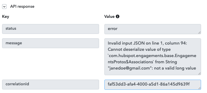

Thanks! This seems to have fixed something.
The problem I am running into now is that in the "associated contacts", the action only seems to accept a subset of the contacts I currently have in Hubspot. When I try to add a not to a recently created contact, I receive this error:
I'm not sure what the criteria for "associated contacts" is...

One thing I notice is that the only contact that I'm able to successfully map the "associated contacts" to were created before mid 2019. I'm unable to map any of my contacts created after that time. This would seem to indicate that the API configuration is out of date?
PabblyMember3 — Reply ·

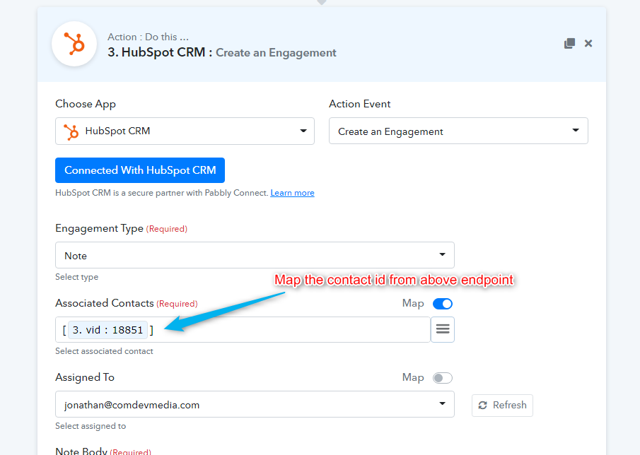

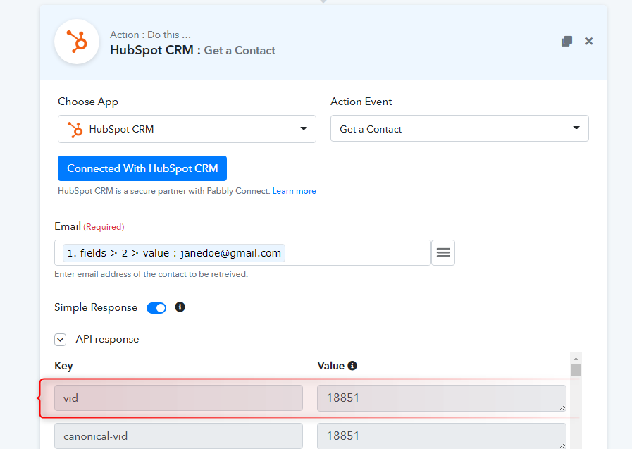

I just checked with my team and found that, you were mapping the email instead of Contact Id (vid) there.
Please follow these steps:
1. Get a Contact by Email, here you will get the Contact ID (vid) in response.
2. Map the vid in Create an Engagement action within the square brackets as shown in the attachment.
Hope that helps.

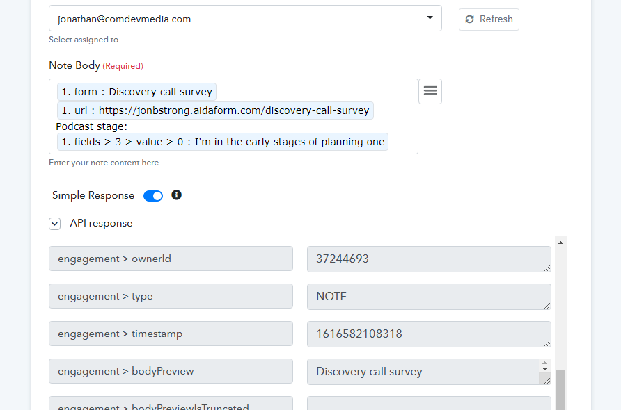

Jonathan Baillie Strong — Reply ·
OK that worked! It took a while, but we got there in the end :)
