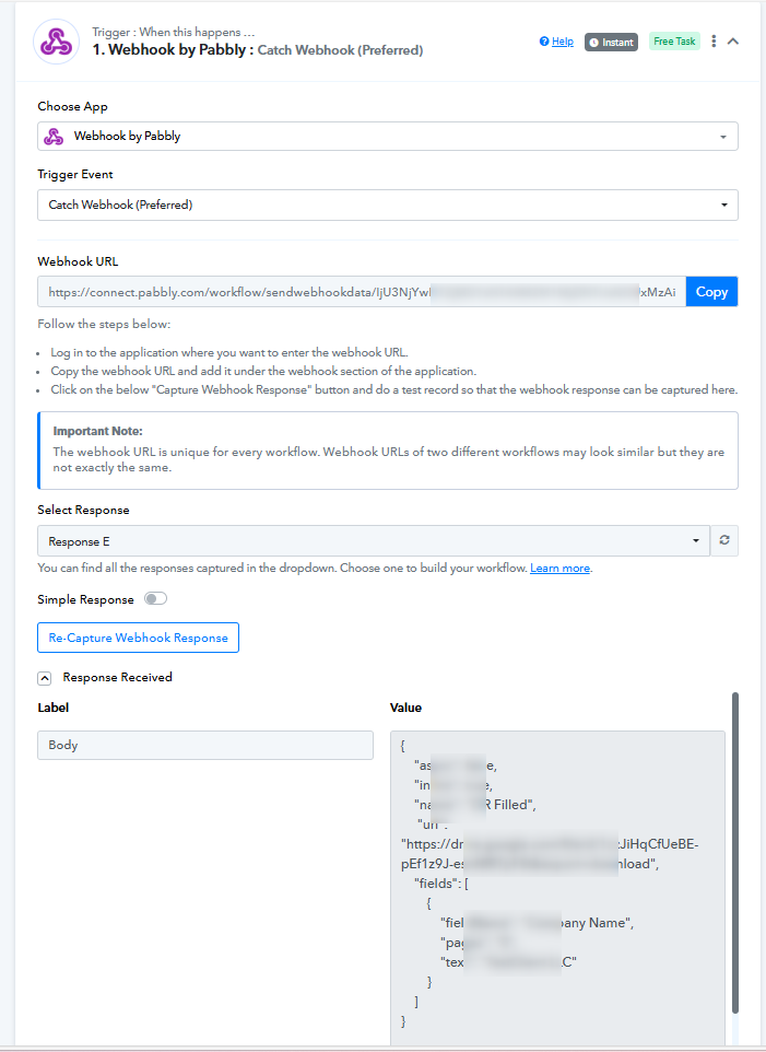

Hello @corprodoc
While checking your workflow "PDF Fill Form", we found that the trigger application's response contains only a single object in the JSON response. To proceed further, please capture a response that includes multiple objects so we can review it properly.
Additionally, kindly share your exact use case and let us know where you have added the webhook URL.
