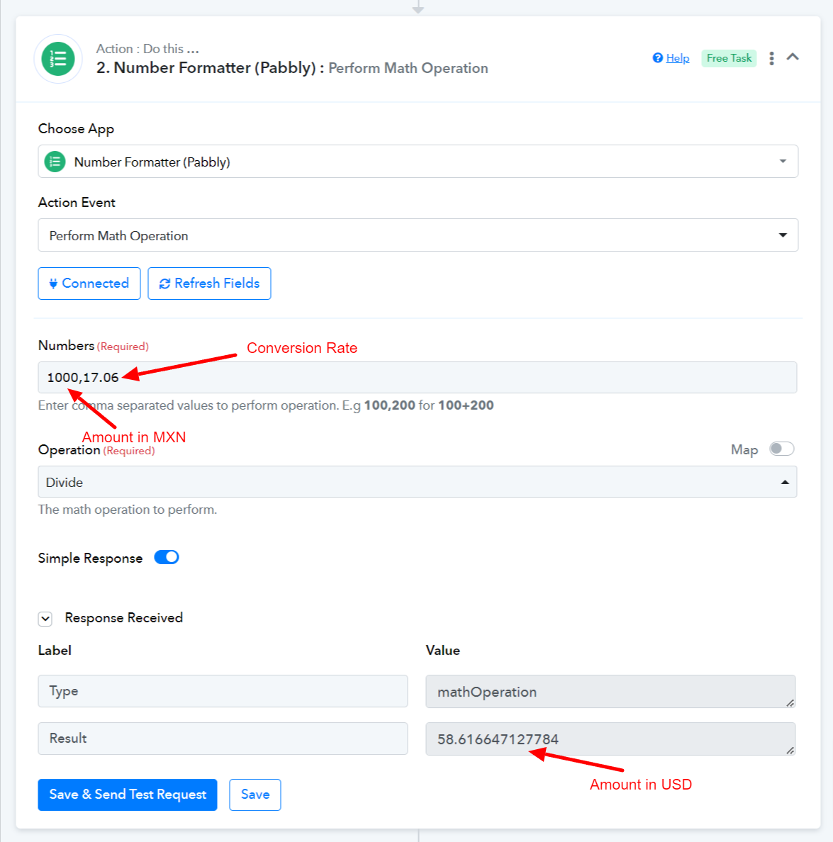

I've created an automation to automatically input information from different systems into Wave accounting every month. One charge comes in a different currency (MXN), and I need to convert it to USD before entering it into Wave. What would be the best way to accomplish this with Pabbly?
Thanks so much!
ArshilAhmad
Hi @gregv,
Currently, we don't have a direct tool that can automatically convert MXN to USD. As a workaround, you can utilize the Number Formatter and perform mathematical operations to convert the amount from MXN to USD.

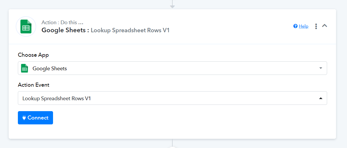

Hi @ArshilAhmad , I came up with an idea. Google sheet has the latest rates available. Would pabbly be able to pull the data from a Google sheet and use that? Would it update the sheet so it pulls the latest?
ArshilAhmad
You can use the 'Lookup Spreadsheet Rows' action event to fetch the rate from your Google Sheets spreadsheet (it will be latest data), and map that rate in the Number Formatter.
