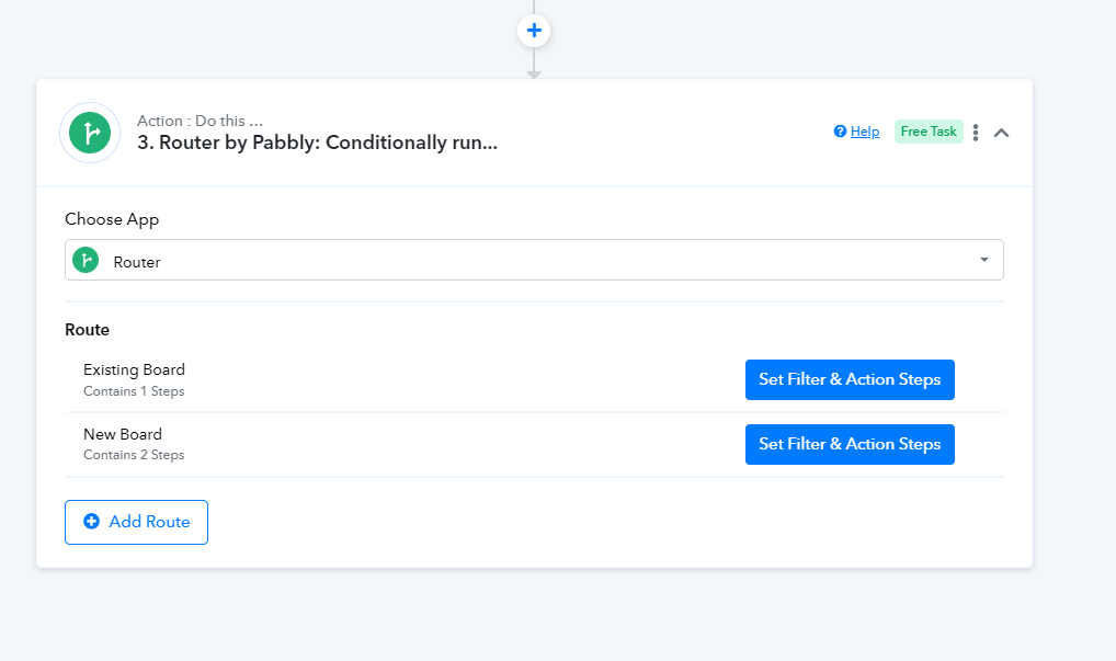

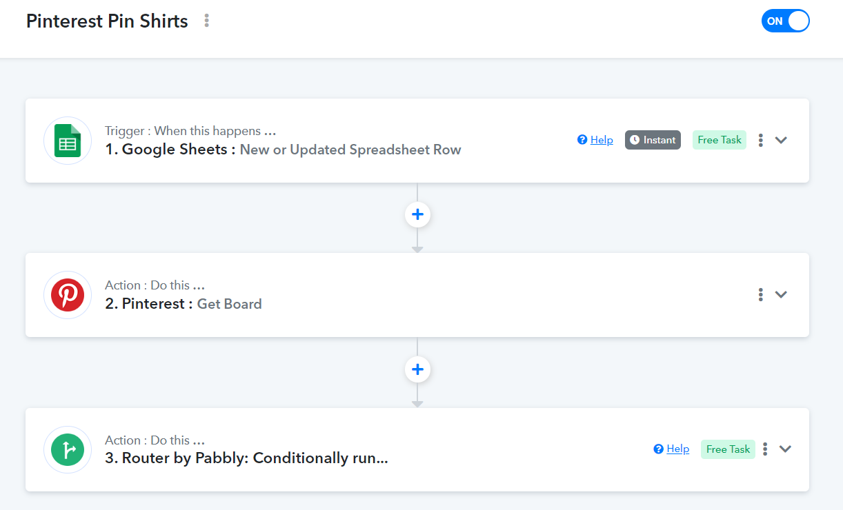

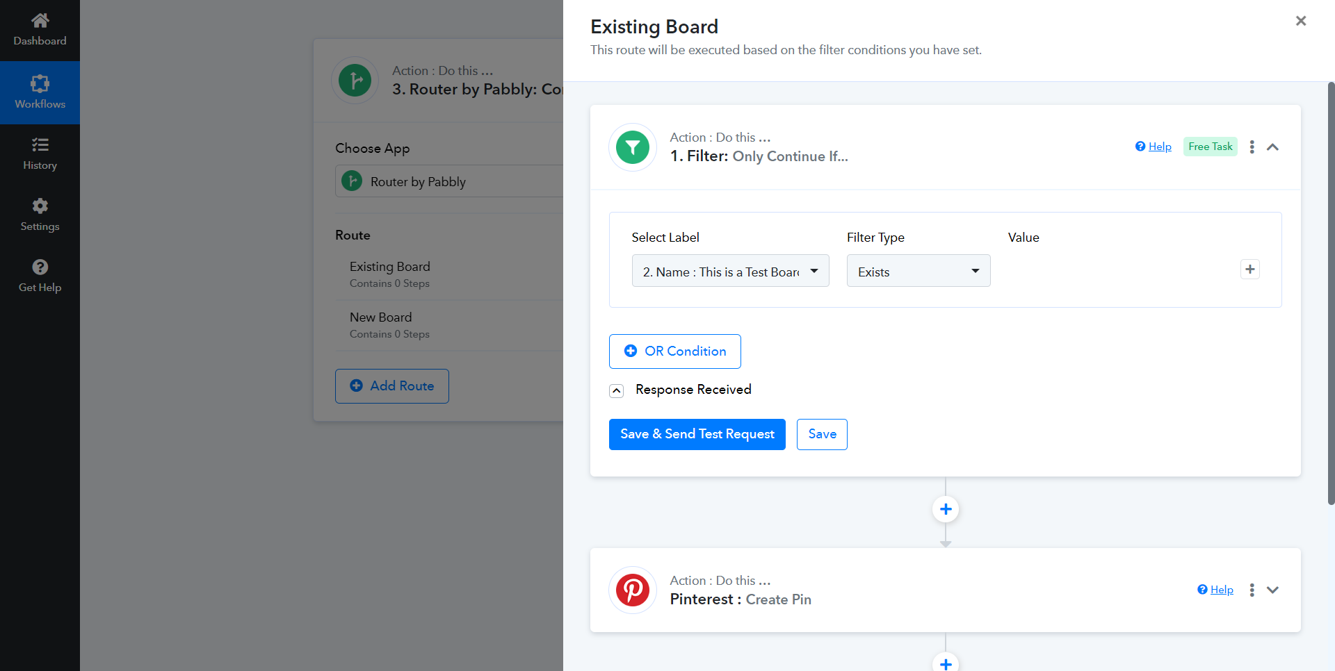

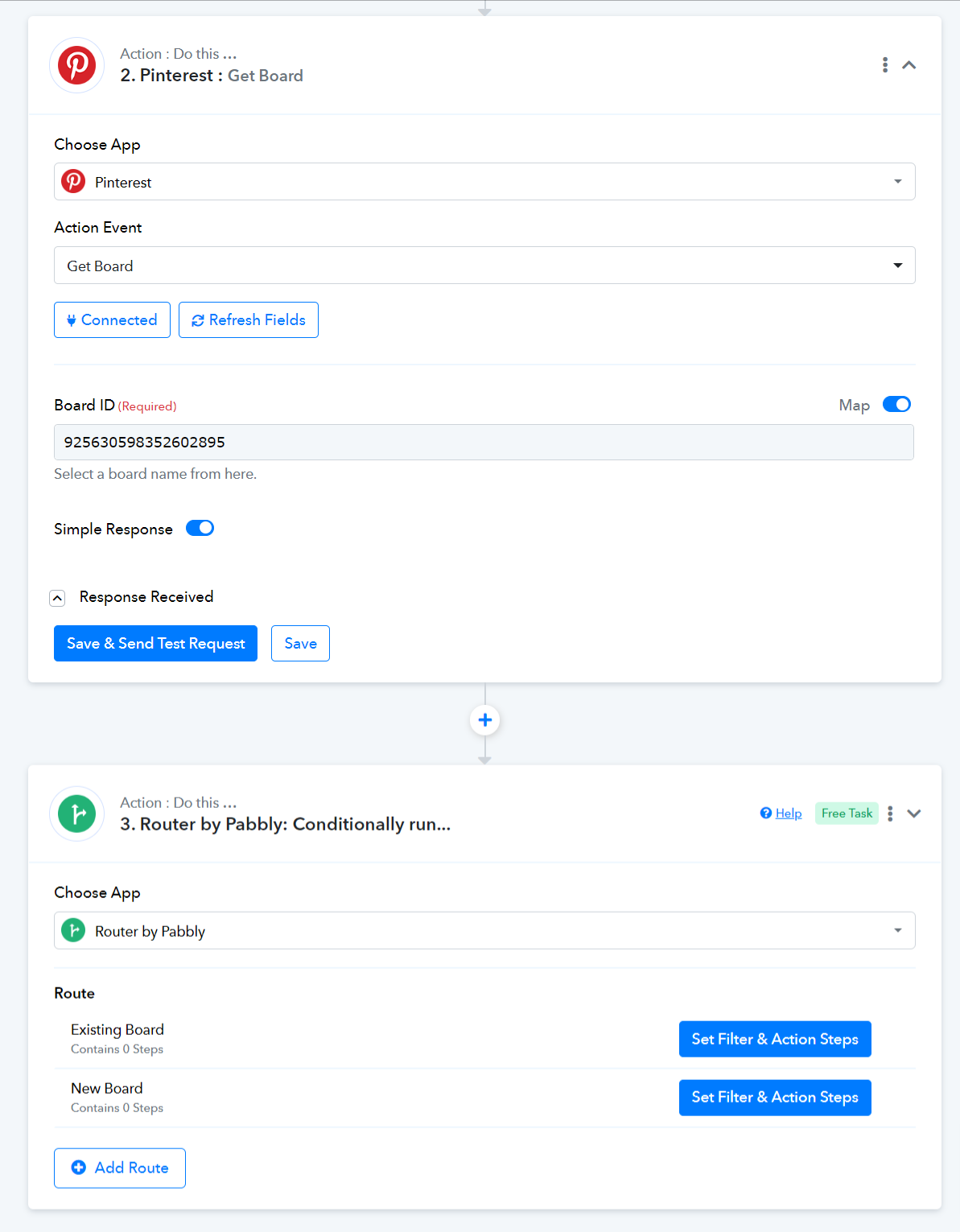

I will post the screenshots of the whole workflow. Maybe this helps to find the issue here:

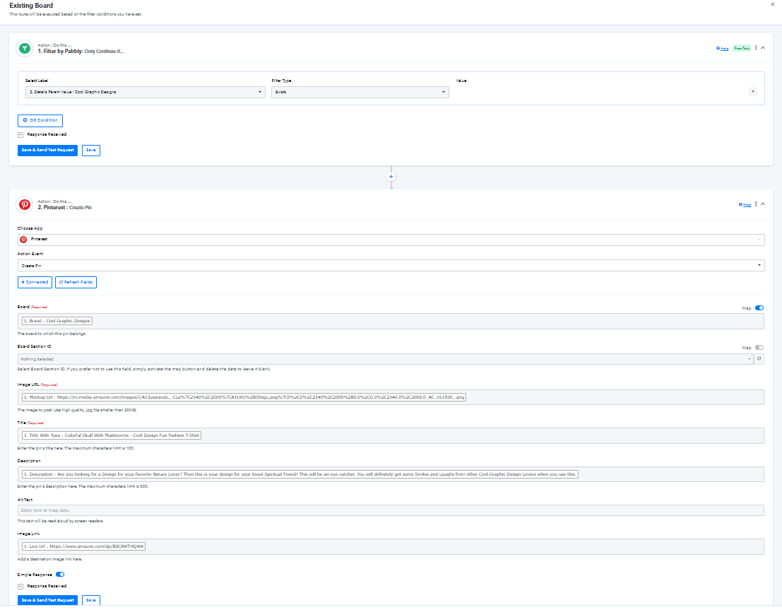

And the two router options look like this:

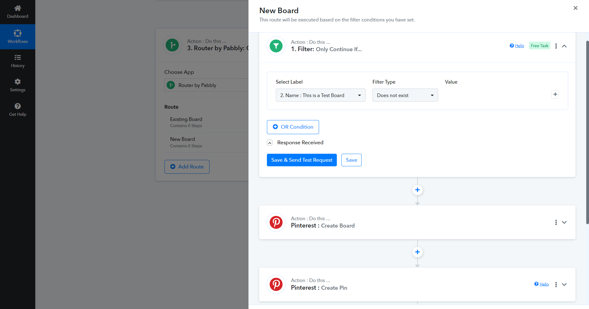

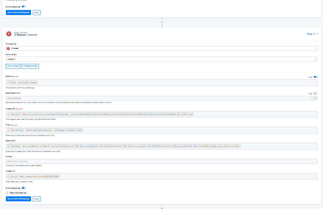

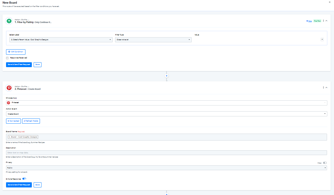

Second router (new board):
Would really appreciate the help.

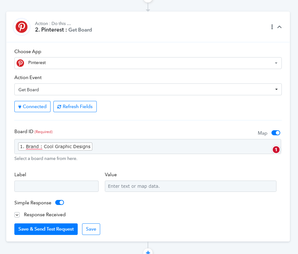

In the 'Pinterest: Get Board' action step, you are supposed to map the Board ID instead of the name of the board. You can find the Board ID associated with each of your boards by enabling the mapping button.
https://drive.google.com/file/d/12OlL40pgbc-Lw2Tdh1fmBdfHx8MJc02D/view?usp=sharing
For your use case to work, you need to get these Board IDs from your Google Sheets spreadsheets.
KaizenSEO — Reply ·
Well, that is the problem. This must be dynamic as I don't know the board ID yet.
I don't want to use any random board. Rather I want to create a new board or use an existing board if there already exists a board with the same name. The Name for the board should be pulled from column A in the Google spreadsheet.
That's why I created the router in the 3rd step to either use an existing board or create a new board.
There is a workaround for this, but it requires you to create a new spreadsheet and manually enter the Board Name along with its Board ID.
Afterward, you can use the 'Lookup spreadsheet' function to retrieve the Board ID associated with the Board Name.
youtube.com/watch?v=_2zfrxZ4C-U
Once you obtain the Board ID from the 'Lookup' step, you can then map that ID to the 'Pinterest: Get Board' action step.
