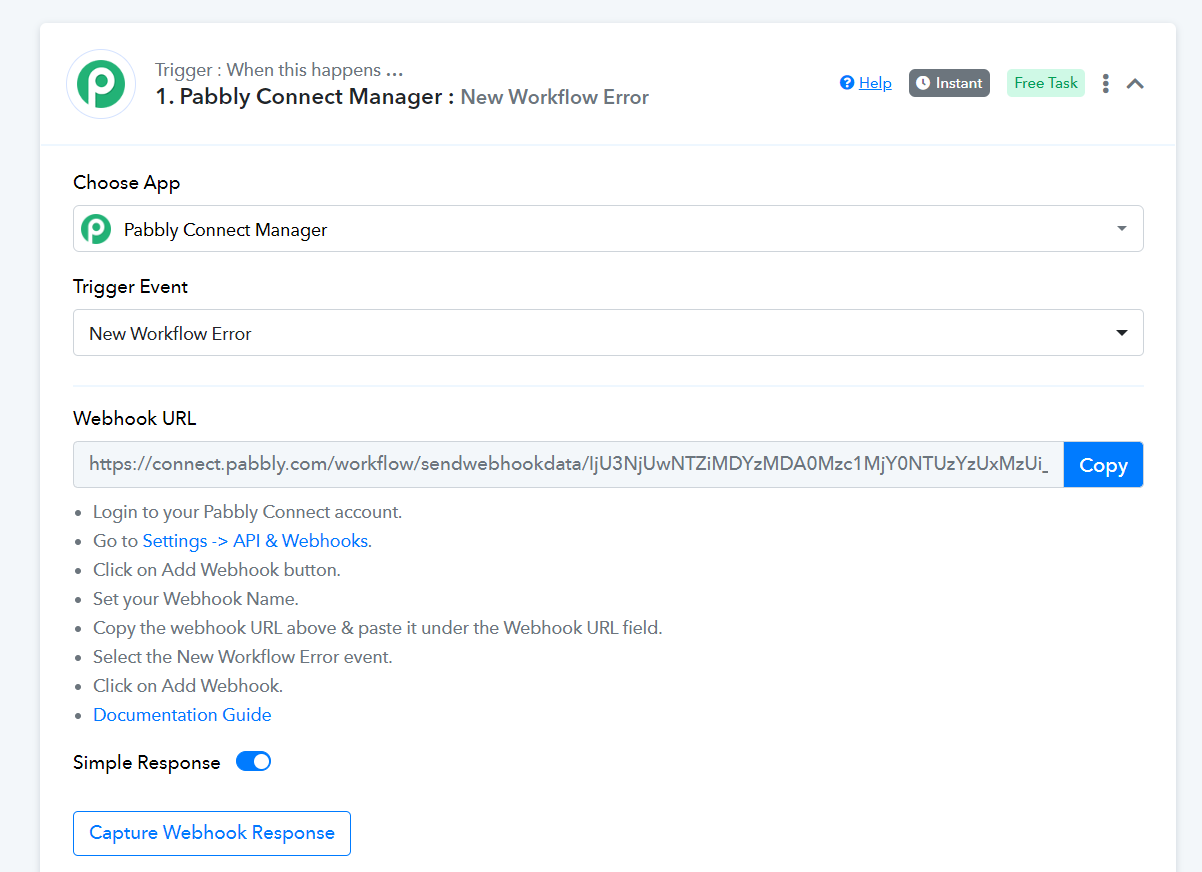

You can set up a new workflow with 'Pabbly Connect Manager: New Workflow Error' as your trigger step. This workflow will be triggered every time there is a failed step during the execution of any of your workflows. Along with this, you can use Gmail as your action step to send emails.

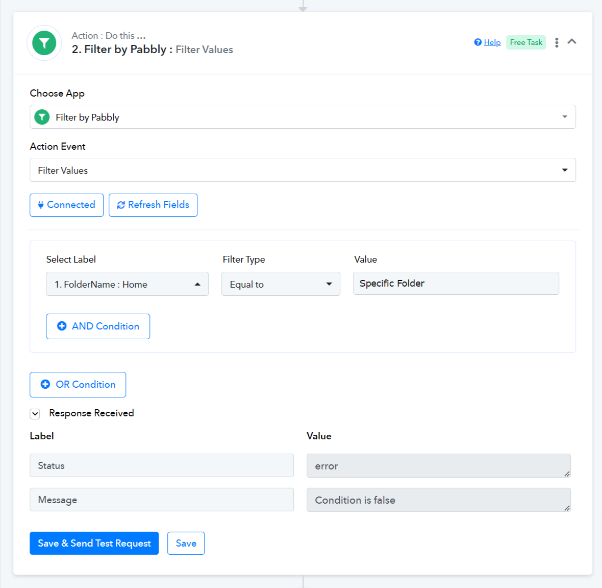

For that, you can add a Filter as Step 2 of your workflow. This will ensure that the Gmail step is executed only if the workflow is triggered for an error in a workflow present in a specific folder.

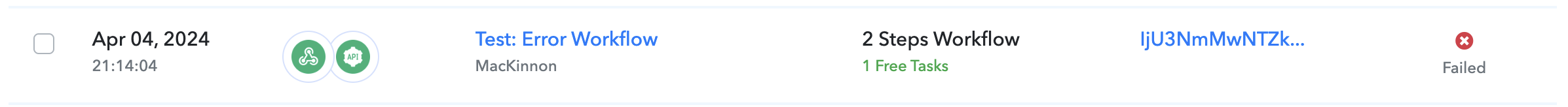

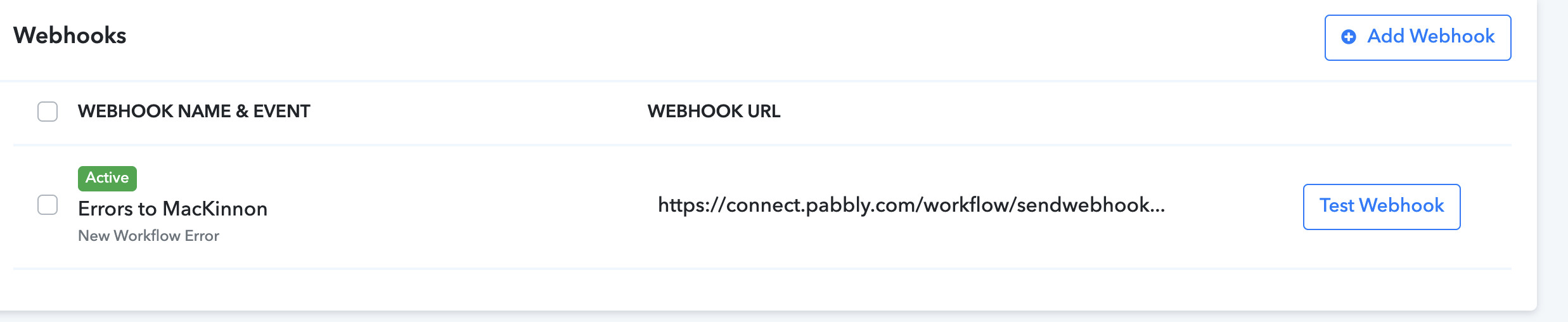

1. I can't seem to make the error trigger even though I have added the Webhook to settings in Pabbly, activated it.
This is my Pabbly manager workflow.
it does not seem to trigger even when I trigger it by causing this error:
https://connect.pabbly.com/workflow/mapping/IjU3NjUwNTZiMDYzMDA0MzI1MjZhNTUzNTUxM2Ii_pc. which sends to this: https://connect.pabbly.com/workflow/mapping/IjU3NjUwNTZiMDYzMDA0MzI1MjZhNTUzNTUxMzYi_pc
And fails
But still I get no response from the Pabbly Manager Workflow.

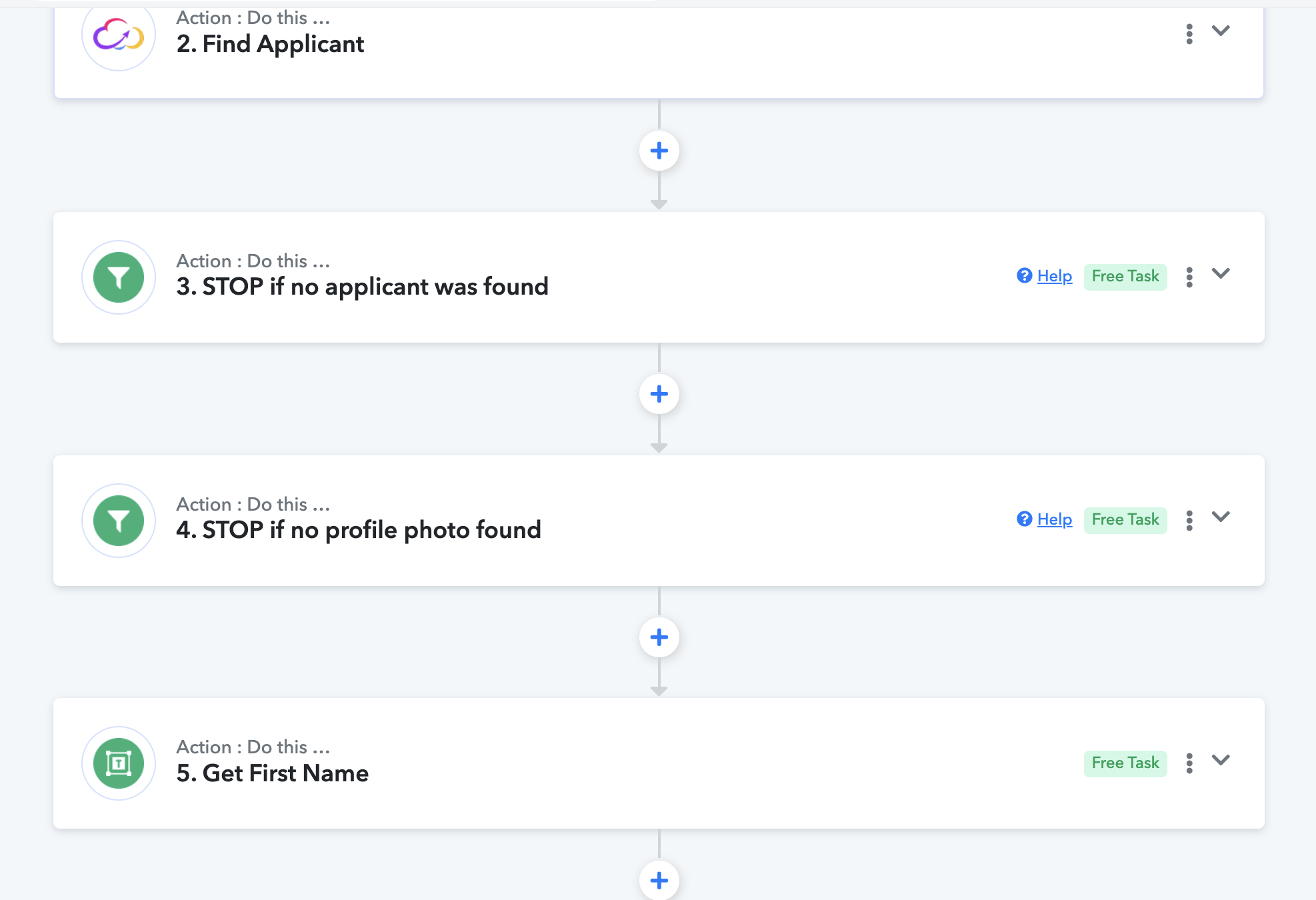

About number 2. actually I have my flows setup like this:
What I would like to do is to send an alert whenever the flows stops at one of these filters, because then the user would know that they haven't provided what's required. Eg. if it stops at step 4, I would like to email them that "4. STOP if no profile photo found" did not complete - so they know they have to add a profile photo. How can i do this? And can I somehow restructure the workflow to make it so that I can provide this info as the workflows stops?
You can set up a Router action step with separate routes. These routes can be used to filter conditions where missing data, such as the profile picture or other information, can be processed within the route and a notification can be sent.

Our team suggests that you try creating a new workflow. Set up Pabbly Connect Manager as the trigger step in this new workflow in a similar manner to what you did previously, and see if this new workflow captures the errors.
