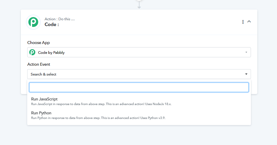

Hey @bonordlin
You can make use of the Code by Pabbly action step to break the JSON into two parts or more. With the help of OpenAI, you generate the code accordingly.
