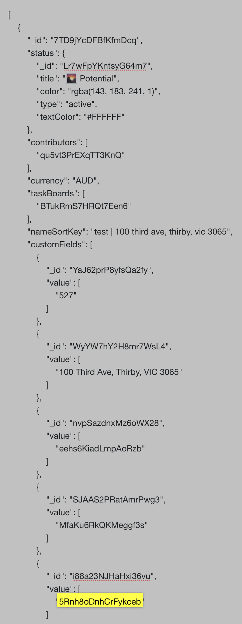

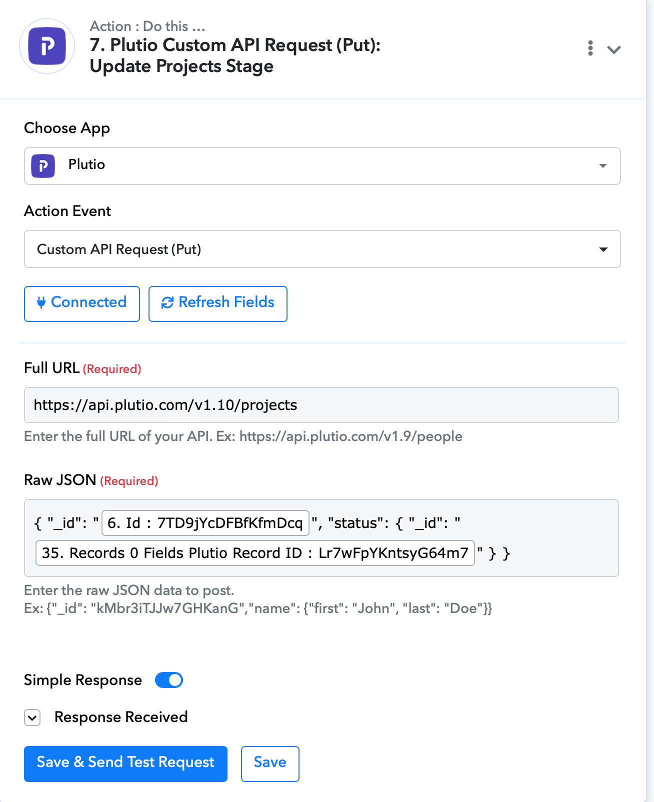

How to add the highlighted value into the Pabbly Connect Raw JSON existing formula?
This Pabbly formula (and desired amended update) relates to Plutio (PM SaaS) 'Projects' whereby it will update the Project Status (currently working) and add/update the 'Current Step' (highlighted in yellow), of which I am stuck with the correct JSON structure and insertion??

Hey @Mmmk
In Plutio's Custom API request, you need to pass the custom fields and their value in an array as mentioned below.
"_id": "7TD9jYcDFBfKfmDcq",
"customFields": [
"_id": "Put the custom field's ID here",
"value": [
"Put the custom field Value Here"
Mmmk — Reply ·
Hey @Mmmk
"customFields": [
"value": [
Thanks soooo much. Worked. Was so excited to try it out and was the first thing I did when I woke up!
