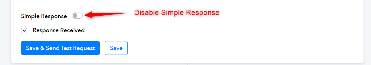

Please check out the video shared below; it may help you receive the response in a structured format. Make sure to disable 'Simple Response', then capture the data.
youtube.com/watch?v=kkE42z6wC1Y

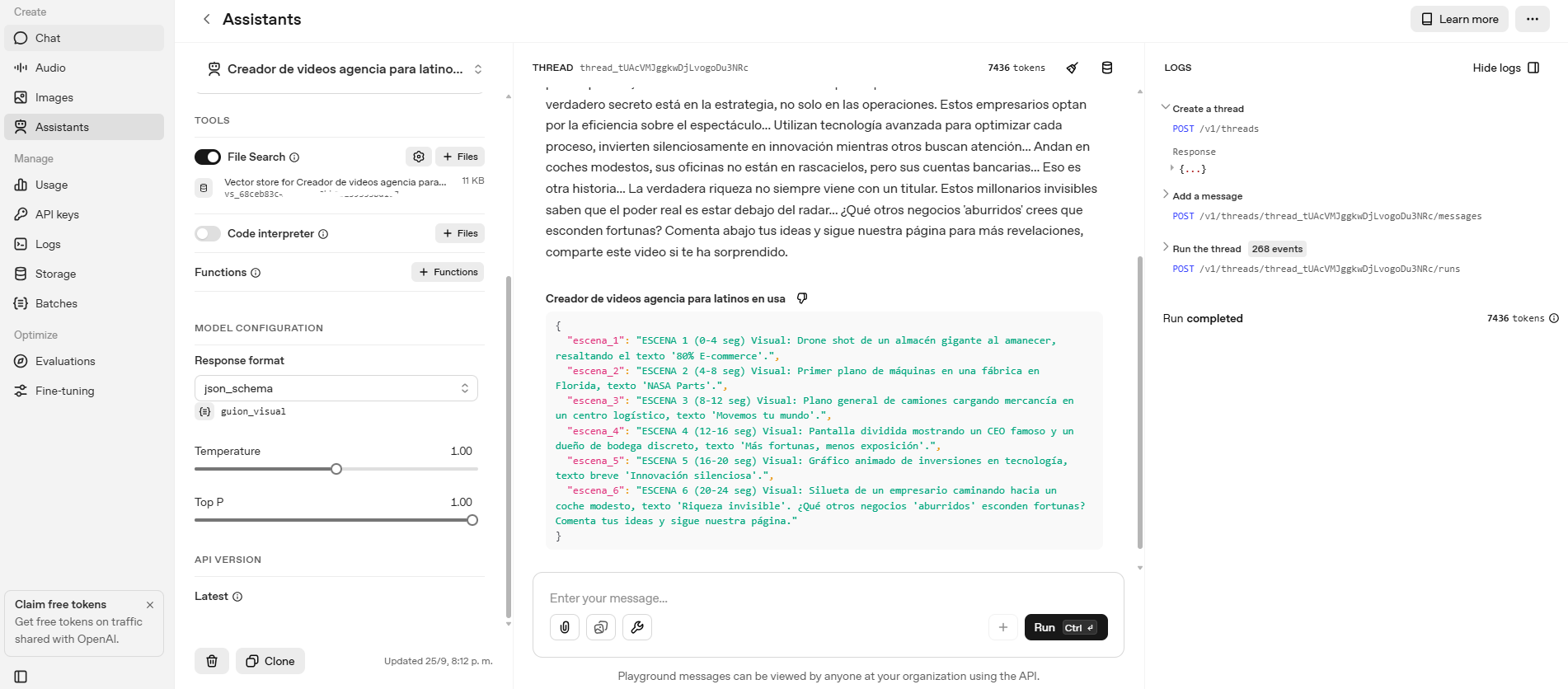

Thank you, Arshil, for the tutorial, but the interface has changed. I assume I now need to do this with 'Assistants,' but I don't see the 'Code' button (the step in the video at 7:50). Where can I find the JSON schema to copy and paste into Pabbly Connect?

1. ChatGPT (Advanced) Setup and Response
I successfully configured ChatGPT to enforce a strict output structure using the response_format with json_schema.
The response from ChatGPT is a perfect JSON object containing an array named escenas:
JSON
Choices: [{"index":0,"message":{"role":"assistant","content":"{\"escenas\":[\"ESCENA 1 (0-4 seg) Visual: A clock alarm ringing in the morning, with a ray of sunshine entering through the window.\",\"ESCENA 2 (4-8 seg) Visual: A tech leader sitting at his desk, writing in a notebook with a smile.\",\"ESCENA 3 (8-12 seg) Visual: Graphs on a screen showing a 20% increase in productivity, with happy employees working.\",\"ESCENA 4 (12-16 seg) Visual: A CEO meditating on a factory rooftop as the sun rises, surrounded by tranquility.\",\"ESCENA 5 (16-20 seg) Visual: An image of a scale showing clear decisions and money, symbolizing the millions saved.\",\"ESCENA 6 (20-24 seg) Visual: A logistics entrepreneur reviewing a list of daily goals, with a relaxed and smiling team around him.\"]}","refusal":null,"annotations":[]},"logprobs":null,"finish_reason":"stop"}]
