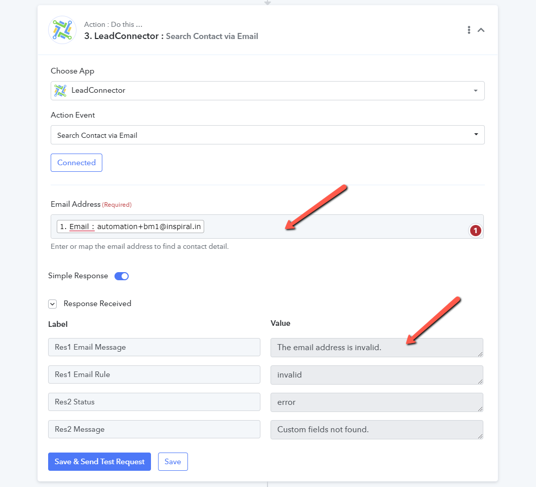

can you pls help how to format the email result from the pulled-out results from the previous step? Check attached screenshot

Thank you for your response but I dont think that would work as I need to use the search contact via email first to pull out the contact ID and other lead details using the webhook email result. The problem with the leadconnector action, when I test the search contact via email, it says 'The email address is invalid.'.

Hi again Arshita, I was able to sort out the issue.
