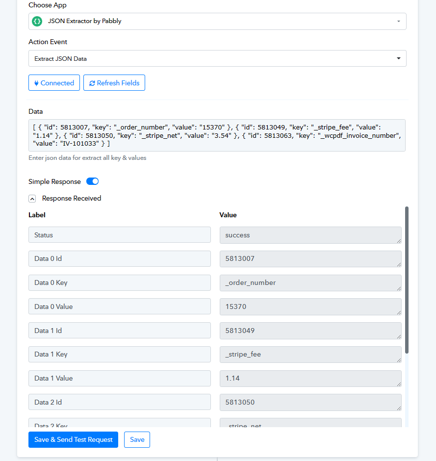

Hey @davidw
To convert the JSON array in the response into key-value pairs for use in another action step, please use the "JSON Extractor by Pabbly" action step.

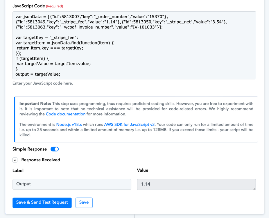

Thanks, but I can't use this method because the array may not be the same length or in the same order every time. I figured out a JavaScript method. When the code is inline, it works:

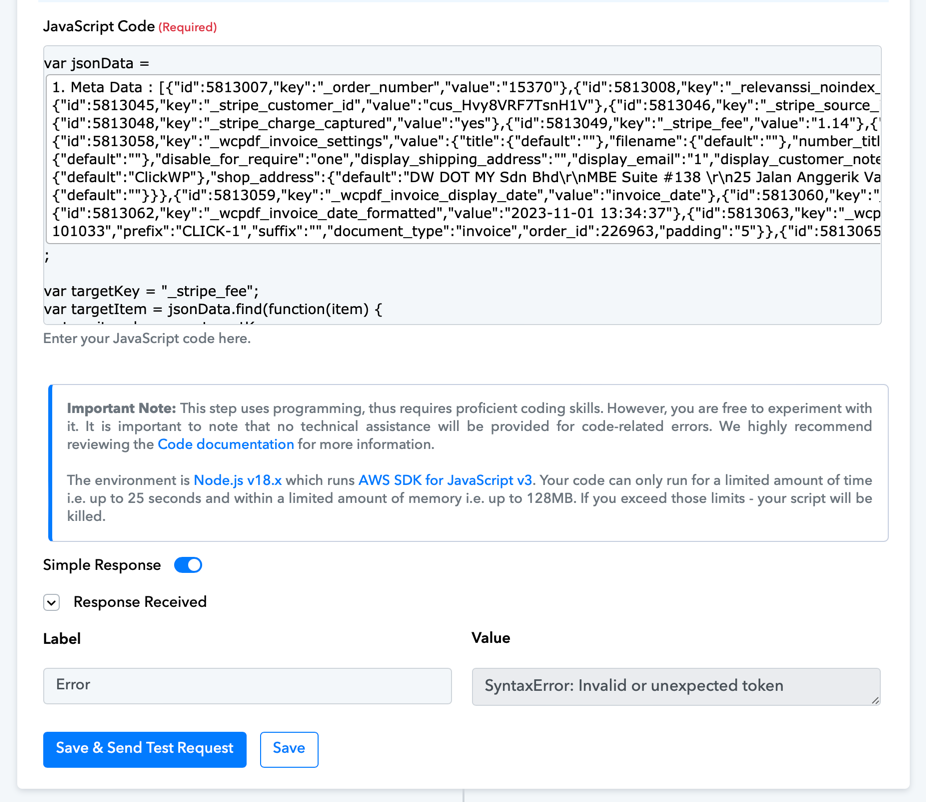

But when I replace the JSON with the variable from the previous step I get an error:
Why is there a difference with the 2? The only difference is I have substituted the JSON object with the token from the previous step.
