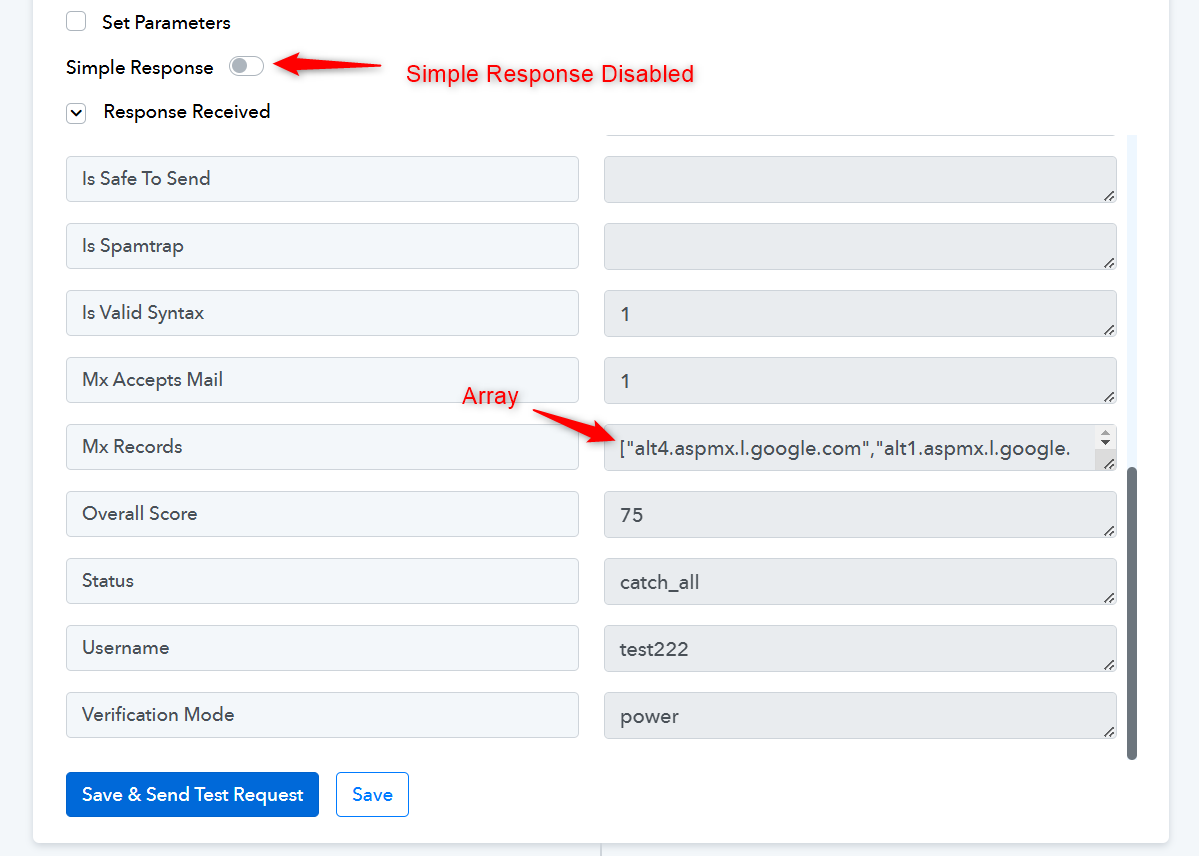

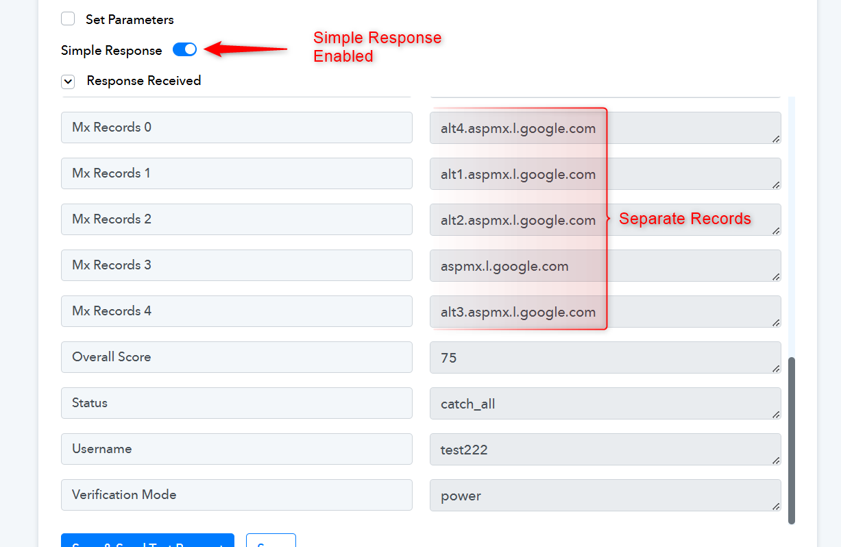

Hi @nicheweb,
Based on the Workflow URL you shared, we can see that you receive separate records when the 'Simple Response' is enabled.
When the 'Simple Response' is disabled, you receive the records in the form of an array.

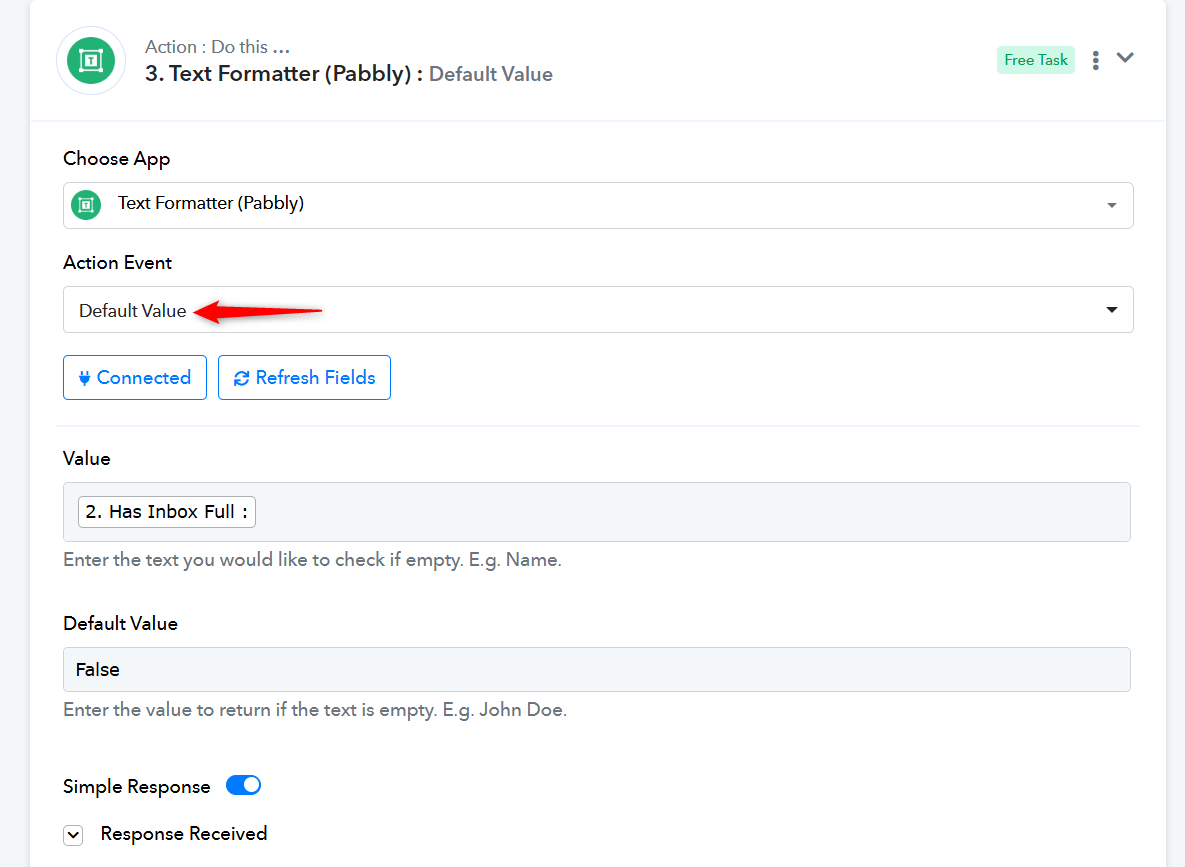

I'm talking about the entire thing as a JSON response like when I send the request in postman and if you enter my API URL into a browser. The JSON response returns true and false for results and when Pabbly is returning them and splitting them into individual fields it's not retaining the false record and it looks like it is Null.
Here is how the response looks in postman and by entering it into the URL bar - https://gyazo.com/5977c0209217f646f272e0ff78231cbf
Currently, it's not possible to get the JSON in raw form, even with the simple response disabled. You can try using the 'Default Value' action event to get the value as 'False' instead of an null value.
