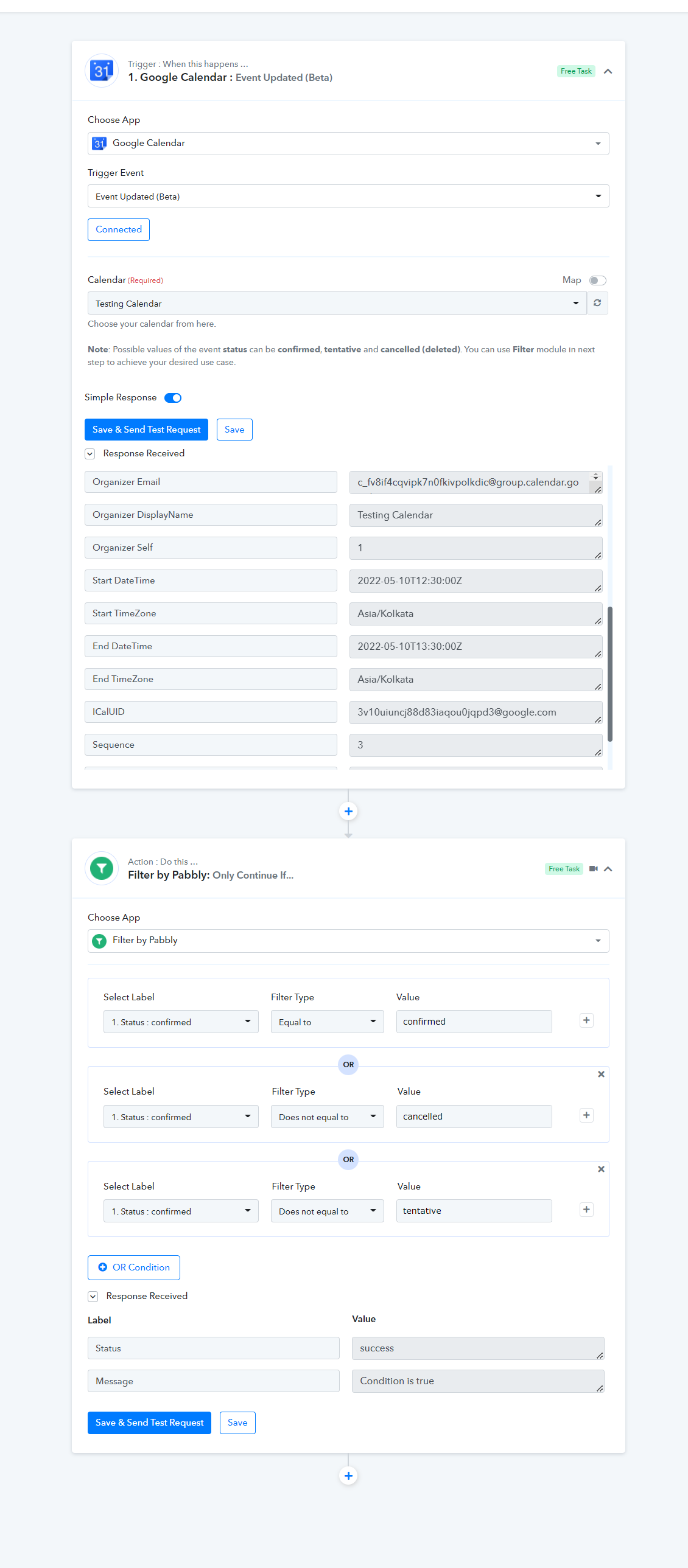

Hey @aristosv
If the admin of the calendar makes any update in the Calendar then you can use the "Google Calendar: Event Updated (Beta)" trigger event to receive the updated time of the event. Further, you can use the filter action step to avoid the events which will get tentative and canceled (deleted).
Please check out the following screenshot for your better understanding.
