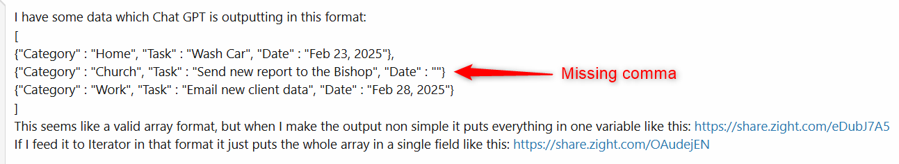

I have some data which Chat GPT is outputting in this format:
{"Category" : "Home", "Task" : "Wash Car", "Date" : "Feb 23, 2025"},
{"Category" : "Church", "Task" : "Send new report to the Bishop", "Date" : ""}
{"Category" : "Work", "Task" : "Email new client data", "Date" : "Feb 28, 2025"}
This seems like a valid array format, but when I make the output non simple it puts everything in one variable like this: https://share.zight.com/eDubJ7A5

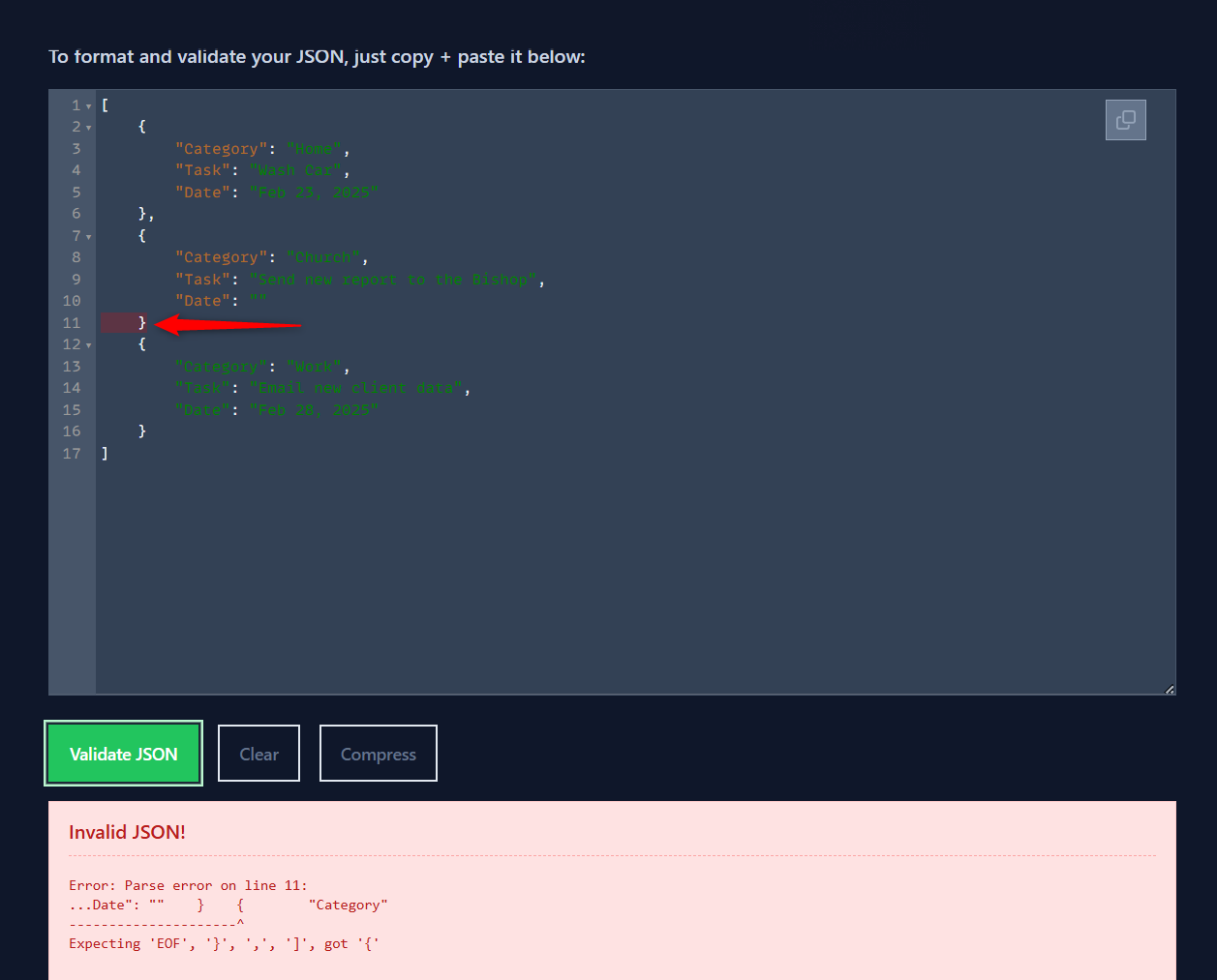

Hi @meltingsand,
Also, the output you shared appears to be missing a comma, which makes it an invalid JSON.

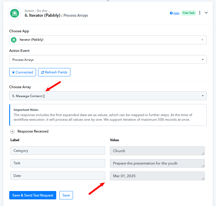

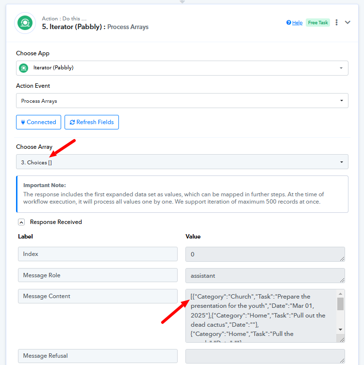

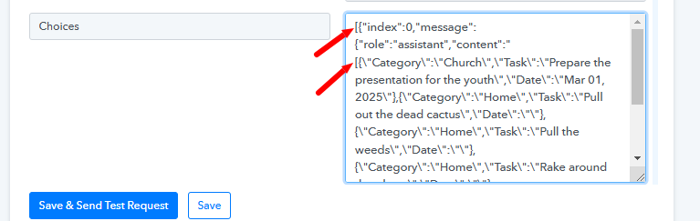

Hello @meltingsand,
Upon reviewing, we noticed that the ChatGPT response contains nested arrays. An Iterator was already added to process the array received from the ChatGPT step. To further refine the handling, we have now added another Iterator to map the required array from the previous Iterator's response.
Please refer to the attached images for more details. We recommend running a few tests after verifying the mapping of all steps. Let us know if everything works as expected.
