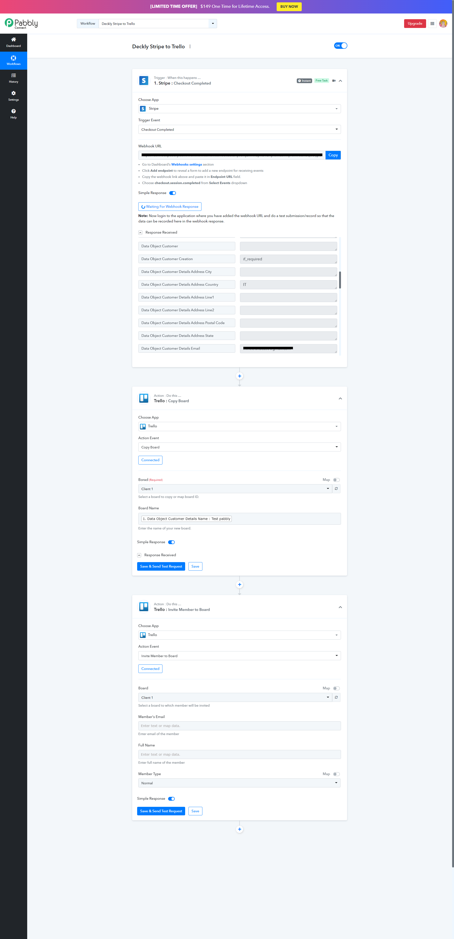

So the workflow looks like this
Client successfully completes checkout on Stripe --> Trello copies an existing board --> Trello invites the client through email to the board just created (the copied one)
See the attachment for a visual representation
However, there isn't an option on Pabbly to invite the member to the board just created.
Is there a way to do this?
Thanks.

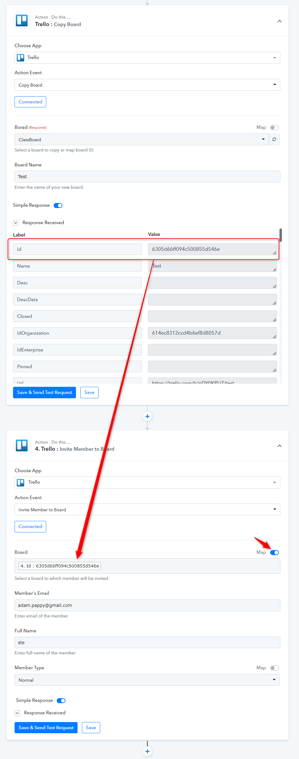

Hey @deckly
You have to map the copied board Id from the API response to the Board Field in the "Trello: Invite Member to Board" action step.
Please refer to the following screenshot for your better understanding.
