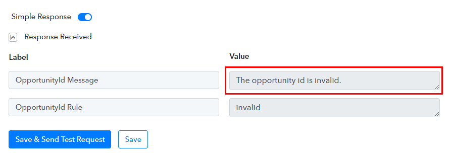

I am getting an error as opportunity ID is required. Here is the screenshot for your reference.
Please clarify how to map this opportunity ID and help at the earliest.

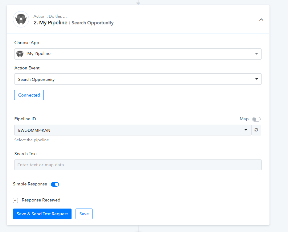

As we can see you have passed the Mac id in the Opportunity Id field instead of Opportunity Id. Kindly use the "Search opportunity" action to retrieve the Opportunity Id from the live execution.
Also, make sure while retrieving an opportunity from the Pipeline there should be an opportunity present.

Hello Supreem,
In the video that I have shared, Pabbly person has selected UPDATE OPPORTUNITY in the second step and you are suggesting me to select search oppotunity.
Kindly check that video and help me understand how it works.
If I select search opportunity then there are many fields that are to be mapped so I need help with respect to that as well. If you can share any detailed video or screenshot of the process then I can follow the same and get it done.

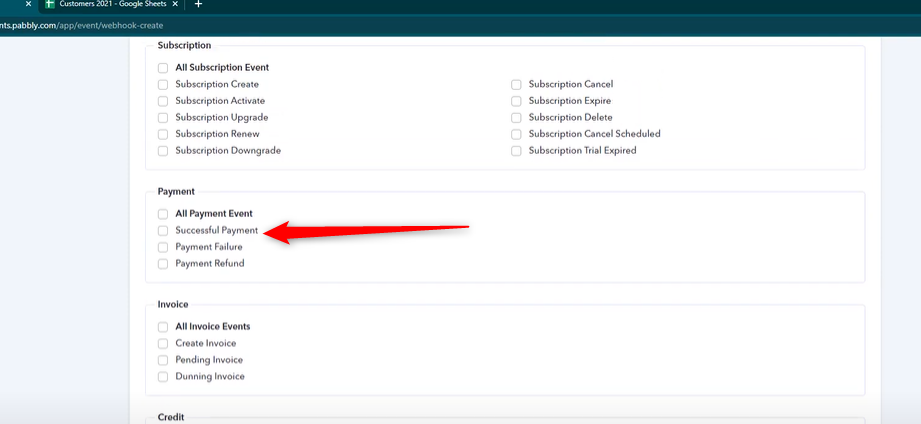

Hey @Vireesh
Now if I want to give the link of the pabbly payment page to all the leads and after the successful payment is made by the user, I want this course enrollment automation to enroll the user in the prescribed course. How will it work?
You can refer to the following video tutorial on how you can accept the payments for the course and assign the course to your respective platform.
youtube.com/watch?v=fURZ_hKBV6s
Also, If you want to use Pabbly Subscriptions trigger an event to capture the payment.
youtube.com/watch?v=7SoLY-qyNYc
