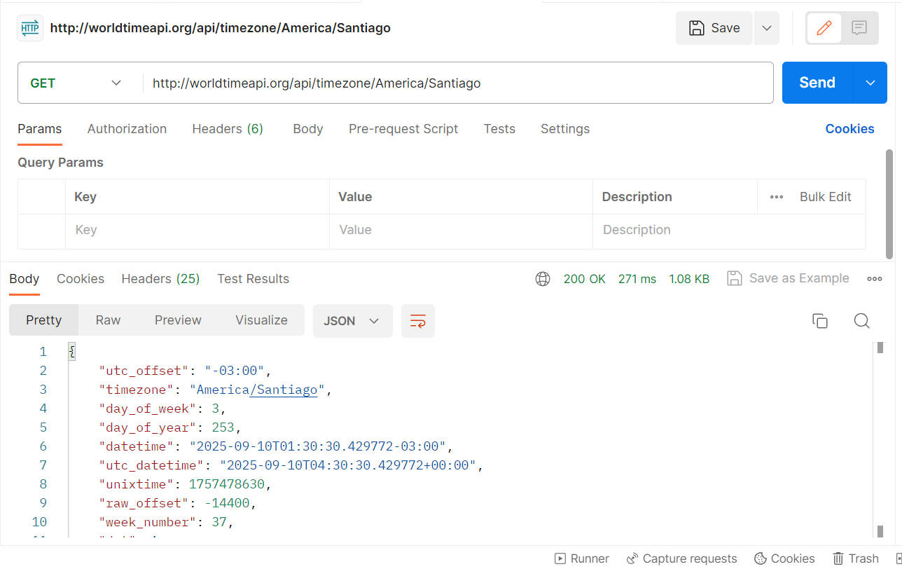

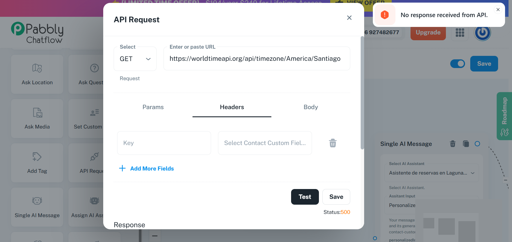

I was trying to implement as suggested but fails on testing the api call. No params, no header, no body.
I used https://worldtimeapi.org/api/timezone/America/Santiago that corresponds to my location but says "No response received from API" as image attached.
If I use Postman the call is working fine as shown.
What can be wrong?

Sergio G — Reply ·
Hi, that is a great idea! thanks.
What can be wrong?
I'm a developer guy so you can be techie
Update: I had to add access-control-allow-origin = *, since I saw that on test button it was called from an intermediary host

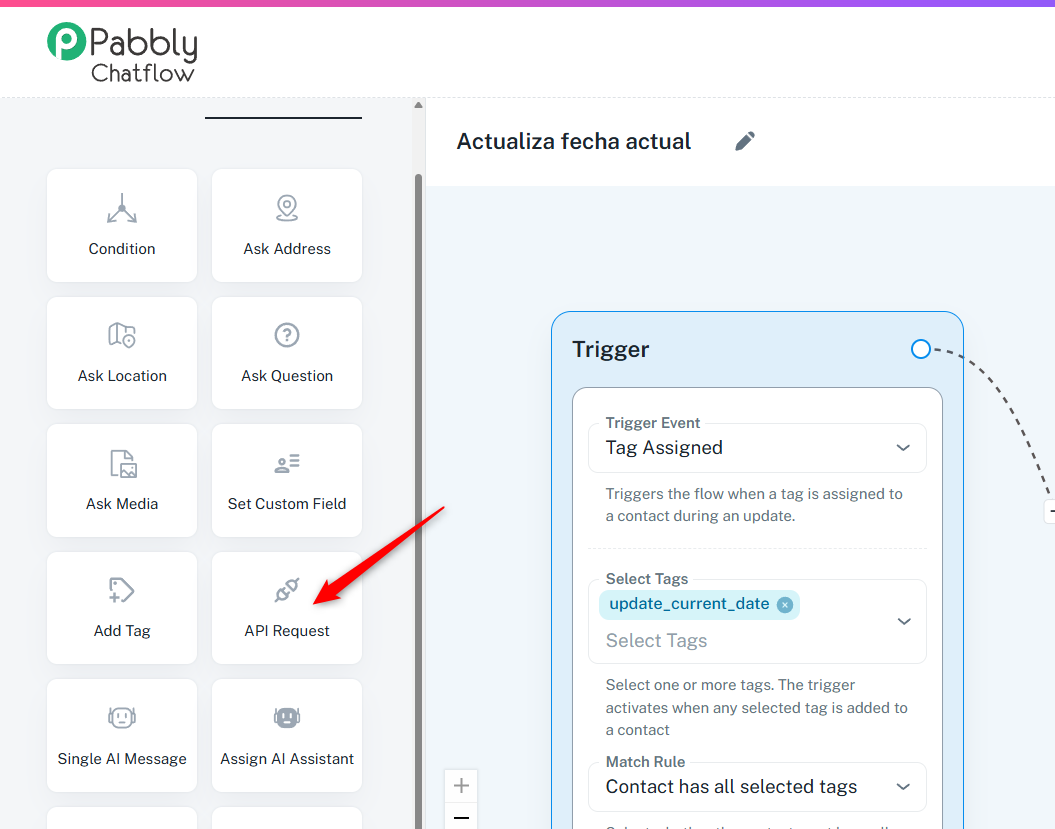

I created a very basic flow for testing.
When a tag is added to a contact then call api request and save the result data.datetime to CurrentDate.
But it's not working, I open Contacts, choose the only contact I have to edit details, add update_currency_date tag and the value in CurrentDate is not updated. Doesn't work either to apply tag, Save, get inside, remove Tag, Save and apply again the tag and save. The value in CurrentDate is not updated
Why can that happen? Is some kind of bug?

Hello @Sergio G,
Hi, sure.
https://chatflow.pabbly.com/app/flows/edit/68bb94c051a665a01e3bb26b
"You have my permission to log into my Pabbly Connect account and edit the workflow, if required. Here is the registered email address associated with it [email hidden]
The World Time API doesn't seem to be working consistently. We suggest trying a different endpoint to fetch the current time more reliably.
Sergio G — Reply ·
Hi, thanks, I changed the api to https://timeapi.io/api/Time/current/zone?timeZone=America/Santiago and now it saves the date to a custom field.
