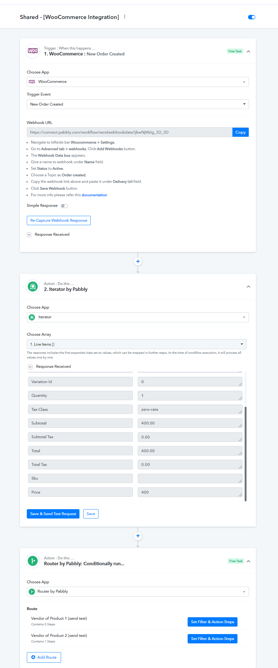

Hey @rohangaurat
You can build all the three use case as given in the following -
You can achieve your use case with the help of the Router Module.
You can refer to our tutorial video of Router Module for better understanding -
Also for more integration tutorial video on WooCommerece, check this out - https://www.youtube.com/channel/UCVA5GKy8qpDxQR5xSt_zcJg/search?query=woocomerece

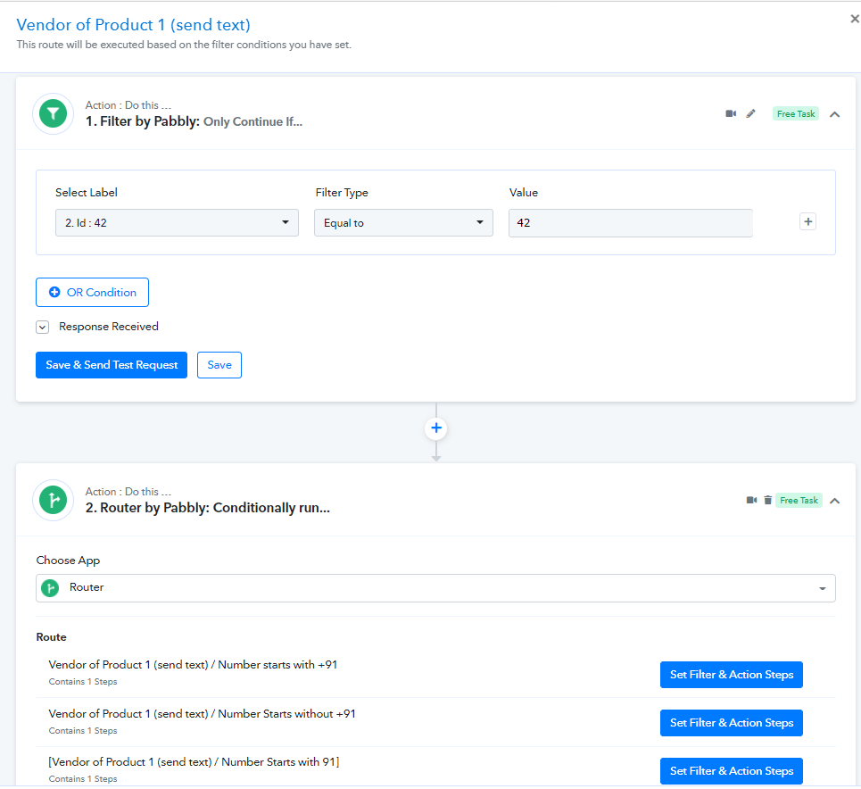

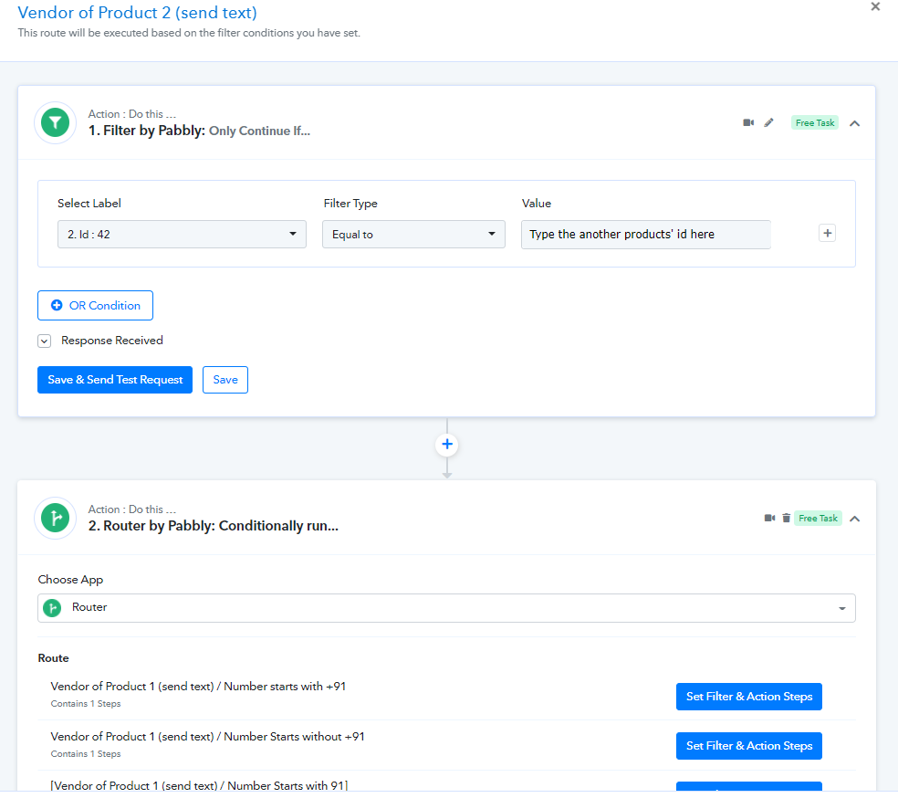

Here is the screenshot of your desired workflow -
Following router -
Where you have set the number of your individual vendor to send the text in each of your routers.
Another router to send the text to our vendor with the phone number condition.
Although we have created a similar workflow where you can send the messages to the vendor with their respective products and sort your concern on the number problem started with +91/91/without any 91/91.
So please refer to the workflow which we have shared here -
https://connect.pabbly.com/workflow/share/AUkDMVE4CS5UHlc9BU4AKgsYBDMEWFFrAREDCgNmUhQ#
And to use the Chat API you need to buy it separately from their platform.
