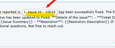

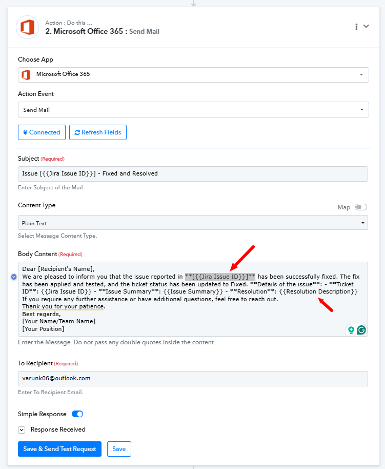

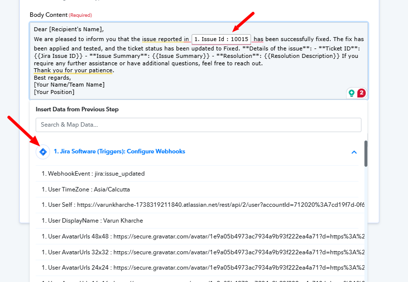

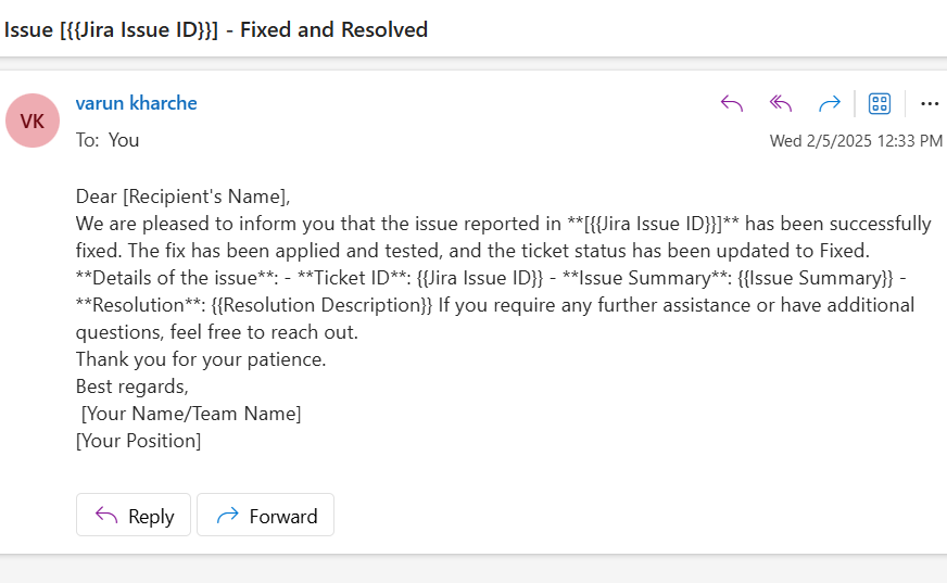

@Preeti Paryani Thanks for sharing me this information but I am not getting jira details in the mail which I have set dynamically .
you can review my workflow for same
Hello @varunk,
The issue occurs because you haven't mapped the responses from the Jira step. Instead, you have manually entered keys. Please refer to the attached images to see how you can correctly map the data instead of using static keys or variables.

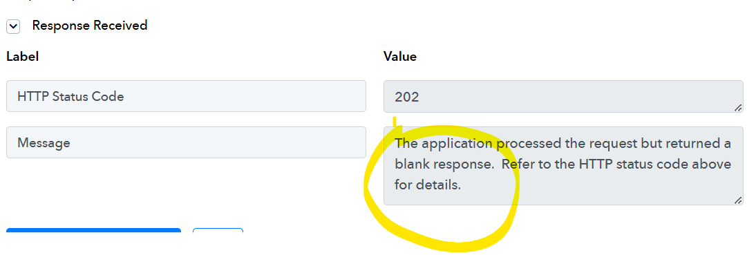

Yeah , it worked but in response getting 204 and this message

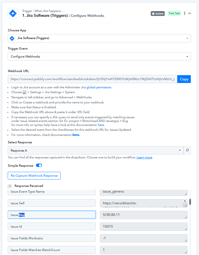

Is there any way to get jira ticket id in mail ?
Hello @varunk,
You are receiving the Jira Issue Key in the trigger response please refer to the attached image for more info.
varunk — Reply ·
Its my sprint name not jira ticket id
Hello @varunk,
Could you please provide us with a reference ticket ID Also, please try using the Get Issue action and let us know if it return the required ID.
varunk — Reply ·
SCRUM-29
