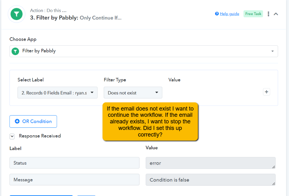

I continue to get duplicates due to Pabbly's webhook firing multiple times, which is causing issues with my lead flow.
I want to create a stop filter where if the email already exists in Airtable, the workflow will stop so that I don't get duplicate entries.
Can you tell me if I've set it up correctly (see attached)?
The workflow name is Formaloo --> Sheets --> Airtable
Yes, the filter action step seems fine, since the current situation of the filter is not true but in real-time execution, your workflow will perform as expected.

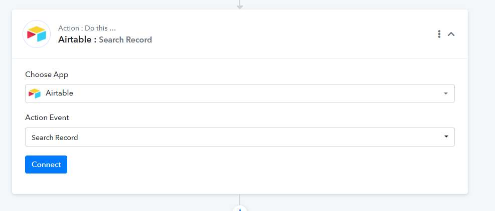

And before that, you need to use the Search Record action step.
