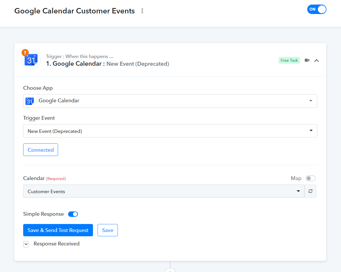

Please guide, this trigger event has been deprecated.
Parth Nayak — Reply ·
did it but not working, it has been working smoothly but stopped. there 3 workflows which were working smoothly and now stopped. This workflow name is

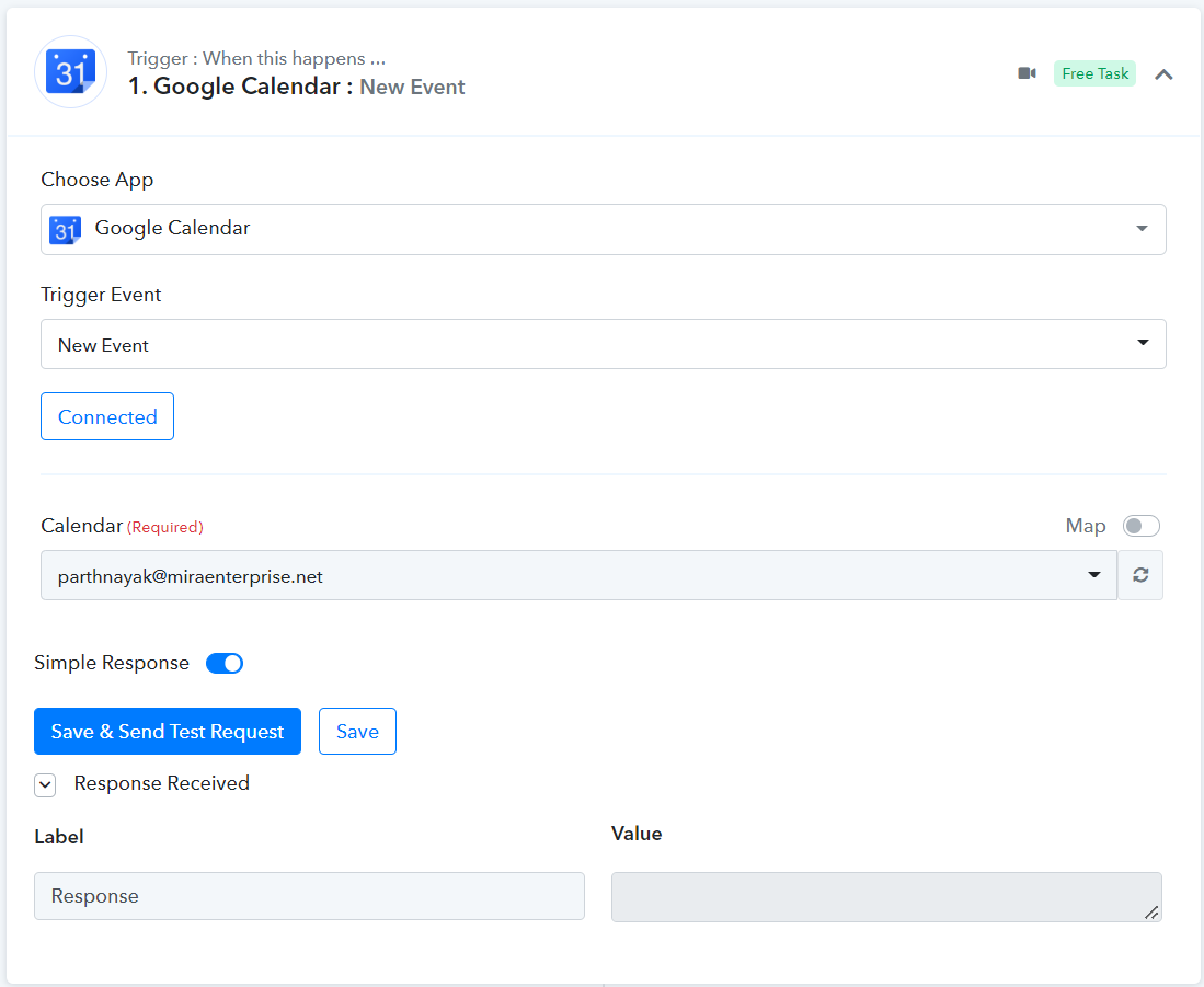

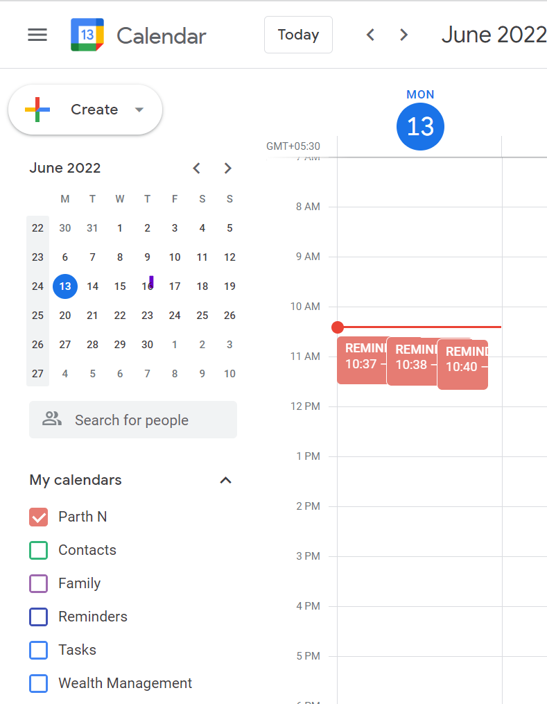

Now error on Google Calendar automatically disappeared, also i have added 3 reminders in my calendars but Workflow is not capturing any response so unable to check/test further.

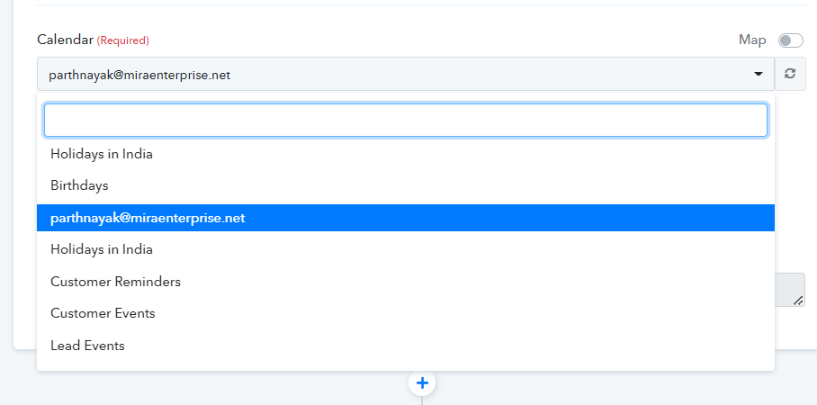

Hey @Parth
Kindly cross-check your Google Calendar account which has your Parth N calendar once and tries again. Seems like you haven't connected the respective Google account which has that Calendar.
