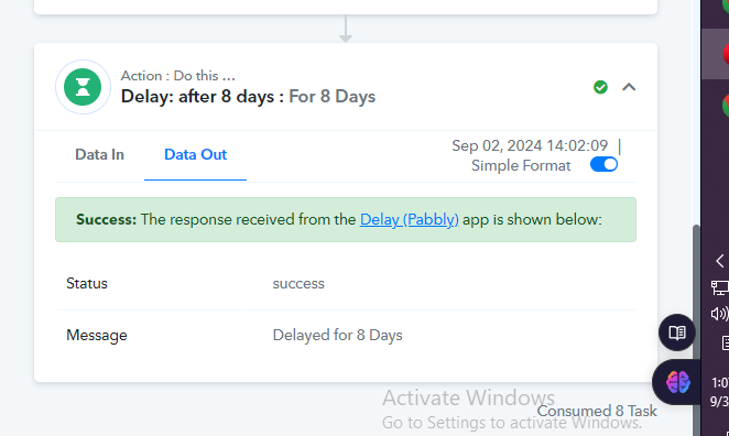

My workflow is running the delay step for new 8 days. But now, I do not want to it run further in the middle of that workflow run. How can I setp being the workflow rund after the 8 days delay

Use case: I have made a mistake in my workflow. And I have already made the mistake of sending multiple emails to customers. Now, after the delay (8 days), there are more emails that will be sent, which will be a failure of automation for me. I want to stop the automation immediately. But I do not see the ways to do it.
I have basically not tested the automation. It is the first automation run, and I am doing the test with actual business customers. I do not want to send more emails to my customers.

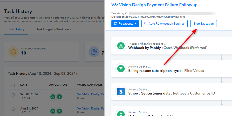

Hello @shahidul islam pranto
You can stop the execution of the concerned workflows by clicking on the task history and then click on the Stop Execution button as shown in the image attached.
Hope this helps.

It’s not possible to stop the execution of a task through an external request or automation. It can only be stopped via the Task History.
