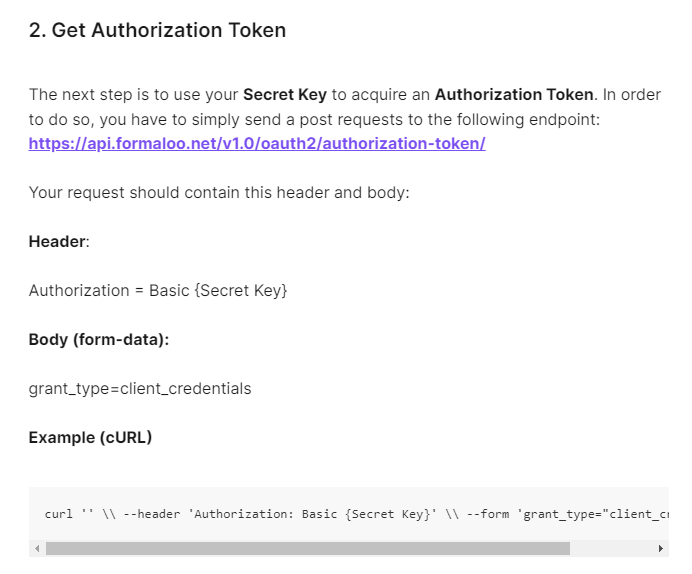

As you read, I need to generate an Authorization Token from a secret key.

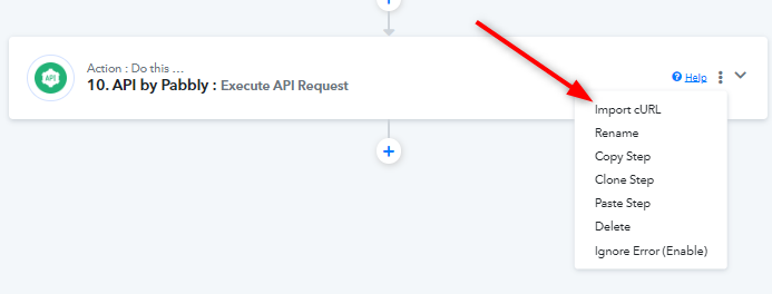

Instead of manually adding all the headers and parameters, you can directly import the cURL request using "Import cURL" feature in API by Pabbly. You can find it within the three dots menu as mentioned in the image below,
Kindly make sure you provide the authentication details as mentioned in their API doc.

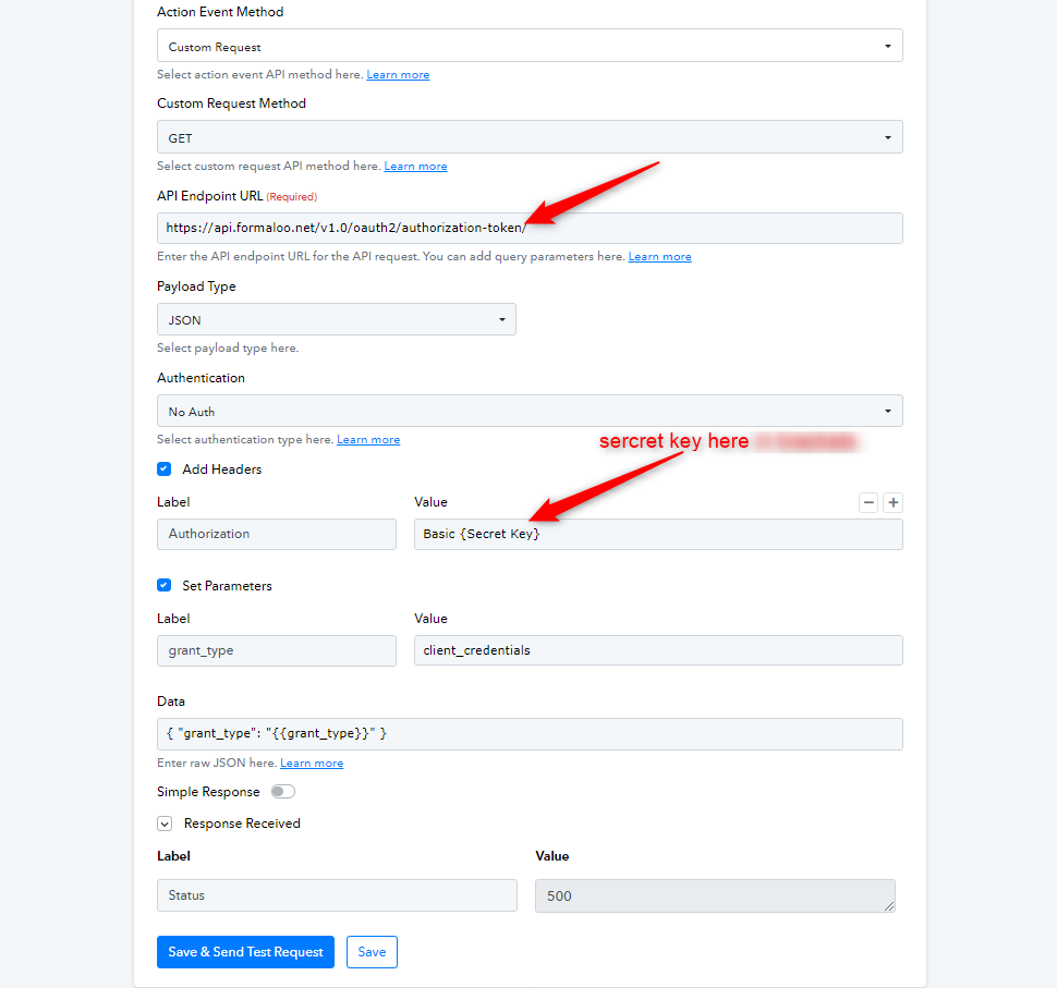

Hey @Ori D
Kindly refer to the image below and set up your API request accordingly. You need to enter your secret key in here to get the authorization token. Then you can execute the first name request, because it requires an authorization token.
Ori D — Reply ·
Thank you very much!
