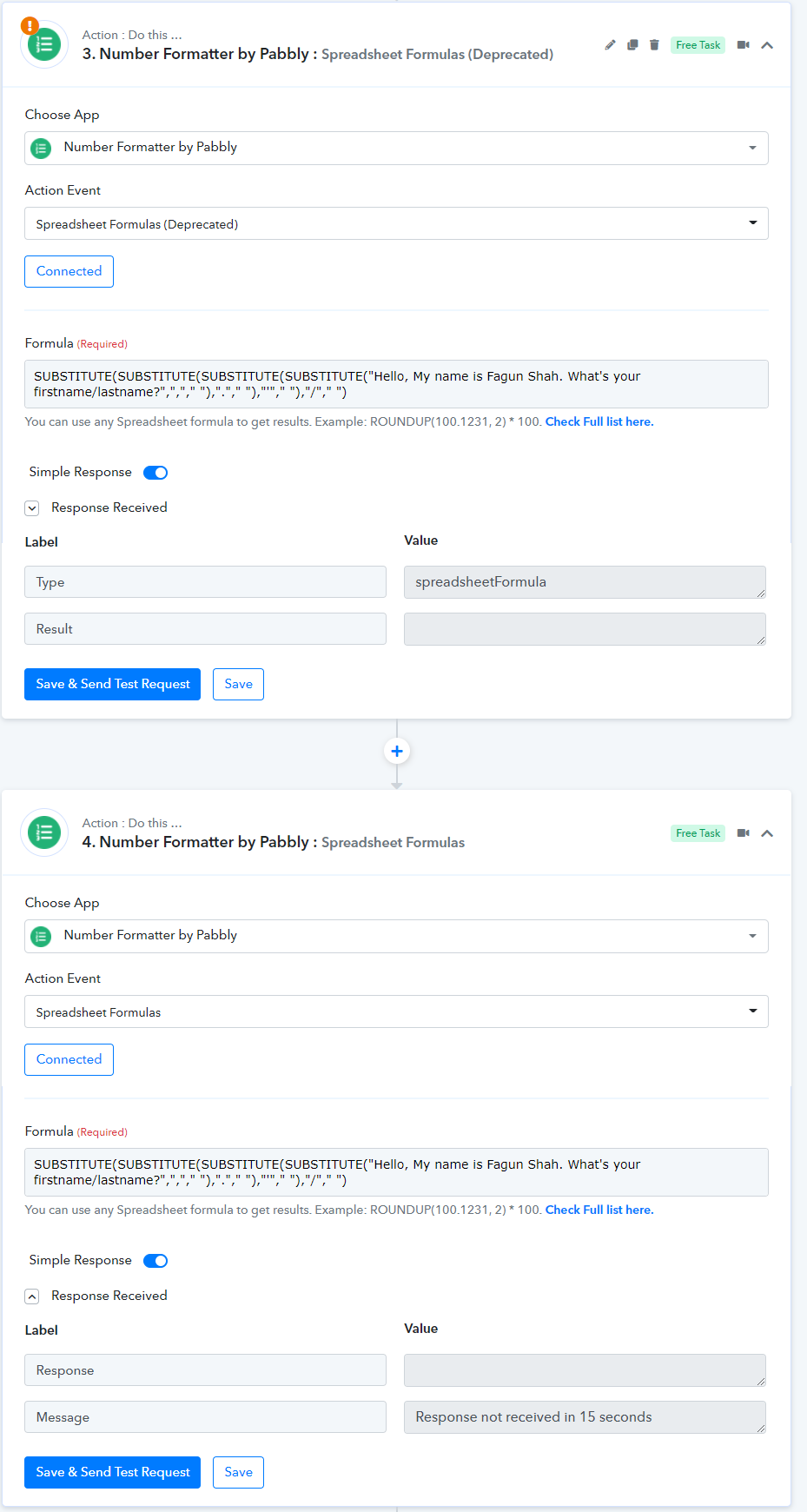

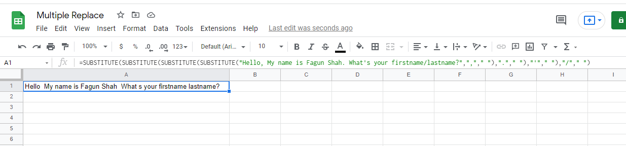

Actually it should be possible using SUBSTITUTE formula in Number Formatter -> Spreadsheet Formula. But it is buggy in pabbly connect. They need to make it proper. here is the example in gsheet which works proper.
And here are results in Pabbly Connect's New and Old Number formatter(both are not working properly) -
